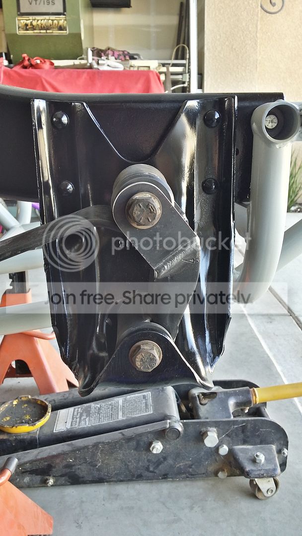

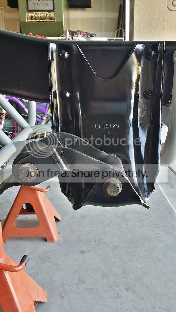

They are Deavers. They are a stock height pack. Jeff at Deaver said I will have 4" up travel and to limit it at 12" total. Goofing off today with the travel I could probably get 16ish, but I will strap it at 12"
All of the 57s I have ever had are pretty flat and I have always had to add leaves to the pack to get what I needed out of them. I don't think they would work on this.
How to rework stock shackles.
1. Bolt stock shackle to table.
2. Draw a doodle on the table of what you want to take dimensions off of. In this case, relocate the hole 1" up and 1" forward.
3. Figure out a super precision, repeatable setup to cut the shackles :saweet:
4. Make a jig doohickey to hold stuff in place and ensure they both come out the same.
5. Weld and enjoy :pimp:

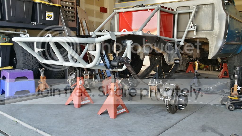

Full bump to sitting on the floor is 12".
The shackles will get boxed before it goes back together for good.

This mornings project is to get the truck up high enough to get a jack under the diff. at full droop :D

The axle at bump height.
I think I have a bump stop setup figured out.
Gonna head to Trail Gear tomorrow after work to get limit strap hardware. Get the strap attachments mounted and then measure for straps :woot:
