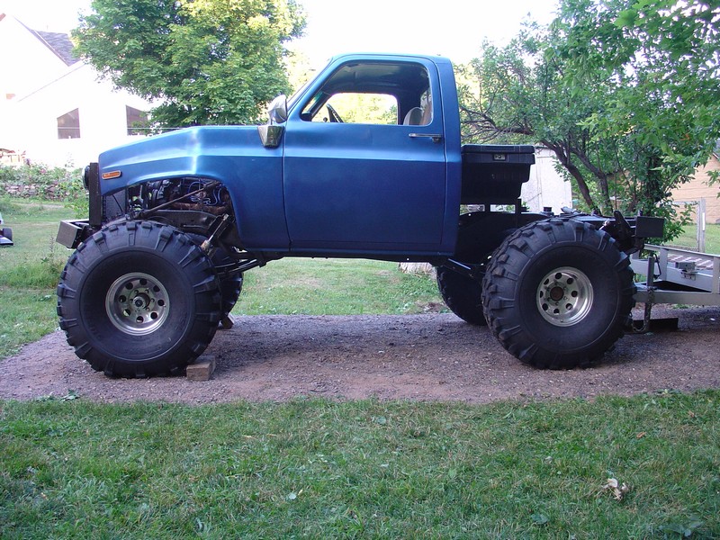

44" TSL on 12 bolt H1's with 52" fronts and 64" rears.
I saw that someone had asked how far they could move the axle foreward before problems so I thought I'd chime in on that. I moved my axle foreward with the 52's (2" roughly) and then added a zero rate in the 1.5" foreward position and I hit my spring pad on the drag link end. I backed off to the center position and things are all better now excpet my tires rub the floor a little. :doah:

Nice lookin truck cybersniper :waytogo: Got a link so I can see some more pics? I like what you did with the front fenders
The one in my signature should work now. I don't have much in the way of pictures after hurricane Katrina taking out my website a while back.
The front axle is moved 4.5" forward, the cab is moved 3" back, and the engine is moved 2.5" back. Things look a little disproportionate that way.
The front fenders looked a lot nicer the first time I welded them up but after getting beat on and twisted they had to be rewelded and I didn't do nearly as nice of a job with the bodywork. But they were my "trial run" fenders anyway since they're full of body filler due to rust. If I decide to stick with the fullsize theme I'll probably make new fenders that aren't quite so swiss cheese.
The truck was originally painted with Durabak Smooth Blue with UV. It looked like **** after the first two months. Biggest waste of $220 in my life. It's since been painted with Rustoleum Metallic Blue.
