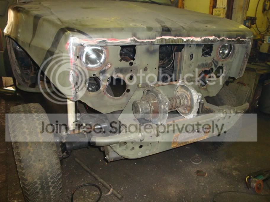

Making some changes to the front clip.

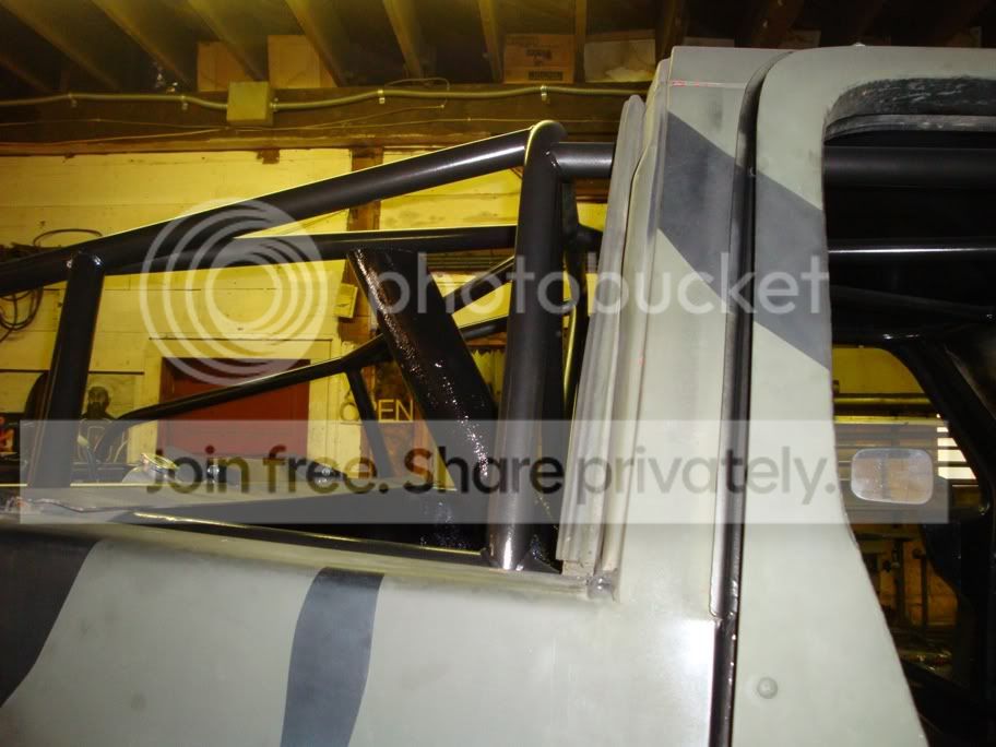

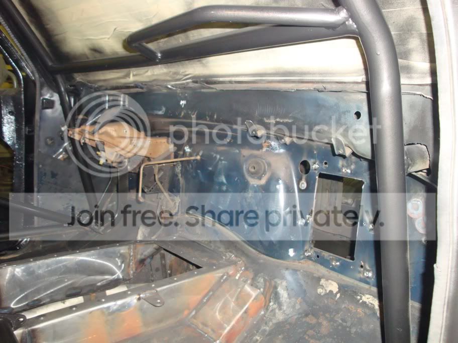

New tunnel or dog house fabricated. Some changes to the roll cage tubing and a repaint. Prepped for roll on liner.

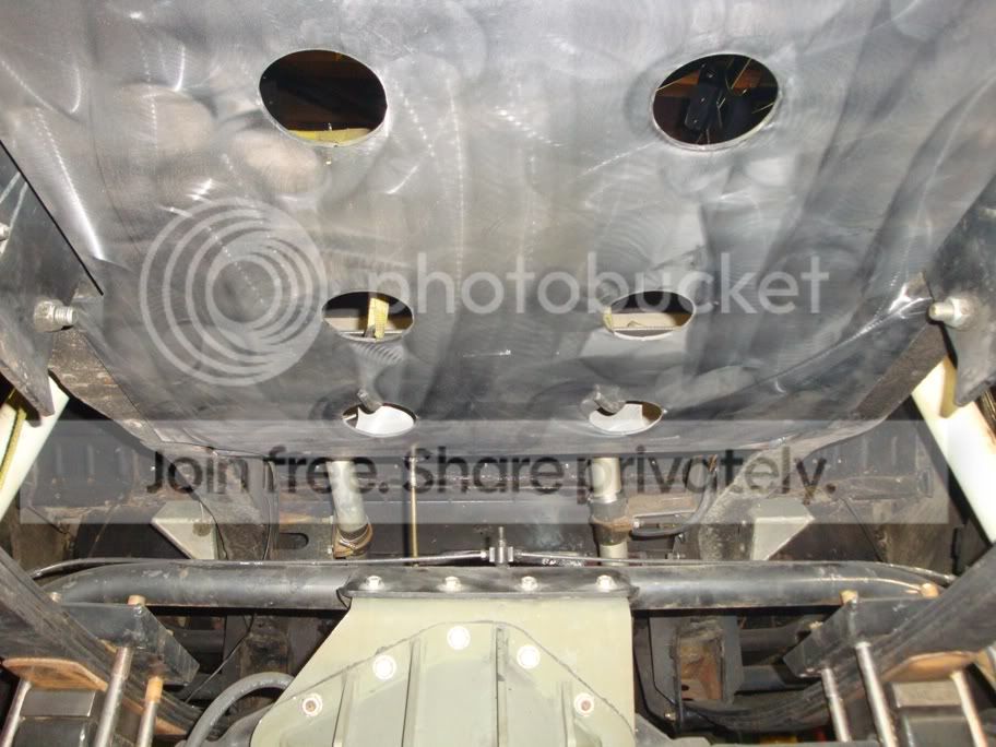

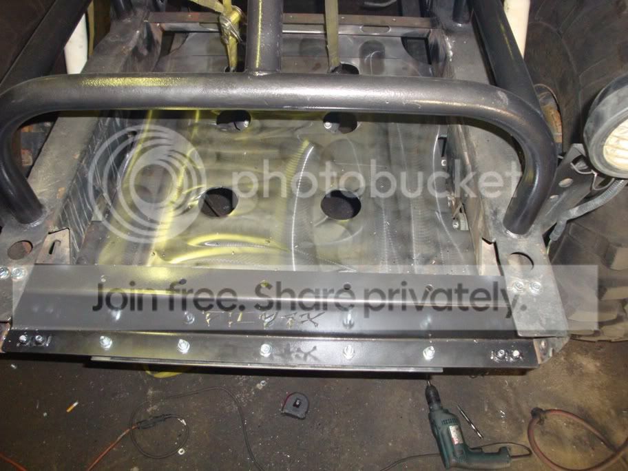

An underside shot of the Fuel tank skid plate. 7ga. steel. Maybe a bit overkill but it was in the table this morning.
Top side shot. Still needs to be welded on the 2 frame sides and across the front crossmember. Tomorrow evening, I'll finish that up. Got tired of the heat today.

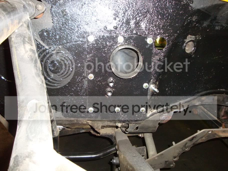

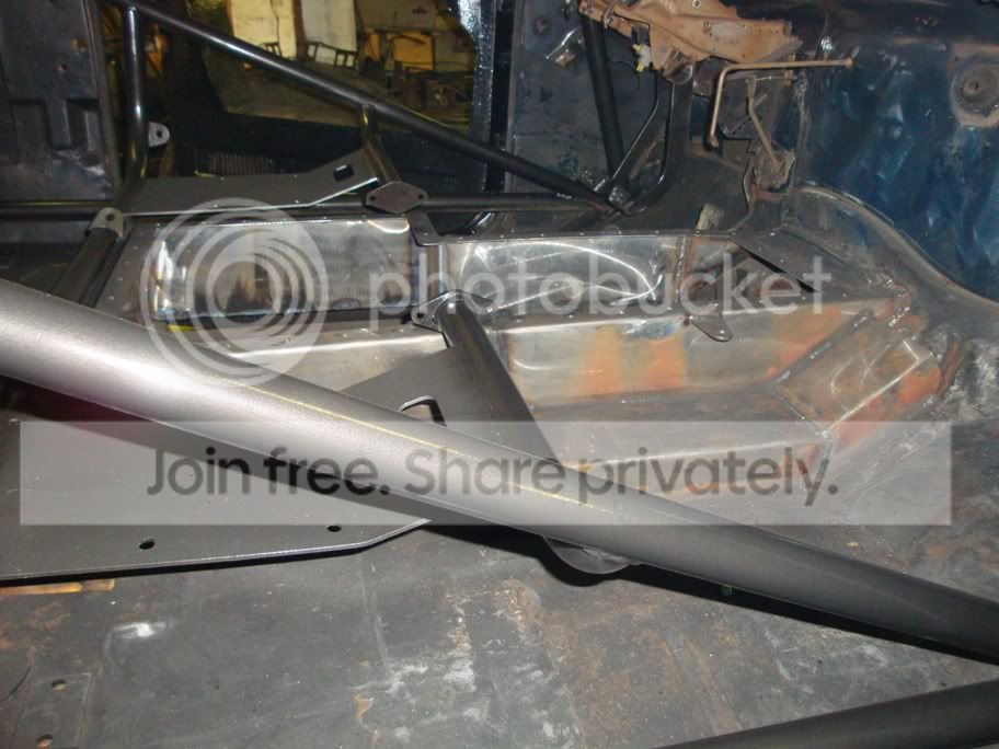

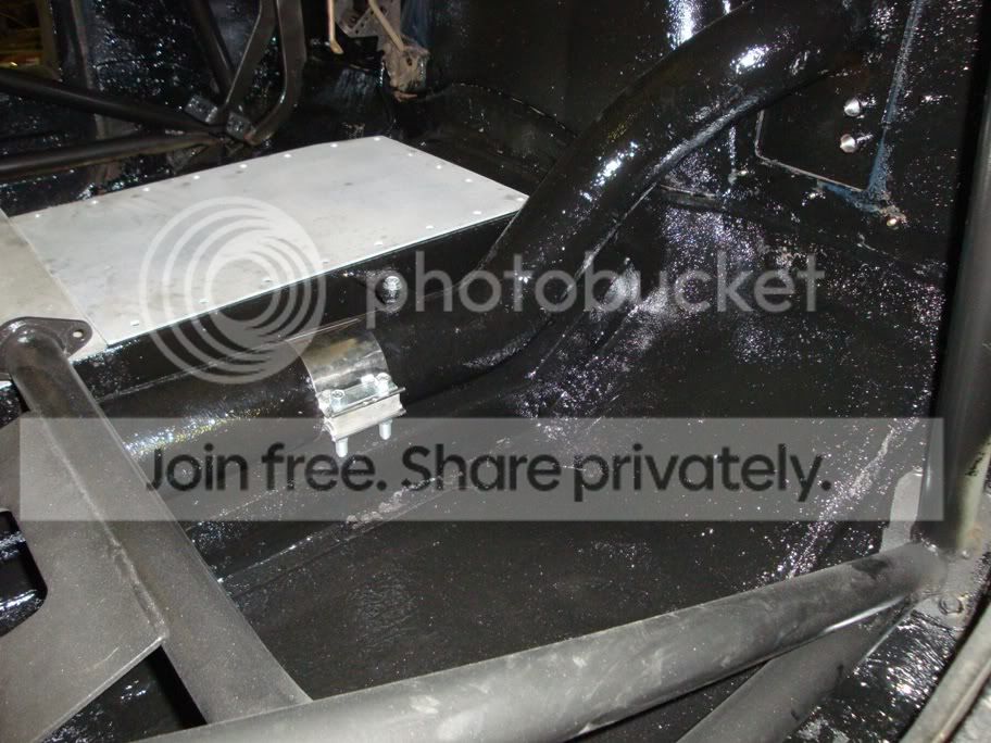

Air intake tube. It runs from the engine bay through the fire wall, the plate you see welded on is the fire wall mounting flange. Lays on the left side of the passenger foot well and goes on out the back of the cab up to the top of the cage but still inside.
Lined the interior this evening and finished the fuel tank skid plate.

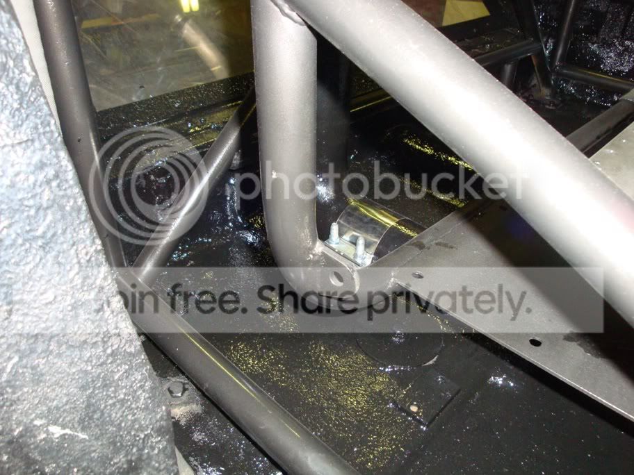

Some shots of the first coat of bed liner stuff and the air intake tube routing.

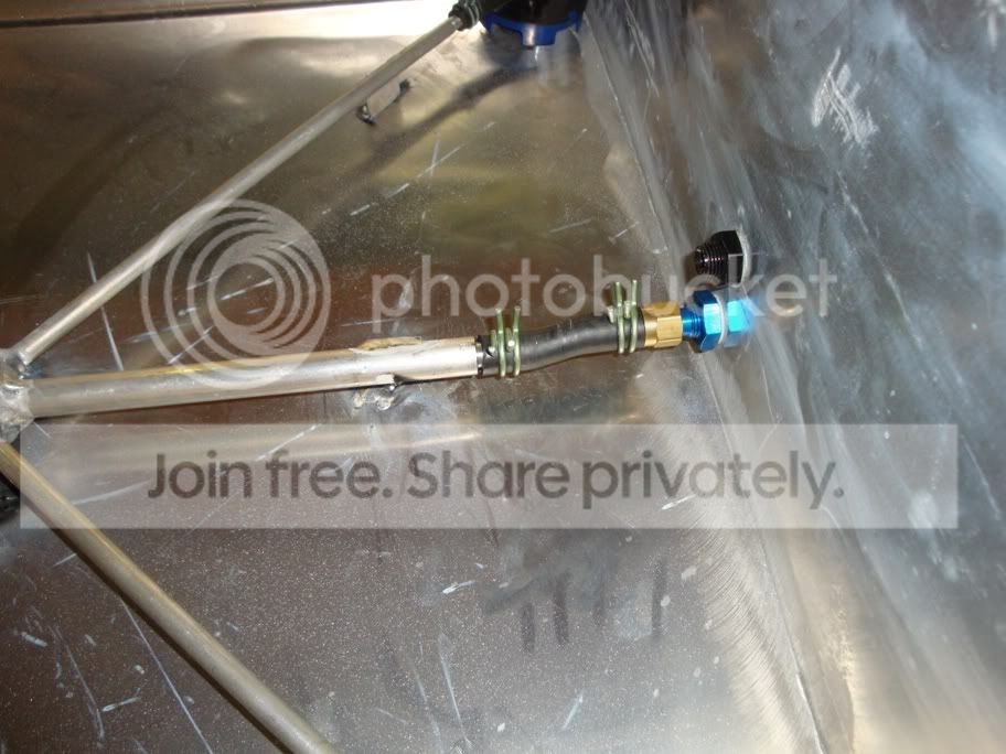

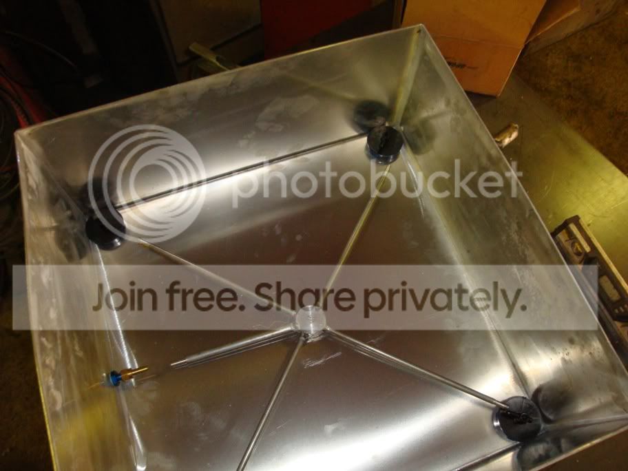

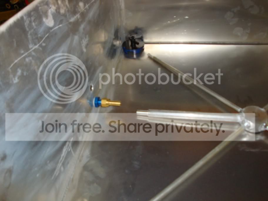

Last shots from inside the tank. Hope to have the tank sealed and installed this evening. Rear bumper back on and ready to do some plumbing.

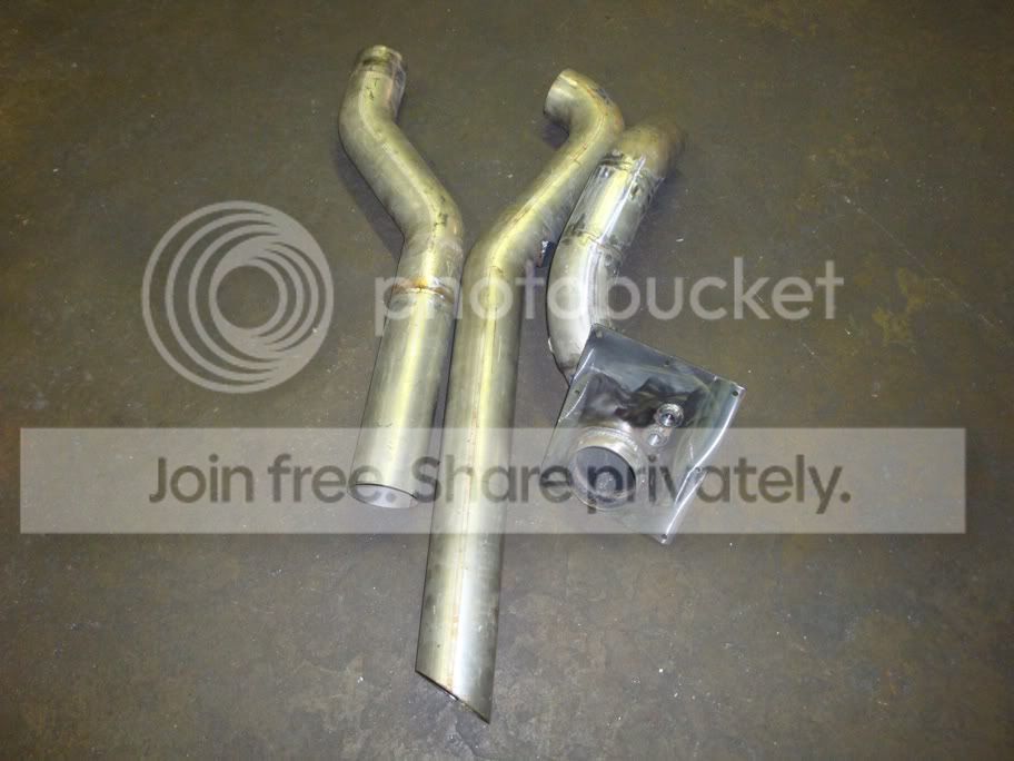

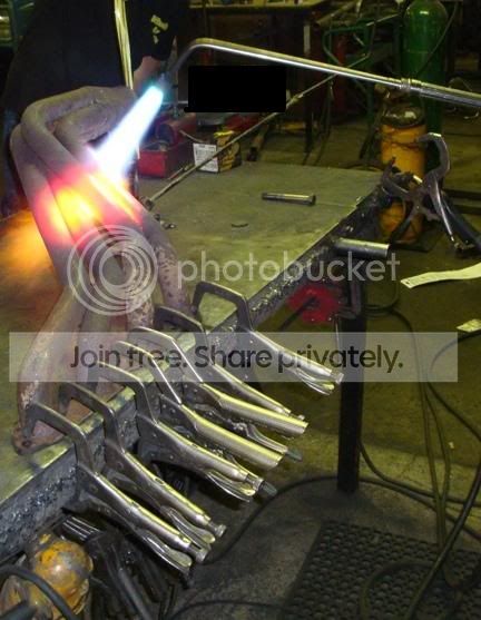

And a header for Mikey's rig. It had to move a couple inches so we put a little heat too it. Hard to see from the photo but there is a bottle jack under the collector for applying pressure the direction we needed it to move.
