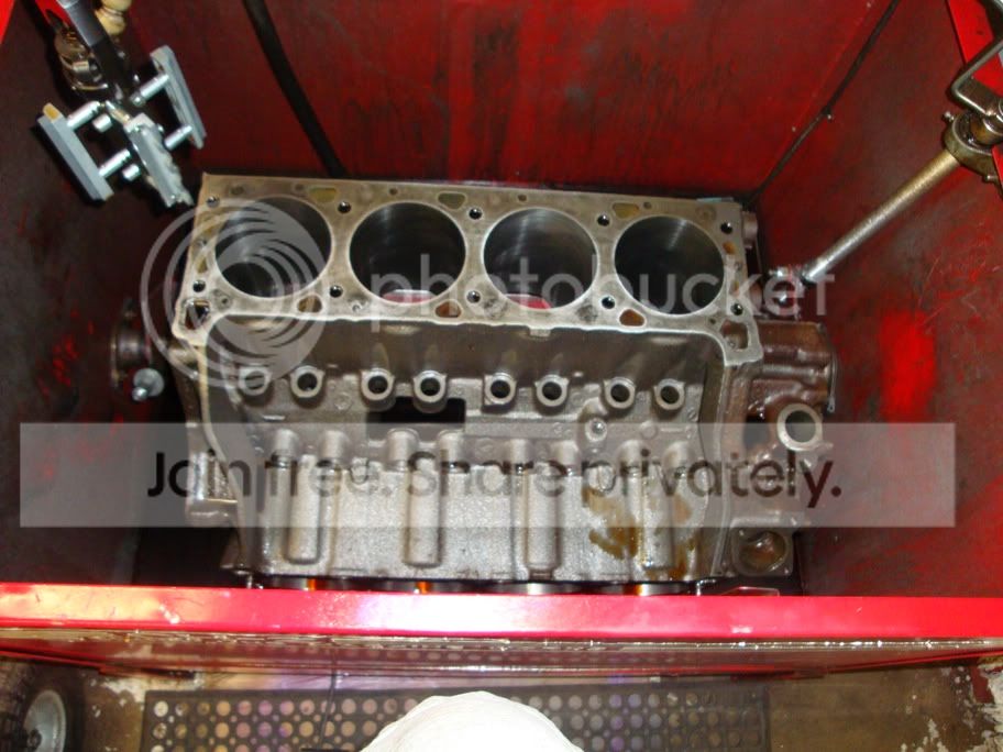

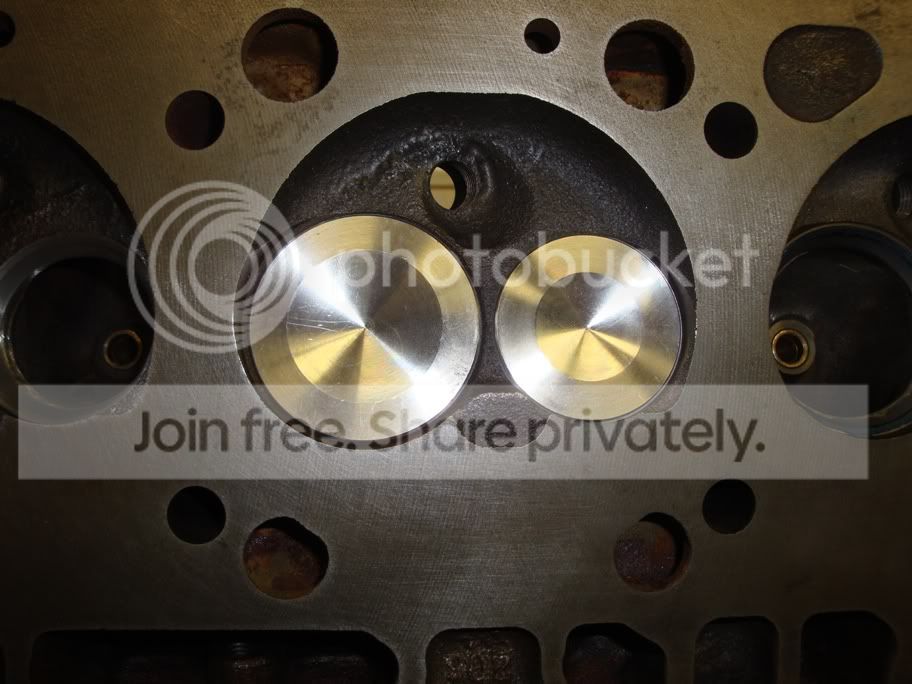

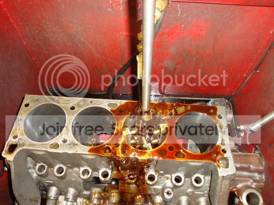

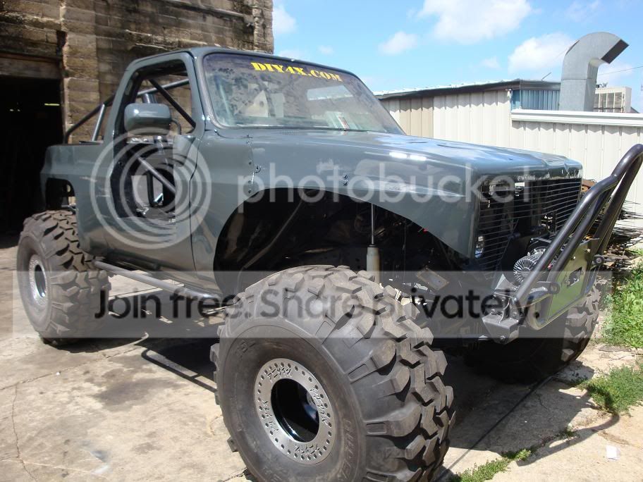

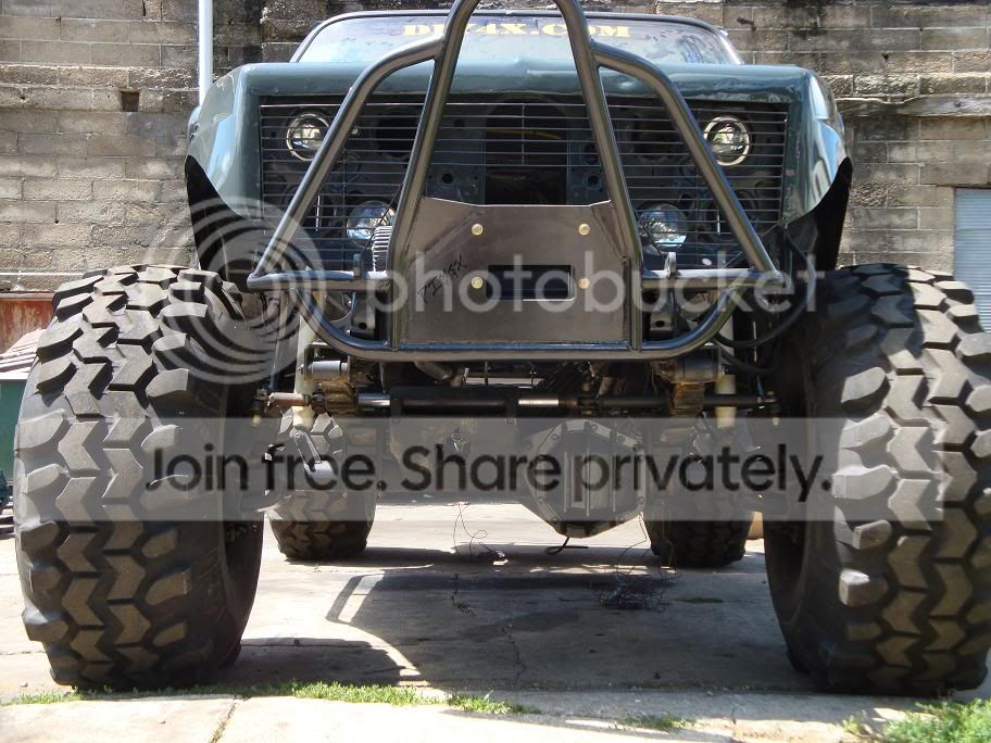

Blazer is really done. Last pictures while she is still mine.
Some more pictures,

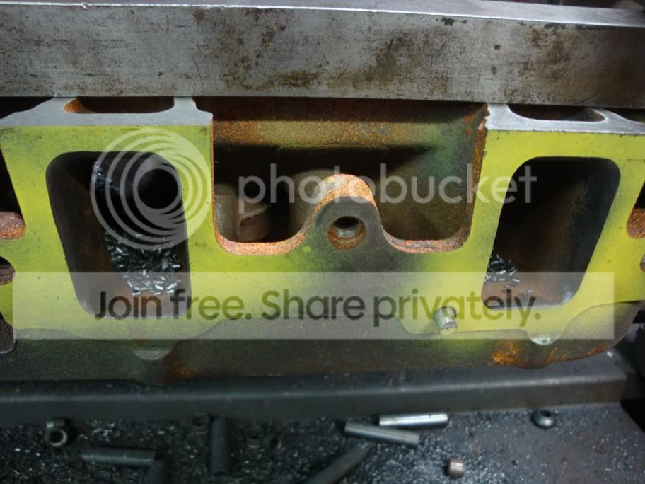

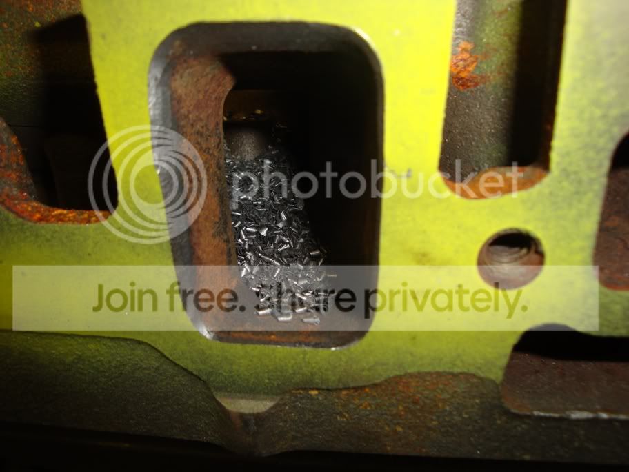

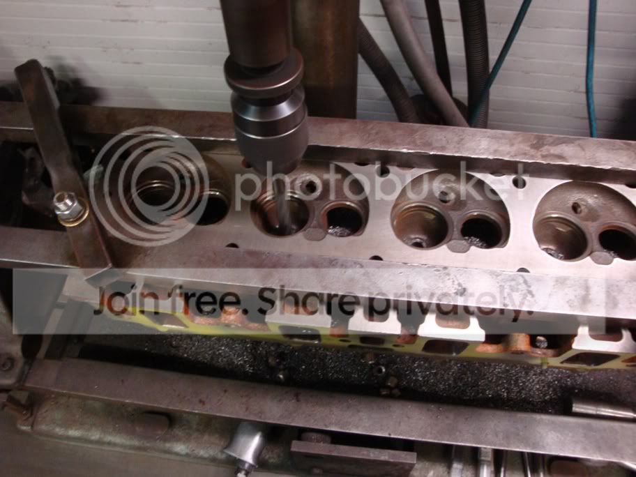

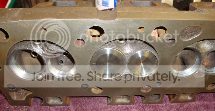

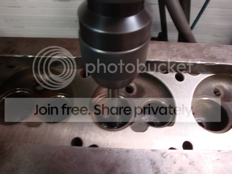

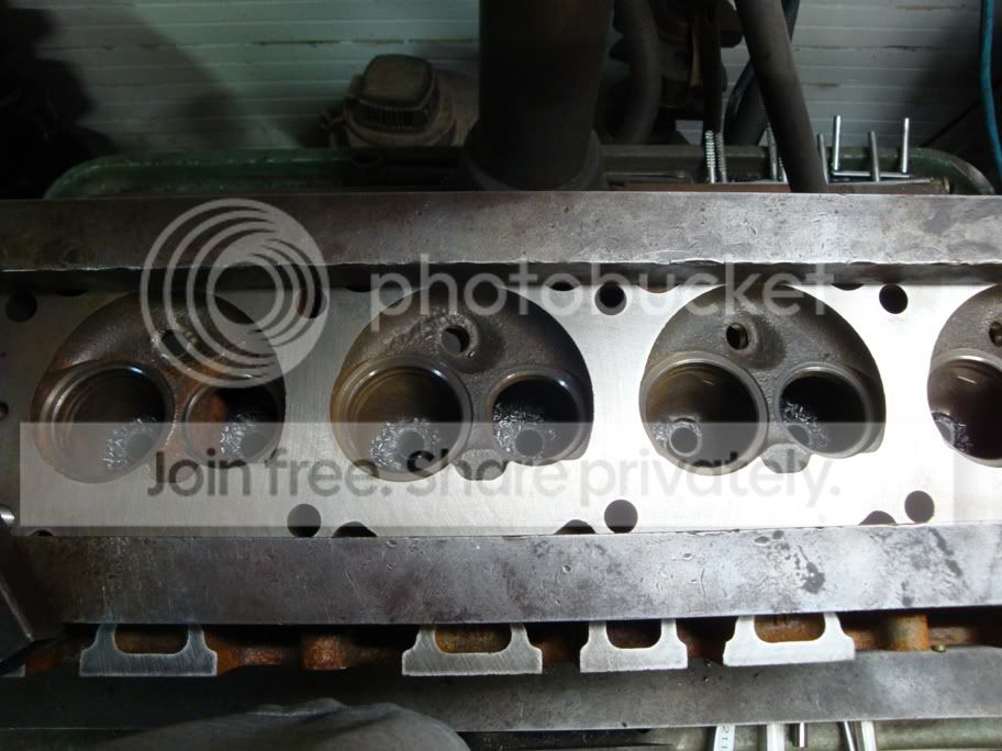

hmmm what a coincidence i just tested off on cylinder head seat rings steel guilds cutting the seat rings milling the head mounting surface and porting and polishing the head un school today, i got a 100 percent haha

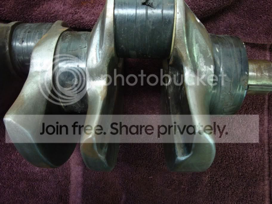

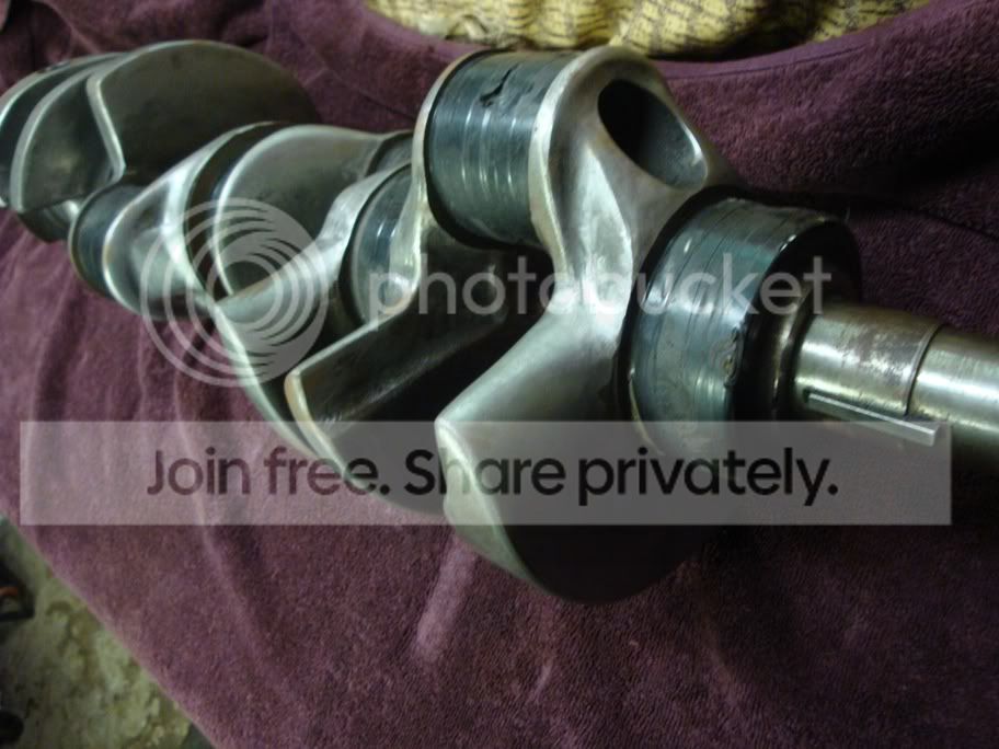

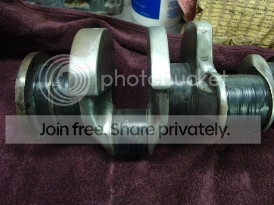

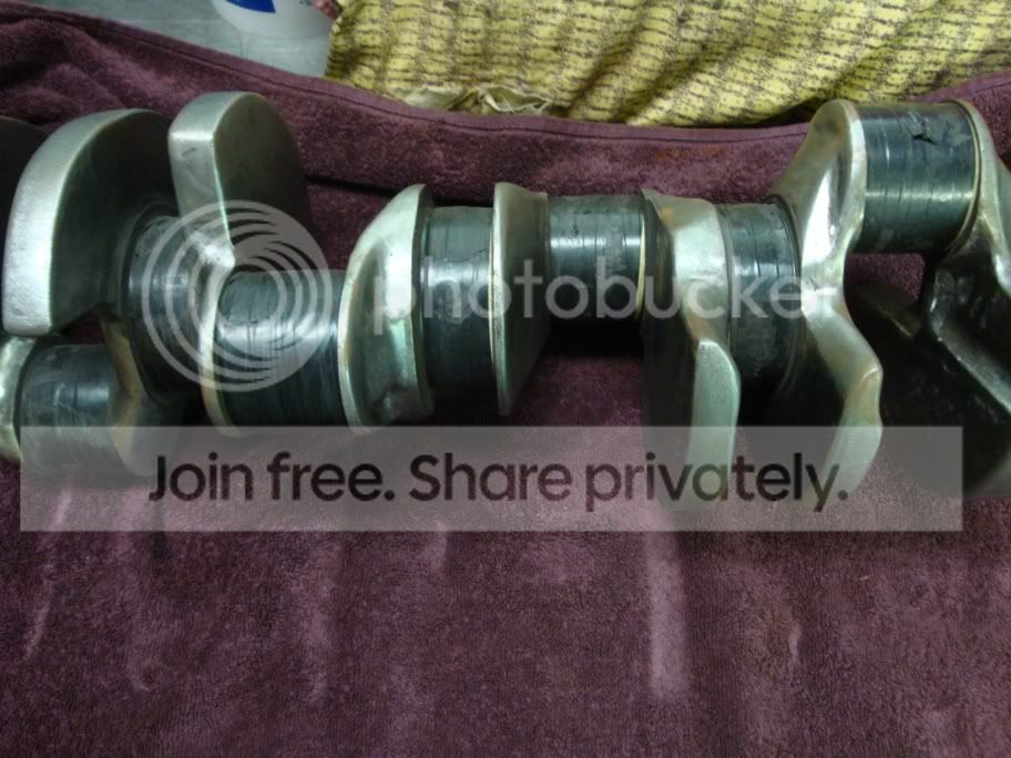

The rotating assembly ended up balancing to within 6/10's of a gram. To put that into perspective, a Dime weighs in at over 2 grams. A check blank weighs in at 1.08 grams.
I wish I had an actual assembled weight of the entire rotating assembly.

i like those electrical tape main and rod bearings. are those a new fangled racing idea? nascar inspired? :D
badass truck btw.

Well the stock crank weighs in about 72 pounds. Add about 25 pounds for rods and pistons. By the time your done the rotating assembly will be about 110~120 pounds.
When I was looking at doing a stroker 472 with alum rods I figured I'd lose about 12 pounds from stock from the rotating assembly. The stock piston/rod combo is damn heavy.:wink1:

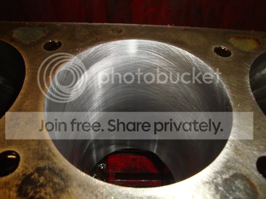

Wow, I was way underestimating the weight. I don't think my grinding and knife edging took much weight off really.
