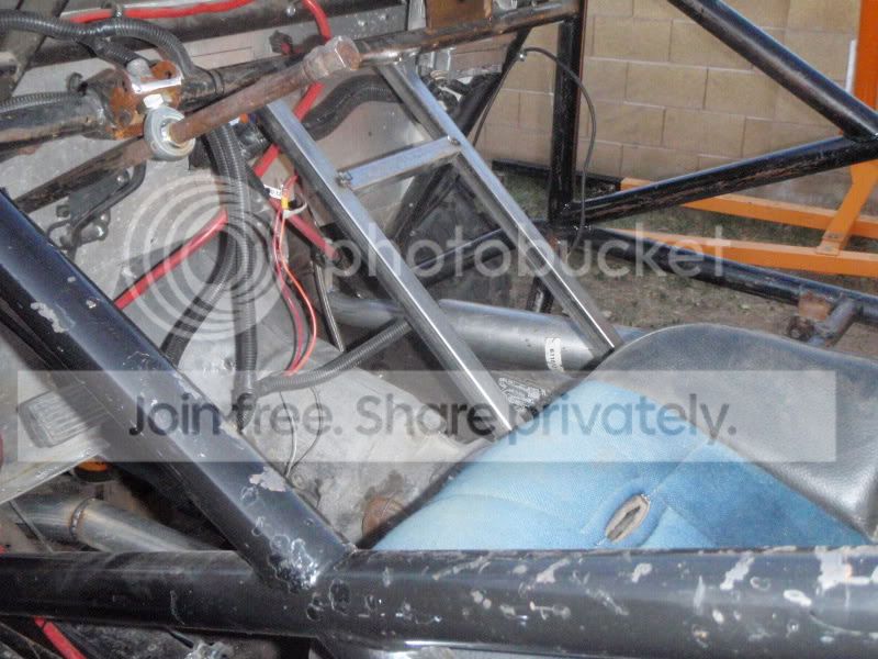

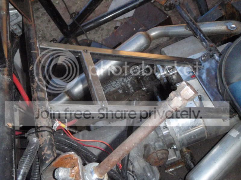

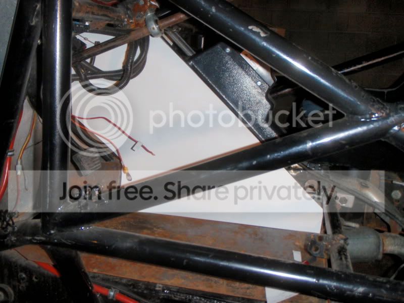

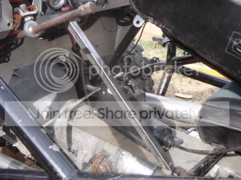

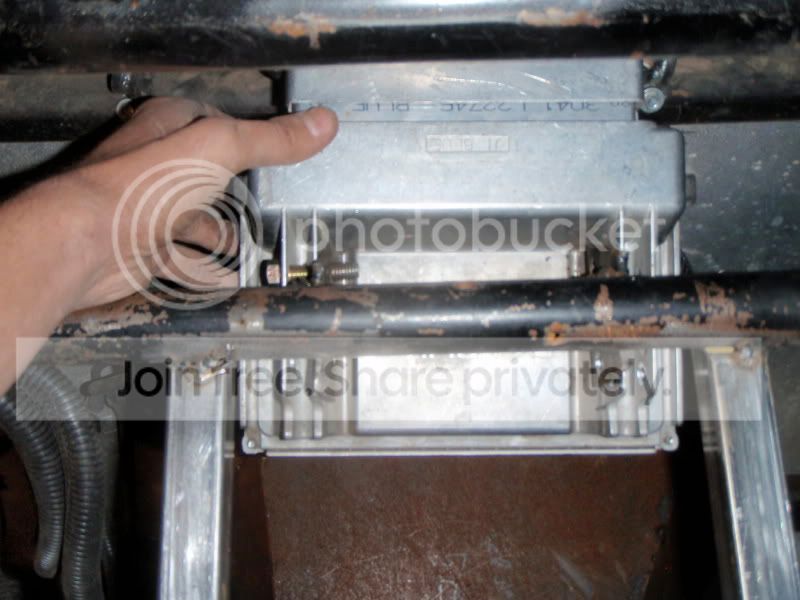

the console and floors have been getting attention, the console will hold the art car shifter, twin sticks and the high and low range atlas shifters. The computer ecm is behind the console/dash. I just drilled four 3/8 holes in the fins and made some tabs. The sides on the console are now going to hold some storage with a hinged door that opens. The storage area is about 3 cubic feet and I plan to make water tight to hold some spare clothes, camera, keys etc. One for me and one for the passenger.
drivers side floor and panel under the console is welded in, the passenger floor however is removable and allows easy access to the atlas shifters, linkages and bolts.
still chuggin along!

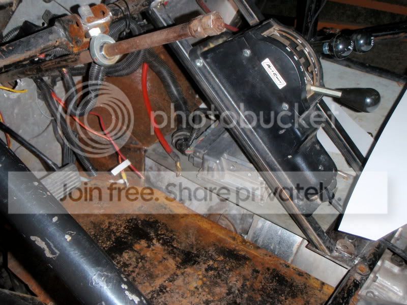

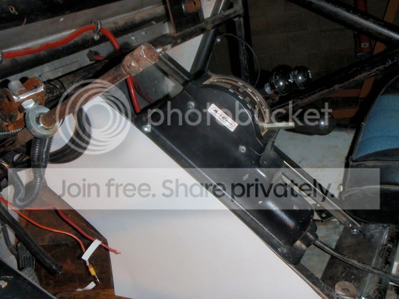

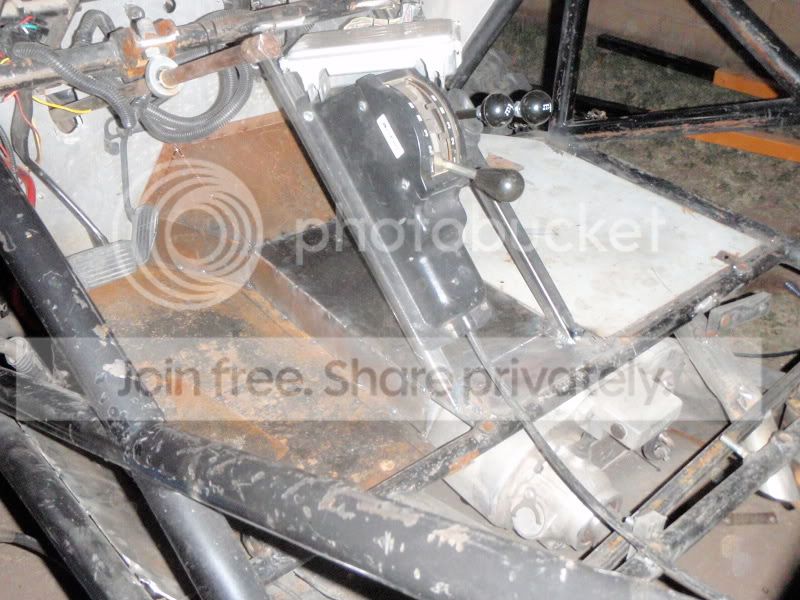

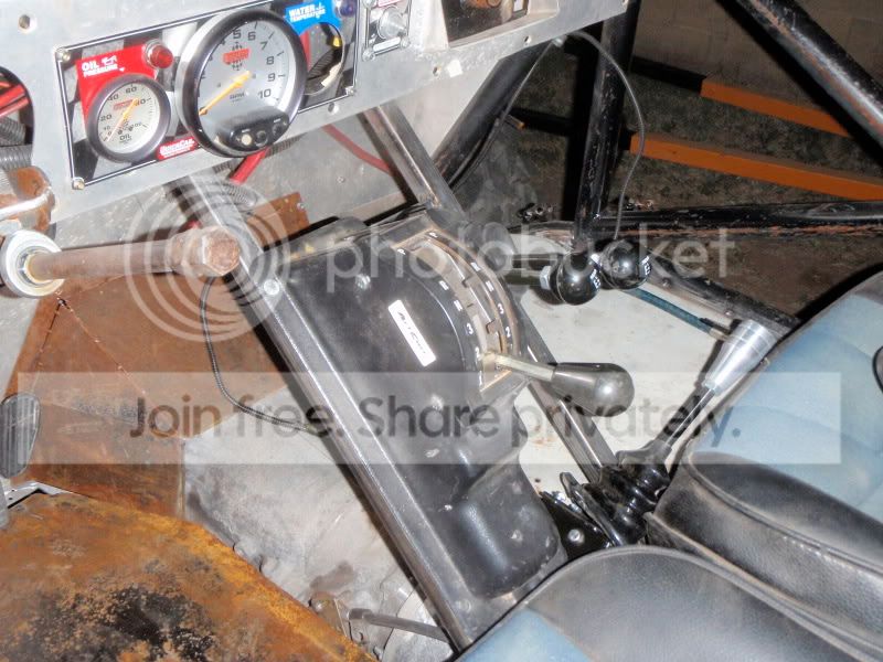

I like where you're going but wouldn't it be a lot more comfortable to shift if it wasn't at such a steep angle? When it's all the way down in first it looks like you'll have to grab the top of the shifter instead of push it up if it was flat.
Maybe it's no big deal but since you're building it all from scratch might as well make it comfy :)
Atlas4 = 3 shifters.....
These pics leave me feeling cheated. :wink1:
:usaflag:
Hard to say why but I love it where it is, feels just about perfect. I still have to final mount it but i have options left for the angle since you can take the shifter out of the plastic case and flush mount it. Im going to try it where its at and if I find it a bother I just make a small angled base that the shifter recesses into..so not real changes needed to the dash/console itself.
Feels like an arcade game:D
I had my art carr pretty much flat and I liked it but never tried more vertical. All the race trucks that come race at our track have their art carrs like yours too.

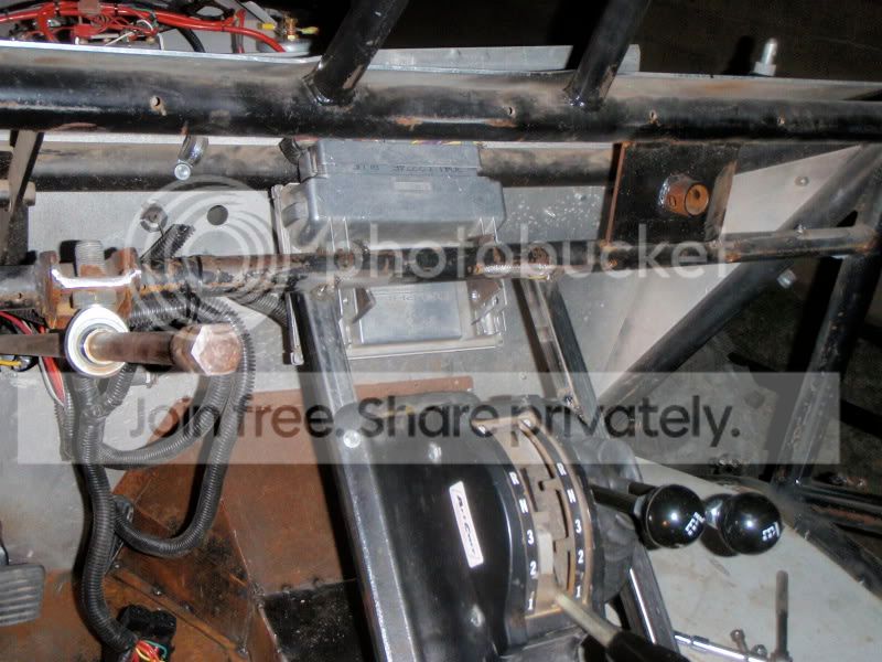

Shifter 1 = Front Diff
Shifter 2 = Rear Diff
Shifter 3 = Planetary Box (not pictured)
Where's it going...? You know the one with the shiny machined shift knob that says "4-speed" on it??? :deal:

she is still a bit floppy but here is the general position . Or I may squeeze it between the seats.
