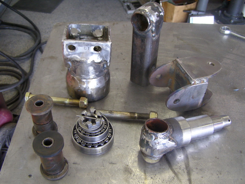

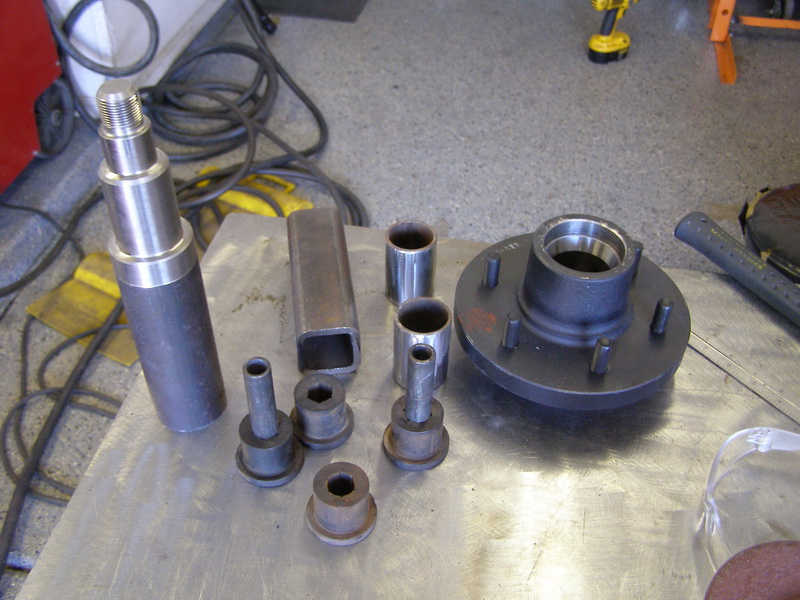

It's a custom 3 axis hitch I made for my other trailer. It uses a couple poly bushings for 2 axis and a trailer hub/spindle for the 3rd.
