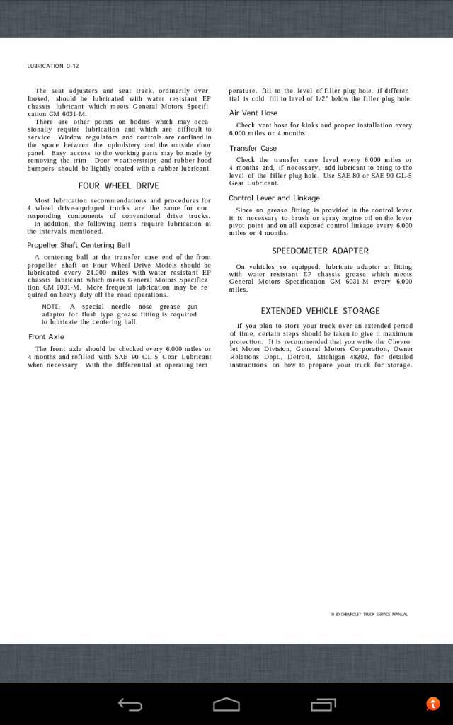

Can anyone prove GM used ATF in an NP205?
yep drained it from my 40k mile original k30 205 tcase .
and its been shown as spec in the service books .
I am aware of that. I want a picture or a link to prove it to someone else.

In the 1972 truck service manual it says sae 80 or 90 gl-5 gear lubricant.
Do you need it to say np205 specifically? Or knowing that it was one of the tcases offered that year enough?
eh...my old 1975 manual says SAE 80, SAE 90 GL-5 gear lubricant
