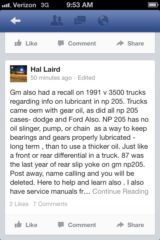

Can anyone prove GM used ATF in an NP205?
Here you go, straight out of a '91 factory service manual -
It's pretty funny. He just keeps deleting everything I say. Here is the page if you're bored.
