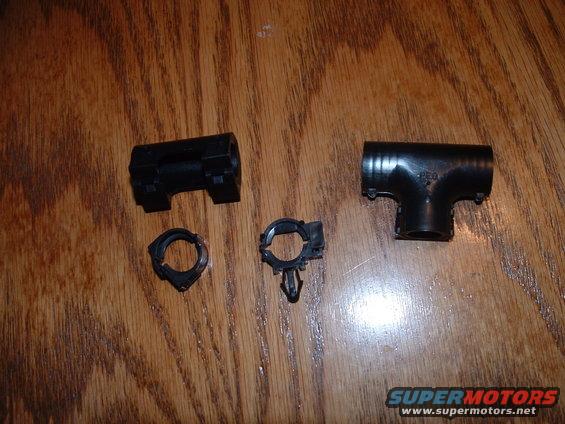

I also bought 100' of .500" wire loom (sorry no pic :haha: )
but have pics of the accessories I bought for it...
T-Connector, end pieces, part that connects the loom to fenders or firewall, barrel connector (can break wires out and keeps loom together where you dont need a T
