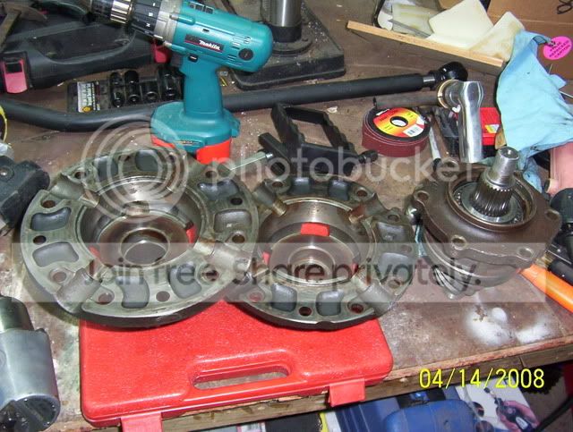

Got a little done tonight.

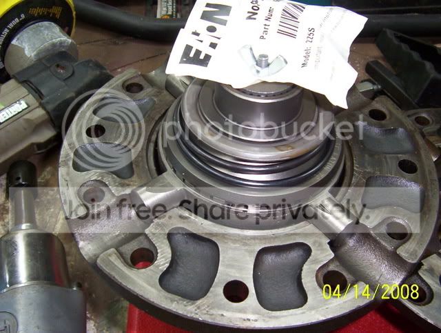

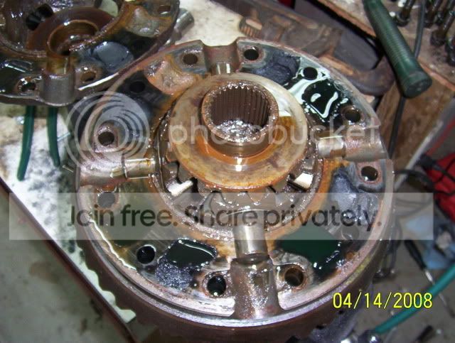

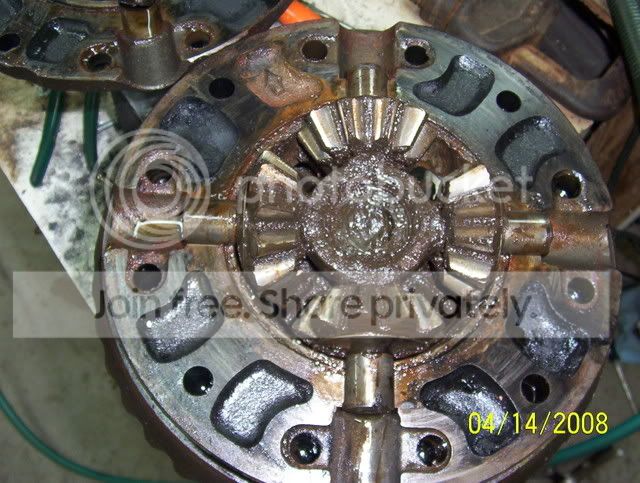

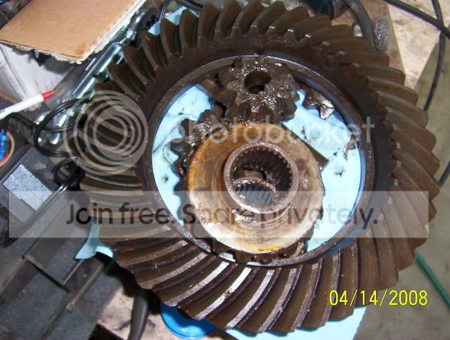

Tore the carrier down... Dear God what a mess...:doah:
Got the two halves cleaned up, and I got the pinion and bearings back in the pinion retainer.
What a beautiful sight.:D

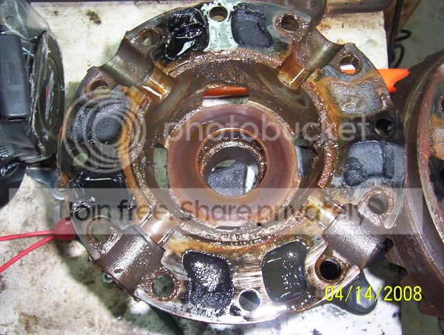

And a pic of the leftovers... covered in what appears to be mudgrease... it's a compound word I created to describe the lubricants I found in the carrier...:D
