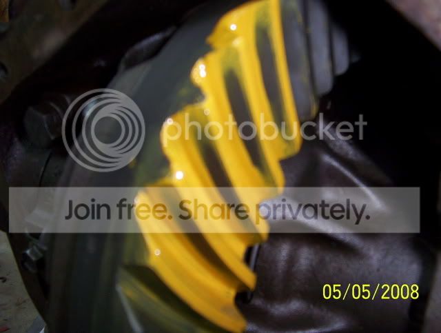

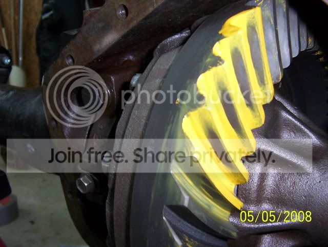

You should thin out the marking compound with a little gear oil. It will make the pattern easier to read.
Thin the compound and run another pattern. Get some better pics and post them up. From the pics you have above, I would say, get the pinion about .002 deeper into the ring gear and you "should" be good to go.

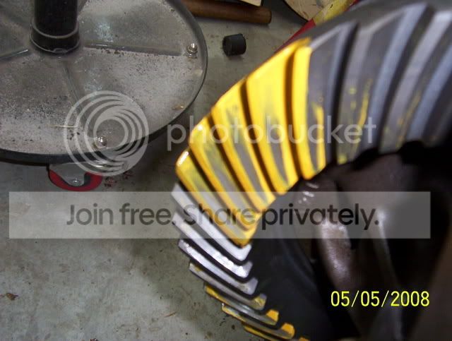

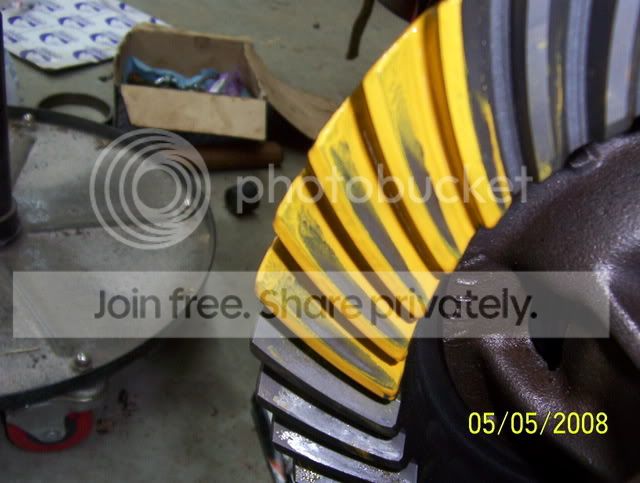

Ok, made sure everything was torqued to spec, thinned the paint with a little gear oil and ran the pattern again... what do you guys think?:confused:
theyre a little blurry, not like i can read it though. put your camera on macro mode and maybe it can show sokething these dont. macro is usually a little flower.
That's gonna require me to walk outside again... and then back... damn it!:haha:
The first and the last aren't to bad.:o
It is a little hard to tell because of the angle you took the pics at, but is the pattern centered top to bottom on the coast side?
It almost looks like you may be able to get the pinion a little closer to bring the pattern a little deeper into the root of the gear. I would change it no more than .002 though, like I said in my last post.
At the same time, If you don't feel like messing with it any longer, then run it. It looks to be a pretty good and centered pattern.....You might not get any better than you have there.
