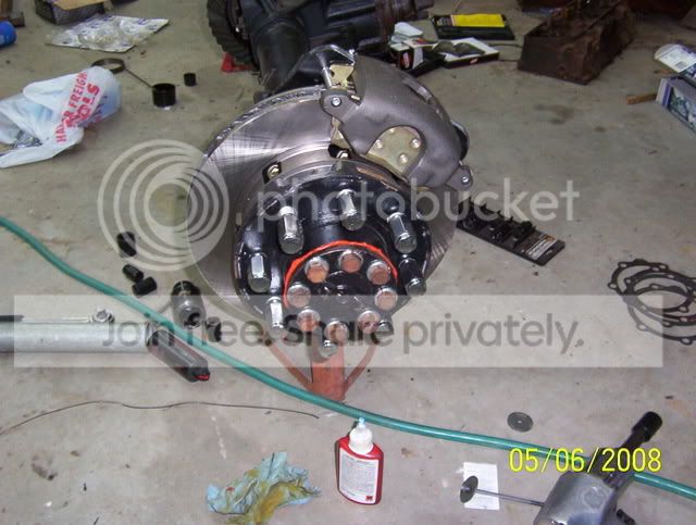

I wouldn't worry about it. It looks pretty good but it is a weird angle on the camera.
Either way, run it or adjust it some more. You will be fine.
At least it is a 14FF and they are easy to set up.
I'll look at a little closer, but I'll probably run it. Thanks everybody!

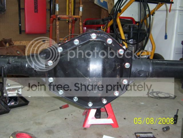

I'll get everything buttoned up, make sure none of my seals leak, and snap some pics tomorrow.:D

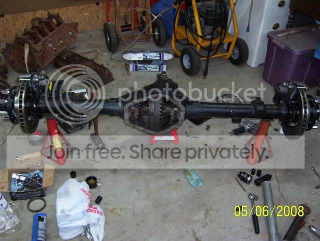

Well the axle build is done... only took me a little over a year... and bugging the hell out of a few members here, you know who you are...:D :haha:
