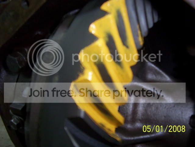

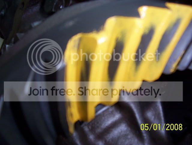

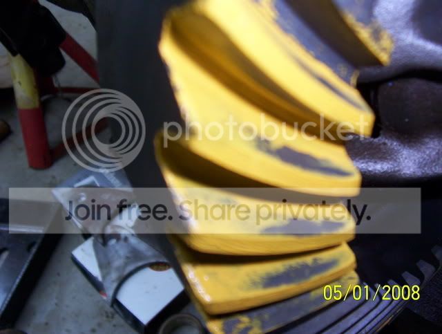

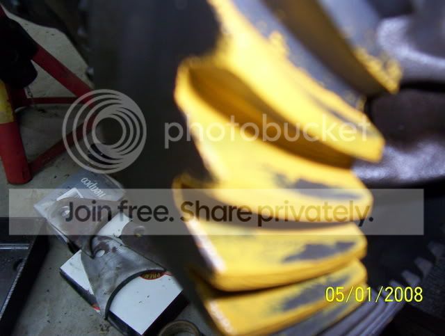

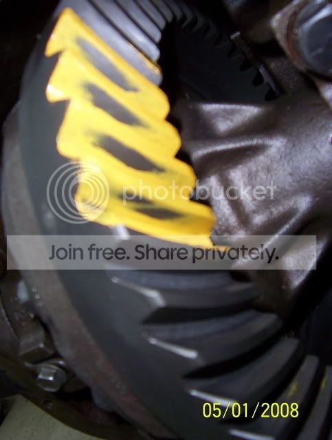

Got the axle assembled and now I need help reading the gear pattern.
Sorry for the blurry pics, I'm not a mechanic nor a photographer.:doah:
Maybe decrease pinion shim, and increase backlash just a tad?:confused: This is my first time... :1zhelp: As usual your opinions and thoughts are always appreciated!
I'm not an expert, but the pinion depth looks ok on the coast side... drive side looks like possibly less backlash.
You always want to make sure the backlash is right within spec before taking the pattern. If you change the shim, then make sure backlash goes back to spec.
Back lash was at .005 which is what was recommended... not sure why they look so different, that shouldn't happen should it?:doah:
Yes...sorta.
Side-to-Side...from the inner diameter to the outer diameter... Changing the pinion depth will move them both, but in opposite directions. Backlash should cause the pattern to go up and down in the tooth, although I'm pretty sure both will move together.
