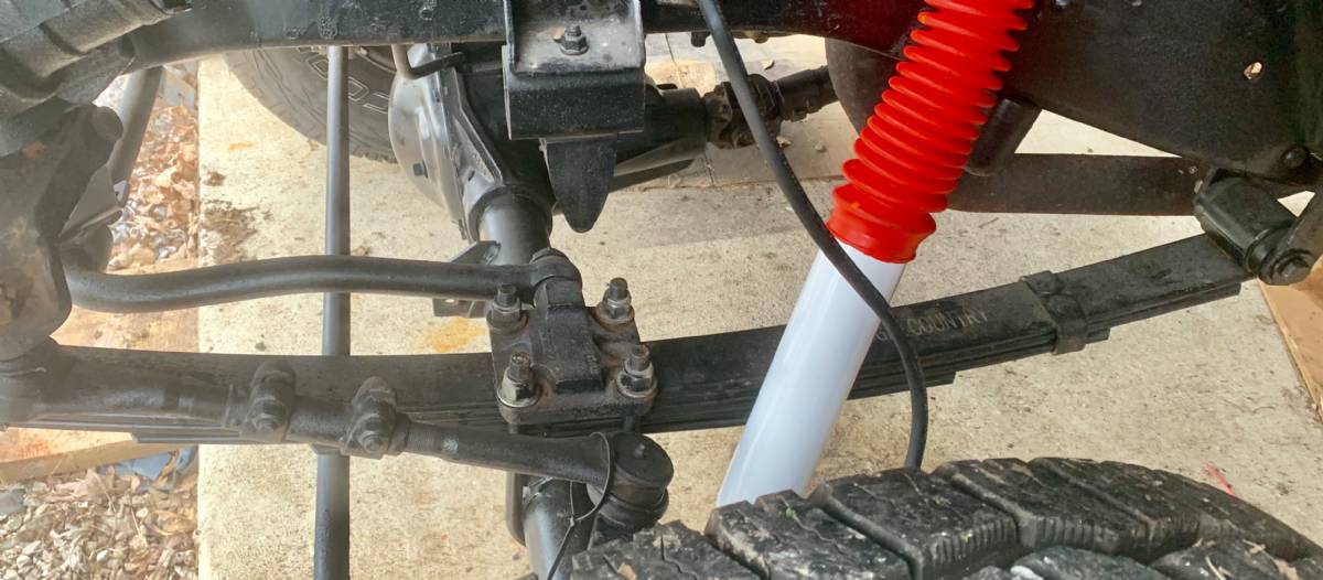

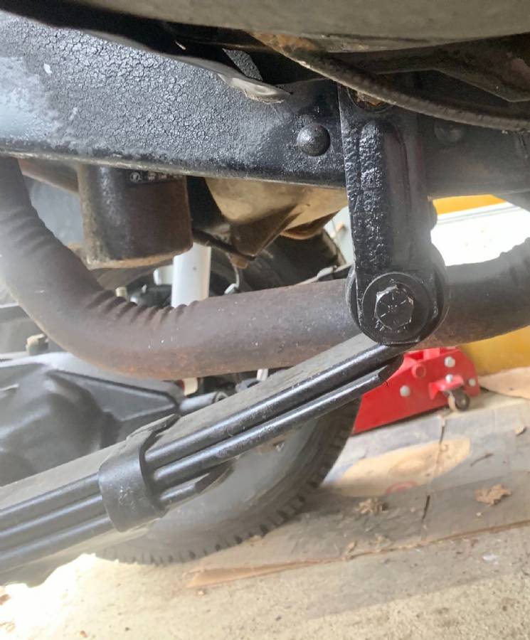

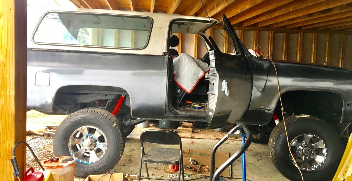

Can you post pics?
Best one I have right now. Excuse the mess in the pics.
I had t put 3" blocks in the rear on top of the lift already on it to make it sit normally. I hate the squatting dog look :surepal:
When you can, try to get some pics of the springs up close.
From what I can see the springs look to be installed correctly but I agree it's tall for 4".
