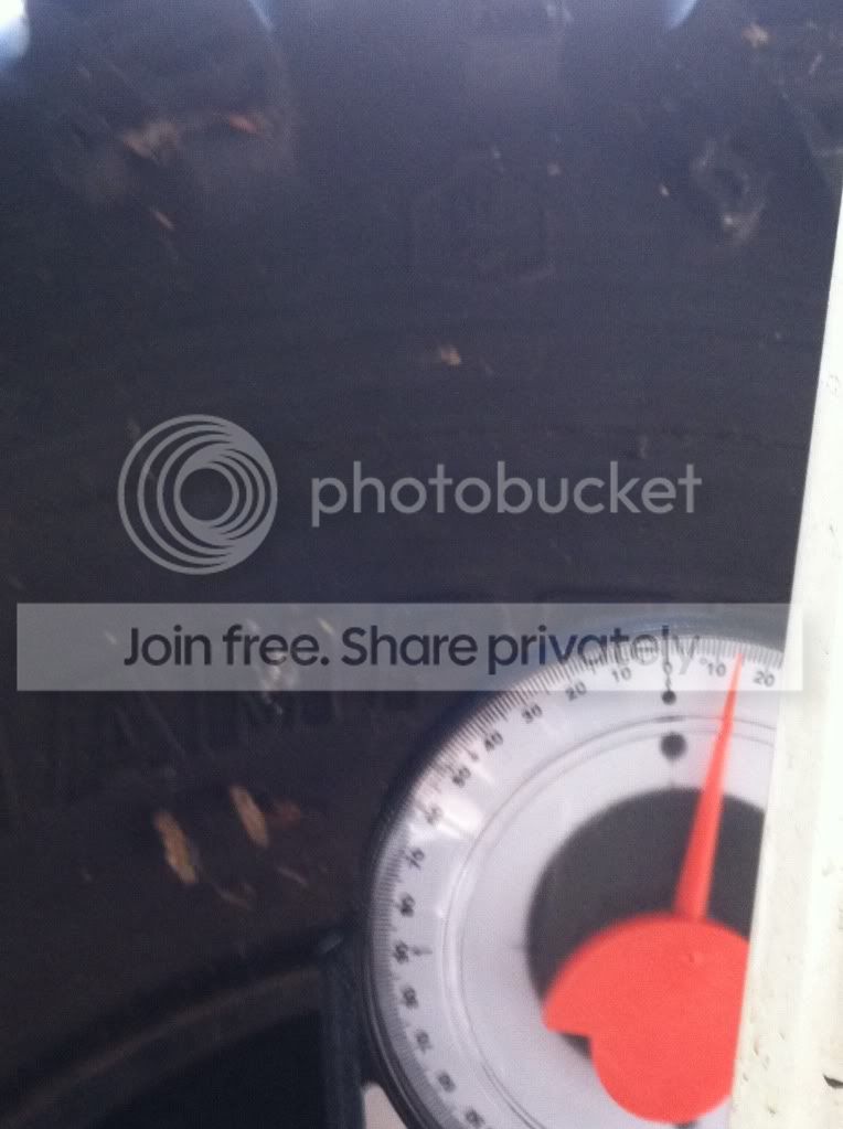

been really busy, finally getting around to getting an angle finder on it and its showing 14*, although im not sure its on flat ground so I will do it again.
thats of the driverside. the pinion isnt pointed up at all (so I assume thats -14*) i had 8* shims on there before and it didnt seem to make a difference.
am I reading this correctly? what degree is the "correct" amount or "within spec" so that I can eliminate this from the list of culprits? thanks
Also, I jacked up each side and tested the lateral on each tire and both of them seemed to have no play.
You want SOME positive caster, but not 14*. Positive caster is when the upper BJ (For example purposes only, because we both know u don't have any) is behind the lower BJ when viewed from the side. Unfortunately, when you get the right caster for good handling on the highway, you get the pinion pointed down to far. So most people shim the axle for good driveline clearance, and kill the handling at the same time. That's why it was stated earlier that to do this kinda lift and tire setup right, you have to cut the knuckle "C" off each axle tube. Then set ur pinion angle, and reweld the knuckle back on with the right caster angle. Seems like a daunting task at first, but ur throwing alot of money and time into as it is. May as well do it right and then forget it. Just food for thought......
