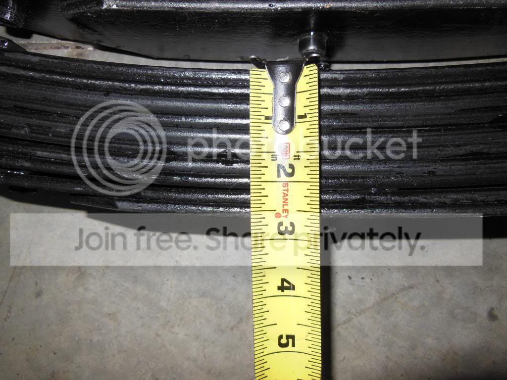

My ORD springs are a very tall pack - 11 leaves. I think yours are the same. Definitely thicker than a lift kit spring.

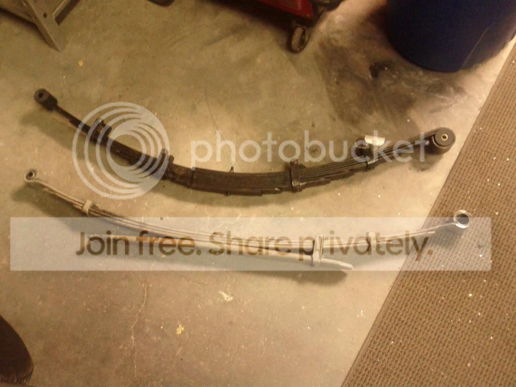

Not the same type of truck but I installed a set of Deaver 3” lift springs when I lifted my NISMO Frontier a couple of years ago and love them. There are 9 much thinner leafs in mine and they handle just as good, if not better, than the stock 4 leaf packs on the road but still flex great and ride Cadillac smooth. I ordered them through a nearby shop that specializes in those trucks (PRG Products) and custom orders them from Deaver based on their hands on experience with the trucks and what the customer is going for, similar to how ORD does things with Alcan. I’m personally not all that experienced with leaf spring geometry and characteristics and liked being able to order something as a complete kit from a well-known and experienced shop. That’s also the same reason I’ll be ordering a set of custom Alcans from ORD once I get my K5 to that point. ORD puts out some great products and has tons of experience with square bodies.
Here’s a side by side of my Deavers and the stock springs they replaced in case anyone wants to see what a custom set of Deavers can look like:

I shoulda taken a pic of the Deavers on a blazer I saw at GriffenFabworks last night. The deavers they had on that are WAYY thicker packs than mine.

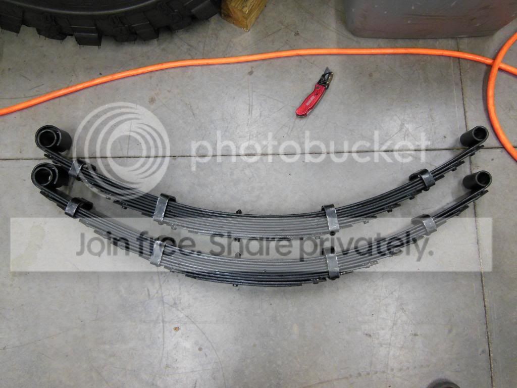

These were the deavers on that 72 I saw last night.
Looks like tons of lift to me, so there is still room for bumps. Plus with that much arch, the spring design has to do whatever it can to make things softer. Could be there's no weight on the suspension, though. Still, I count 13 leaves, probably only 1/2" - 3/4" thicker than your springs.

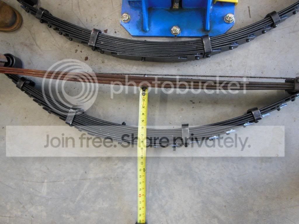

Here are my Alcans from ORD. Keep in mind these packs are setup for my heavy 6.2 diesel that scales in at about 2,000 lbs per front corner. They are a 10 leaf pack.
Here is the stock flat 1 ton spring next to the new ORD spring. These were ordered to be 5 inch leaf springs stock length center pin moved 1.5" or 2" forward of stock.
The springs initially netted me 6 inches of lift or so but have settled some and I still have not finished or wheeled my truck so I am sure they will settle right around the 5 inch lift mark. The little I have been able to drive this truck around the yard so far they ride great. I did have to add a shim in the front to get the pinion angle better. Can't wait to try them out on the trail hopefully this year.
