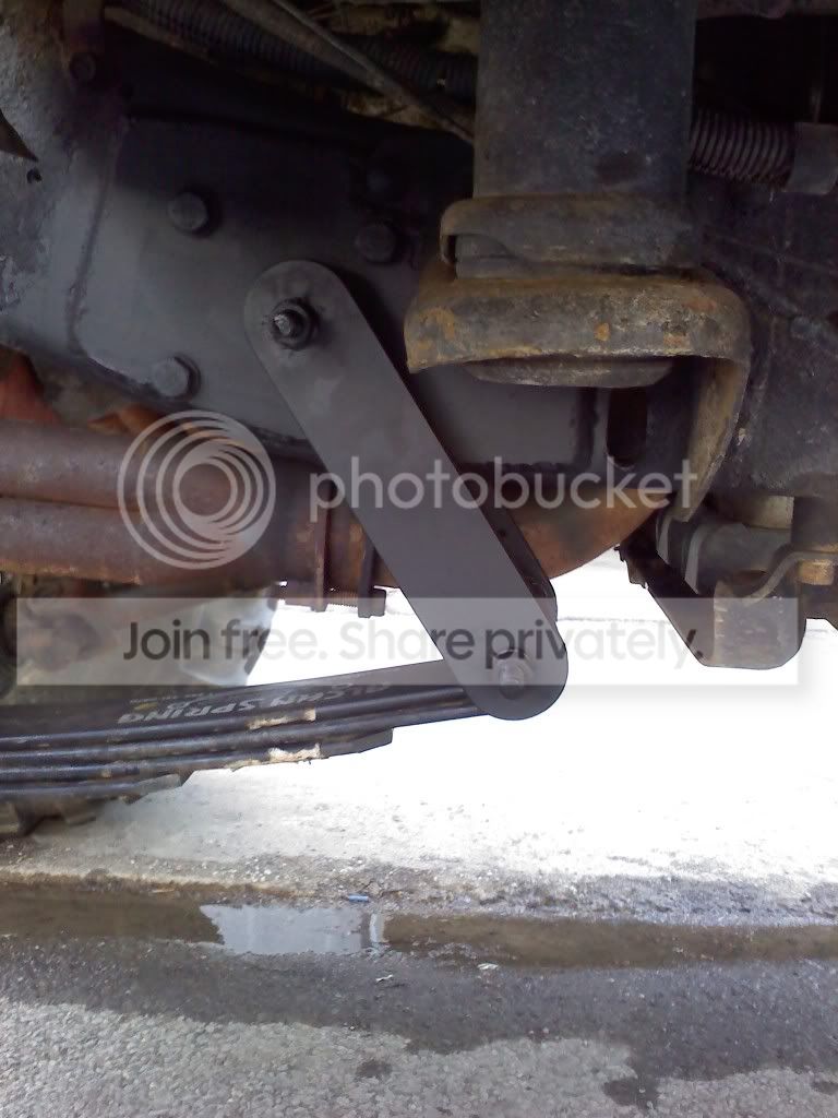

Here's the latest.. I have no idea besides he said factory rivets failed on hangar..
This looks like he hit something real hard on the driver side, the shackle bottomed out on the frame and the spring had no where to go but get bent up. Looks like there's no bumpstops either (minus the factory one which is useless on a lifted truck)
That's what I was thinking as well muddermilitia. Looks like he beats the hell outa his truck then. If I had a trail rig only I'd probably do the same. But mine has to Get to And from where I go. That's some real damage there. I'm guessing he had to Replace that spring. Lol
