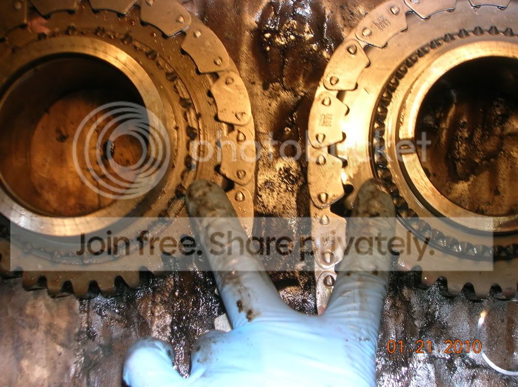

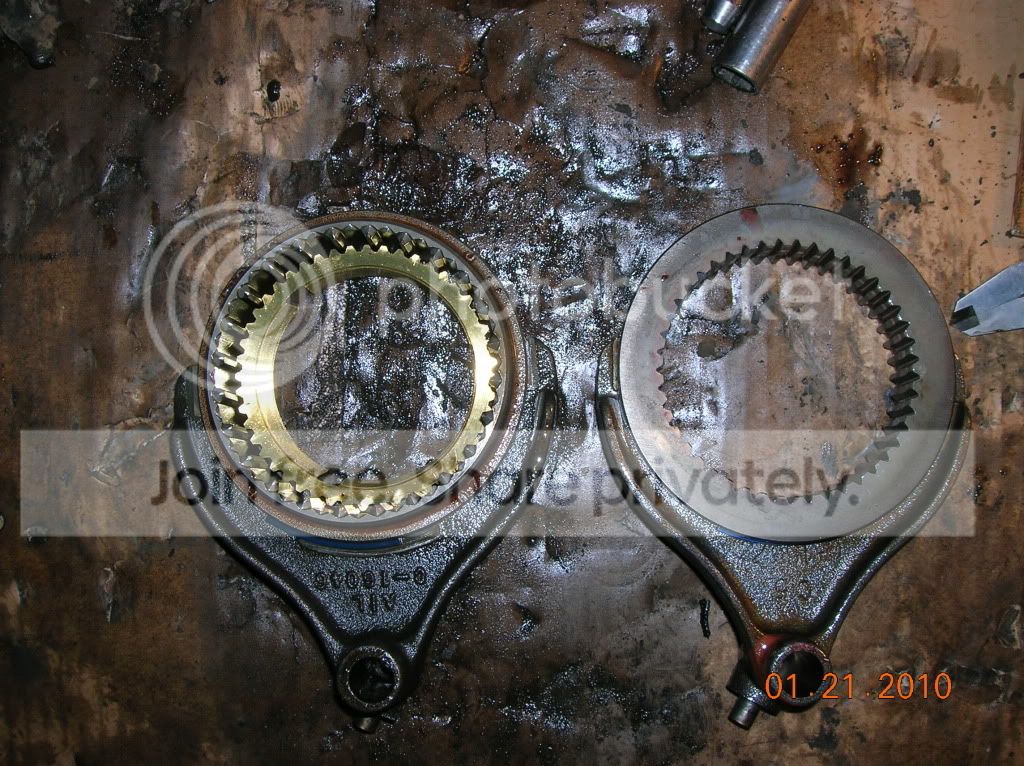

Do you know the diameter on the bolt circle? I am doing the same conversion and would like to make a template before I drill out the holes. Plus there are some difference in the internals between the Dodge and the Chevy. I'm trying to write a thread about it but I dont have the required posts yet so I'll get some pics up soon.
