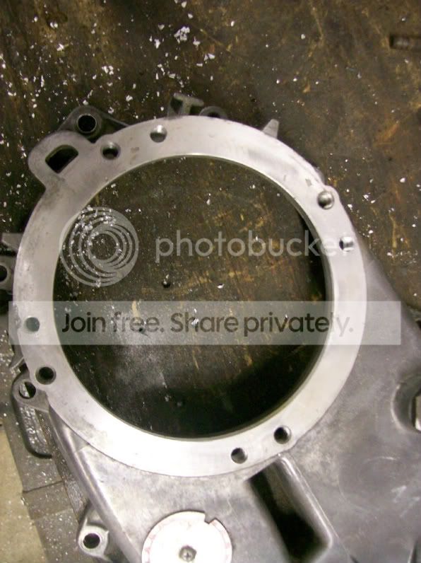

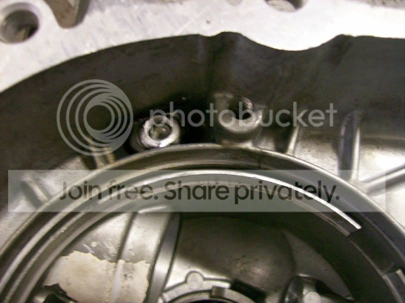

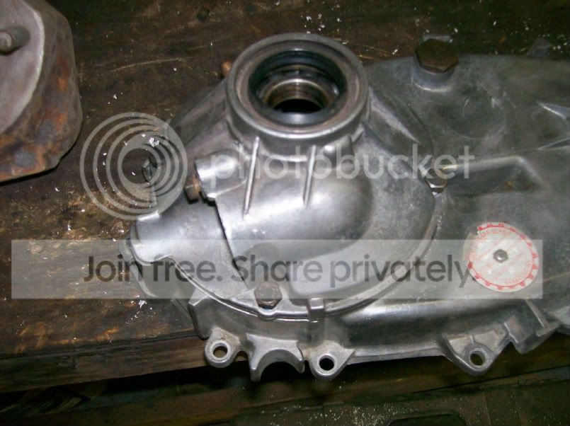

Just thought I would add a few pics of my Chevy/Dodge 208 SYE build I did for my fathers 54 Willys. I did go ahead and have some extra material (bungs) welded in the case just to be safe and give some extra material for cutting threads into. Total I have $80 in the SYE mod. $50 for the t-case from a pick and pull and $30 for the weld job.

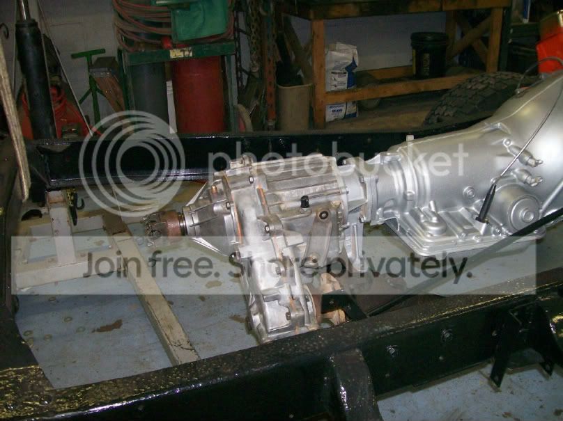

Here is a shot of the finished case, it's hooked to a 700 trans, and if the frame looks strange that's because it's a 1962 Willys wagon.:D
I did this mod for jay and did the write up. if you were really concerned with the rear cone you could tig in some bosses or you could grind out around the hole and thru bolt it. i personally do not see an issue with it. besides it wasnt mine!!! lol
I agree, it would more then likely have been fine, but for $30 the welder charged me it was cheap insurance to have a little extra material there.:D
