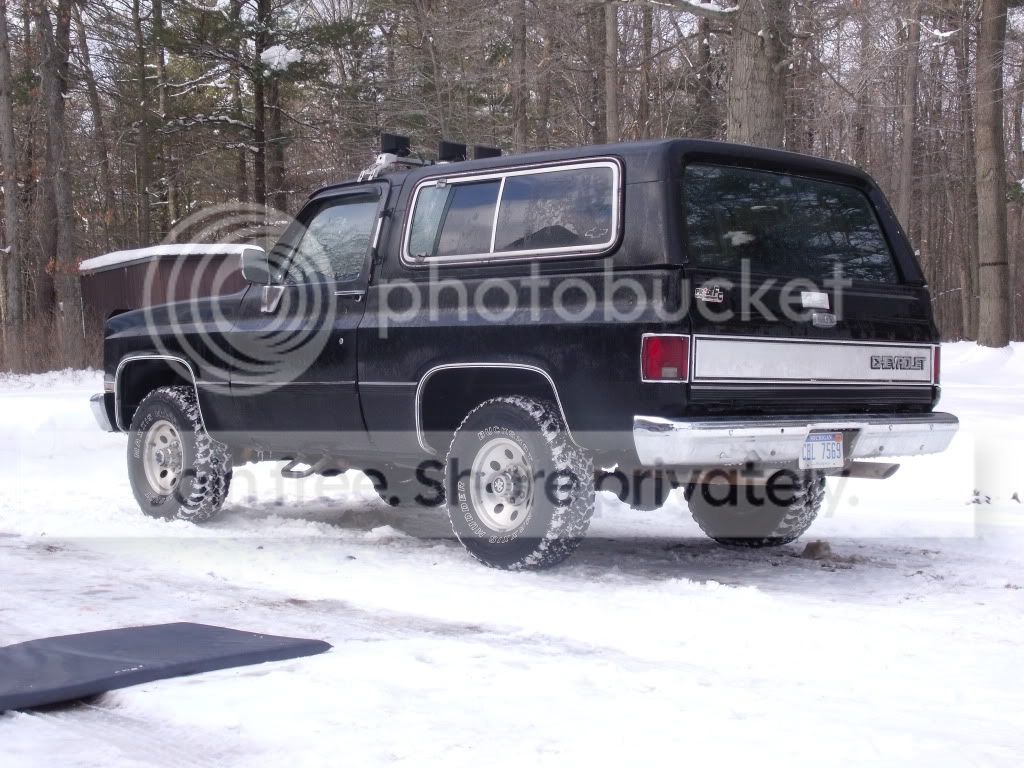

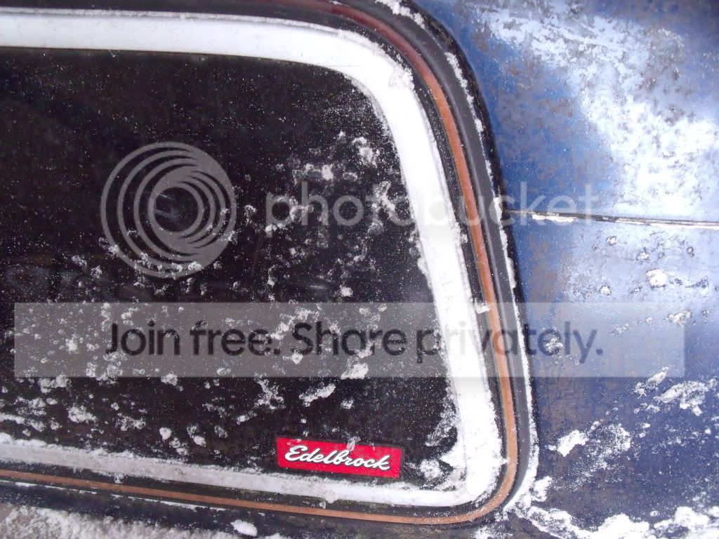

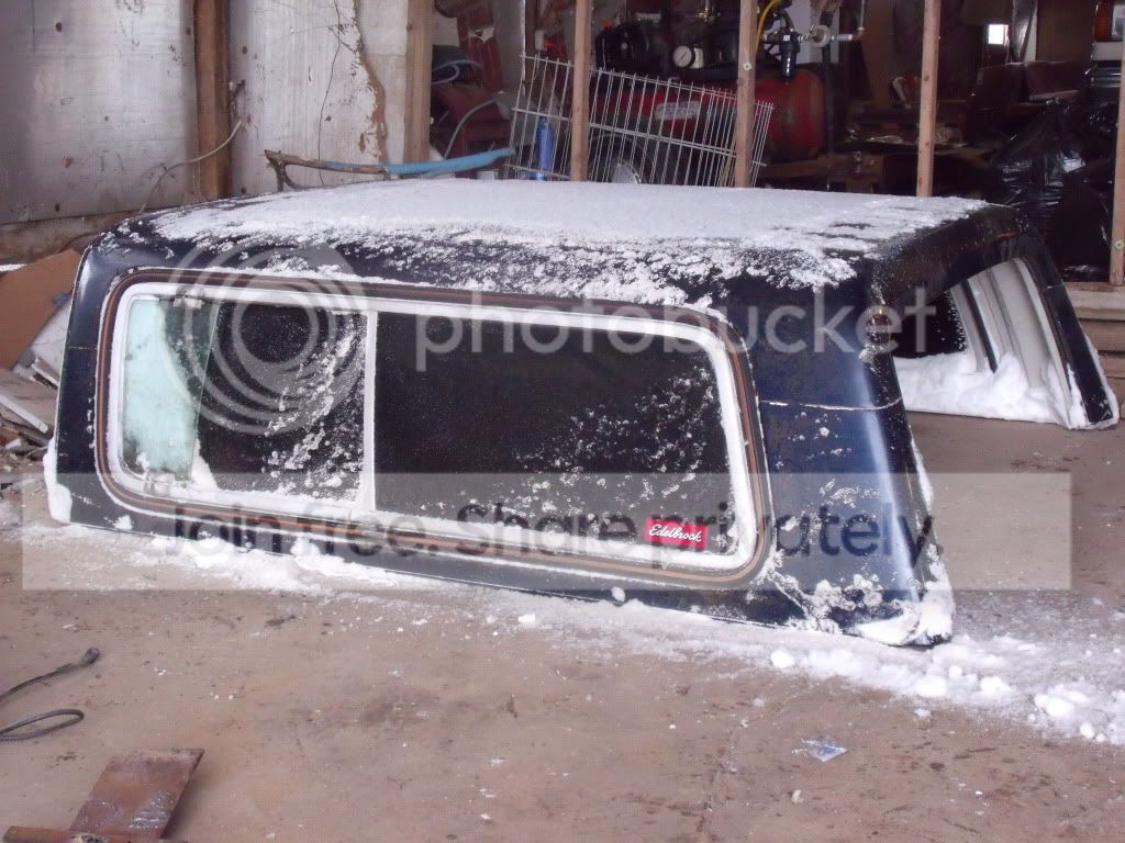

Went and picked up a new topper today. The windows in both sides of mine are cracked and the window seals all leak. Guy had a nice one with good seals and glass for $100 and he met me halfway. Its blue, and pretty dirty, but i will just give it a good sanding and a coat of flat black and call it good.

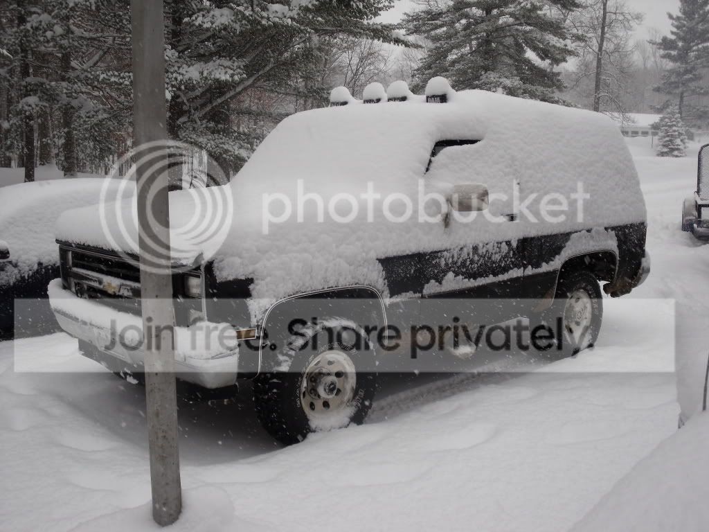

Sorry about the snow lol. Idk what im gonna do with my old one.
And this was just the snow we got from 1am the night before after puttin on the new muffler to 8am when i got up lol.
yup, my place looks the same, maybe just a bit more snow. I just cleaned off a good foot of snow yesterday from my truck. I live on the north side of holland just 3 miles from the lake, and I feel your pain with the rust on your k5.

I hate the chrome window locking strips like that - they always turn brown. If the topper you have now has the black strip, just use that. Otherwise you can buy them for real cheap. You want to use the aluminum clip on them - I've seen too many brown runs down the side of K5/Subs from rusting steel locking strip clips.
Yah the ones on mine are pink and falling apart, so the brown still looks alot better, but i will have to look into that thanks

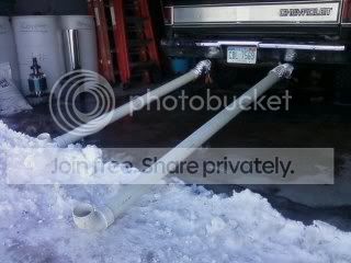

Just got home from being at work for 13 hours. I was the only one that could make it in besides brett(my boss). I worked till 3 then brett let me work on my truck. Fixed Timing (12* at idle, 8* advance with 15 HG of vacuum) Switched it to Non ported vacuum, and fixed manifold leaks and tranny leak. OMG its like driving a new truck. Breaks work 10 times better because of the vacuum fix, and its quiet as can be in the truck. It had that horrible manifold clicking sound before and i couldnt hear a thing driving. Im lovin it. :D
Used a little enginuity to get the exhaust outside and not get smoked out lol. Perks of workin for a Plumbing Company lol.

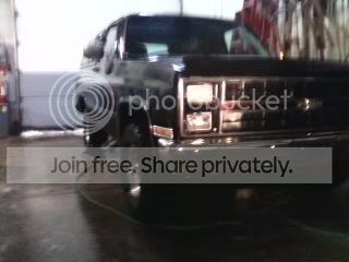

Just got done, filled her up with premium after a wash down. Had a lady come up to me saying "OMG that is such a cool truck!!!" lol made my day.
