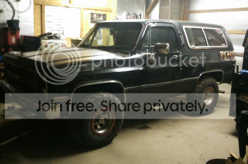

I could turn about 45* on the steering wheel before they rubbed lol. Gonna need more altitude :thumb:
(and no i WILL NOT TRIM...:D)
Wuss.
Specs on the rims? I've got 33's on mine and they fit well.
They are the mickey classic locks, they are 33.12.5 tires on 15 rims, idk what the backspacing is, I wont be buying the rims from him, just the tires, it was late, we thought it would be funny. Ill be running some gm rallies, ive got 2 need 2 more and beaty rings and see if my caps on my wheels will fit on them. :waytogo:
Eff trimming :D
