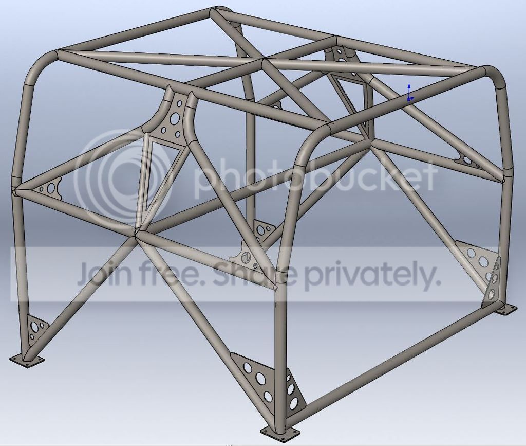

I was thinking of notching my cab, right where it dips down for the "internal rollbar" BS. That way I could suck the tubing right up against the roof. I bet there's a good amount of hidden height if it's notched and I don't think it will affect the hard top mounting.
What do you think Adam? I haven't stared at it enough to come to a conclusion.
Yah there is alot of wasted space. I think the roof is double wall. Could probably notch out the lower, and weld the tube in it halfway. That sounds like a pain though lol.

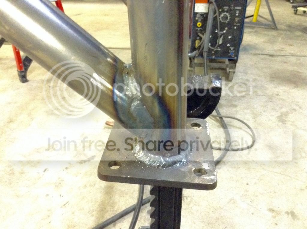

I kicked butt today. I can barely move derp wrist anymore from welding for like 5 hours....
looks great buddy fantastic job. :thumb:
Thanks dude.

This one is for daves "looks good on paper" comment ;)
Br interesting to see how much it moved from the welding when you get it back in.
I think its gonna be pretty damn close.
It never made one popping sound through the whole welding process.
So i think making all the joints tight, will mean it didnt move much at all.
When we did bretts buggy, his notches were not nearly this tight. And the thing popped and creaked with every weld.

Being in the drafting field as well I too like how exact it appears to original concept. Great job. :bow:
