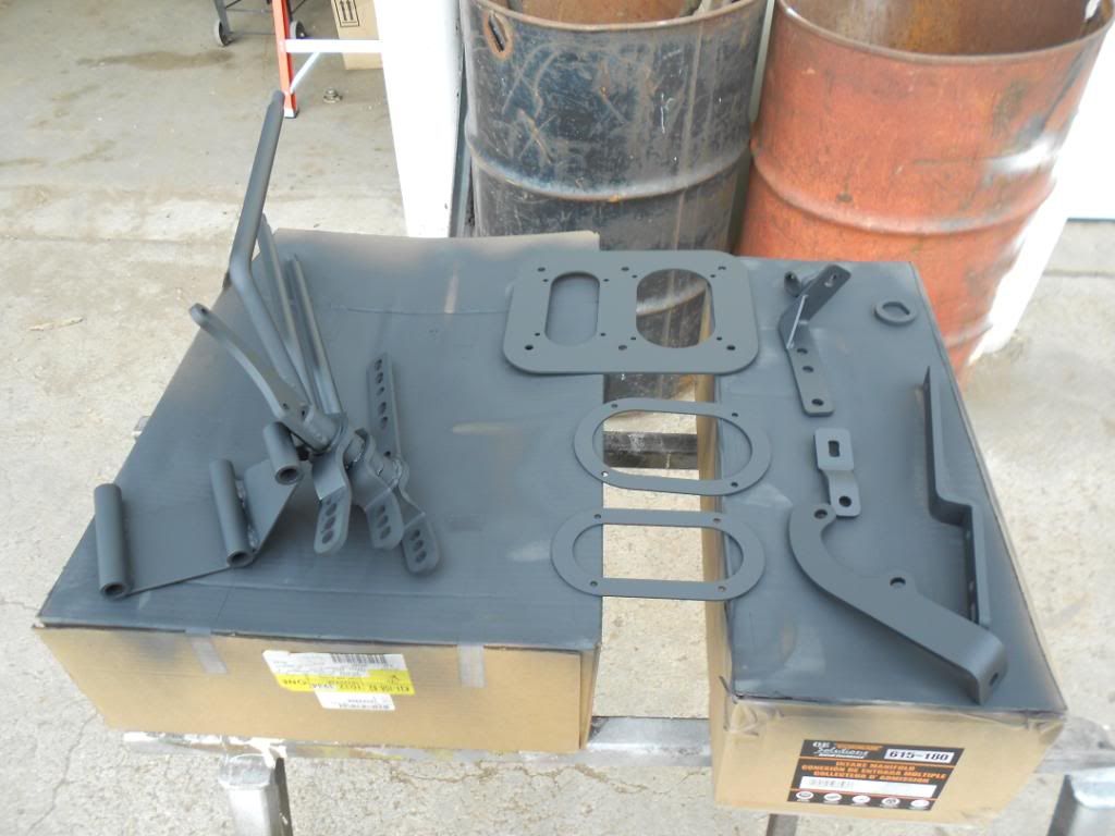

The triple shifter is made for the most part. Stuck it in the rig to see what I wanted to do with the height and offset on the levers. Looks like I'll leave the right one straight and offset the others towards the driver. Height of the three will be as tall as the shortest one finishes at.
I will probably add stops on all three for when excitement precedes finesse. Nylon thrust washers and spacers will go between each hub. I changed from 50cal BMG to 20mm casings mid-way but not too hard to compensate.
Is the inside one for your range box? My home made shifters were different than my ORD ones. Took me a little while to get use to it, so I put an NP203 shifter knob on the range box shifter.
Martin
Yes, sir. Left is range box, middle is rear output, right is front output. I assume you did cable shifters. These are rod linkage.
Kind of.
Martin
Yes. My home made ones were kind of cheesy, and would start to bend if the NP205 bound.
Martin
Martin
Those certainly look strong enough. The only reason I didn't buy a shifter is the use of the cartridges. They're machined and lighted now so I can see them easy while night wheeling. That's where the chromoly tube came in... hiding wires and all.
