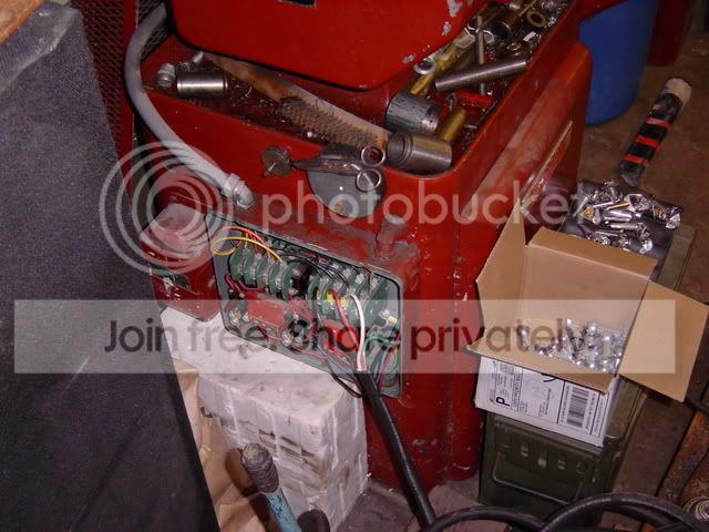

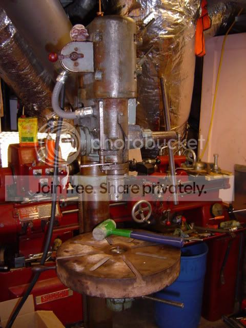

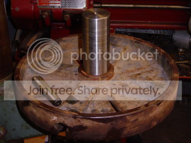

Here we've got it wired into the lathe motor starter.

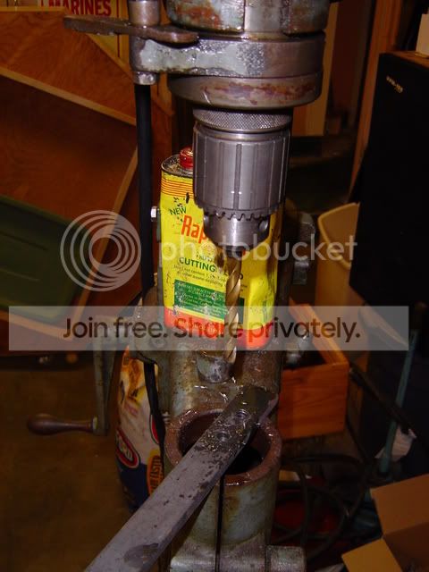

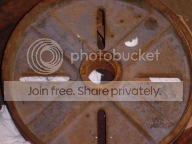

And here's a coupl of freshly drilled holes.

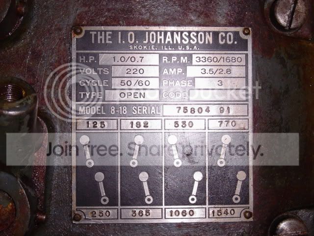

I can't run it in high speed unless the lathe is on, providing the third leg. Apparently the static convertor doesn't work well on a delta wound motor.. It runs great using the lathe as a rotary phase convertor, so that's what I'll do for now.
