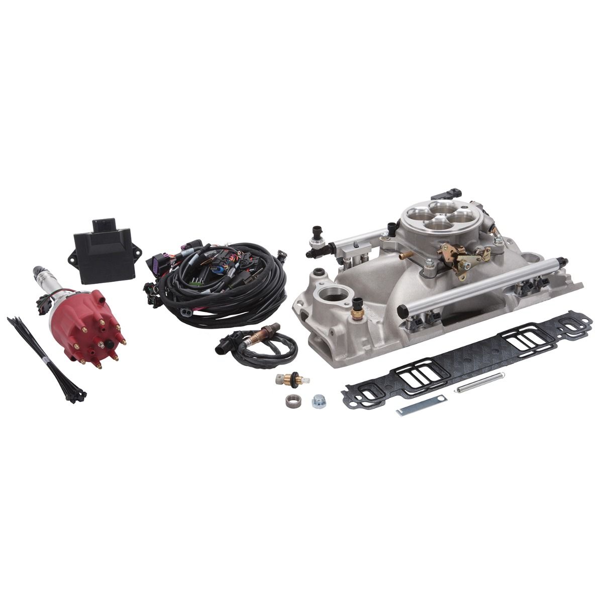

After much consideration, I decided to try the Edelbrock system. It has timing control already, fuel pressure is hooked to a vacuum reference, intake air temp sensor and MAP sensor, progressive throttle bores, which are 44mm each, 4 of them. Sequentially fired injectors with a single plane intake. Wideband O2 sensor included. The ECM is remote mounted, bluetooth accessible and has an IBM (?) port too. I believe that a USB port would be better, but I don't know for sure.
I called Edelbrock tech before I made the decision and was pleased that I had a guy on the line in a few seconds. But I still didn't know that I was going in the right direction.
I liked the fact that I could use an Android device to link to it.
I ordered the system from Summit and got to work.
This is how it showed up.
