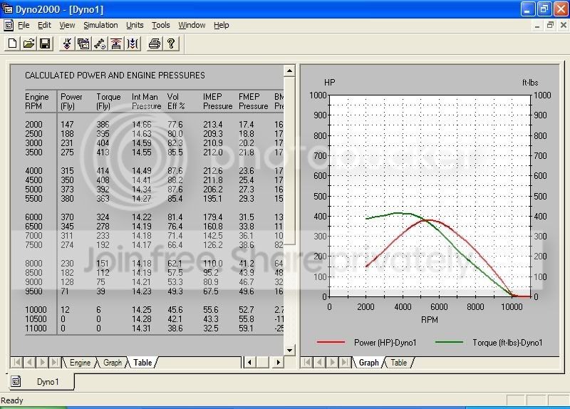

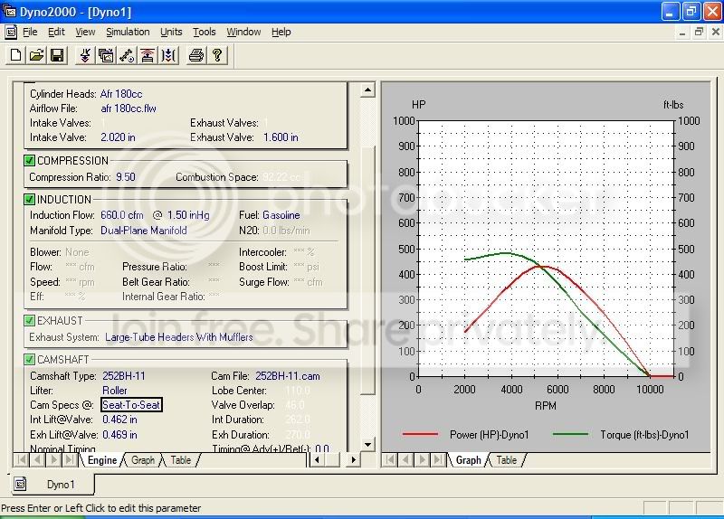

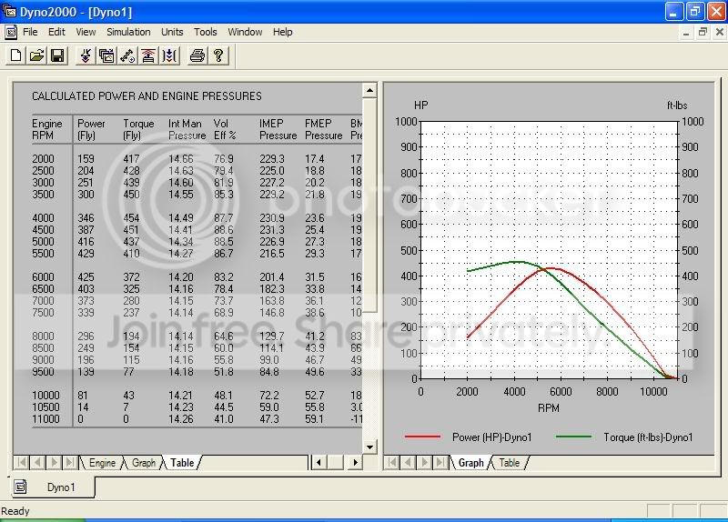

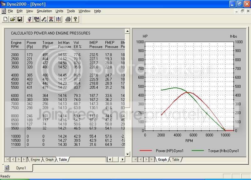

Roller 355 with numbers vz rpm

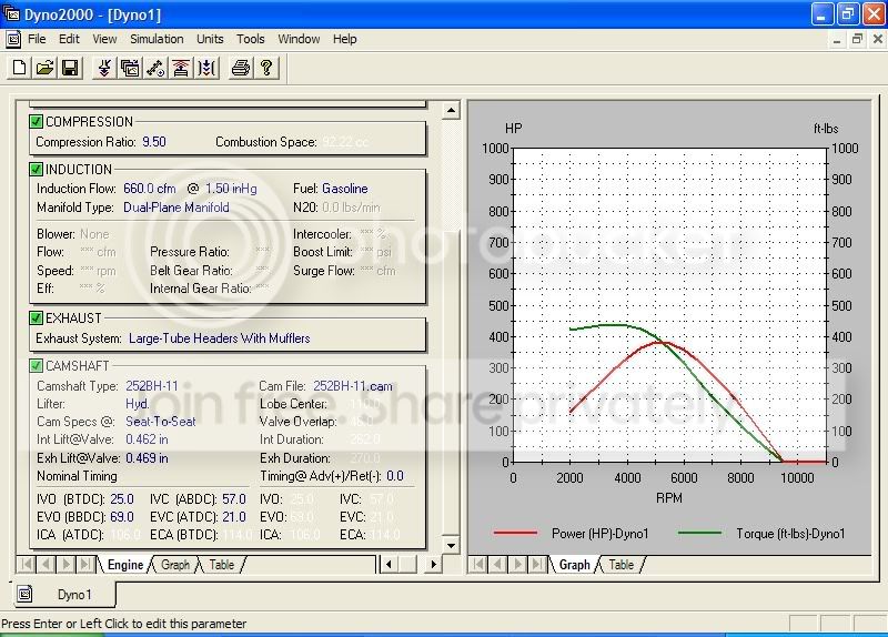

Non roller 355 with numbers vz rpm
Roller 383 EDIT: (forgot to get the numbers vz rpm.... check post #52 for the numbers vz rpm)
non roller 383 EDIT: (see post #52 for numbers vz rpm)
As you can see a roller block is a good investment.:wink1:
Pay no attention to the camshaft type and cam file.... I entered the right specs for the 262 but didn't save it so thats what it shows up as. The 252BH-11 was a cam for my boat but I DID enter the 262's specs......
Everything I've posted is with the 262 part # you gave me.
Chit..... Meant to do the last two with the numbers vz rpm......
new screen shots comin.
okay.... These are the same as the last 2 but instead of the engine info it's tq and HP per rpm(screwed up the screen shots in post #50).
roller 383 with numbers vz rpm......
non roller 383 with numbers vz rpm
If you want to see some different cams let me know.....
