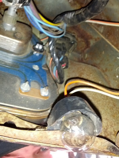

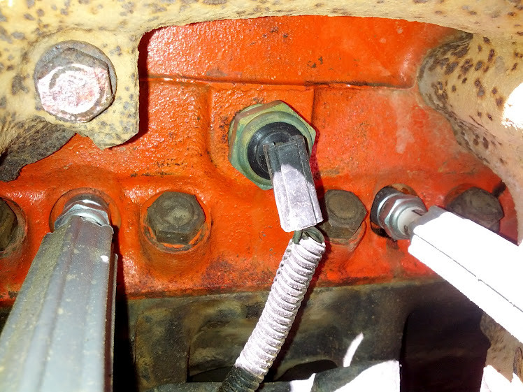

Also while I was looking at the horn relay and e-brake areas I found a couple wires that are disconnected but I am not sure what they go to. The pictures are kind of vague I know, but the first one (green w/ rotted insulator) ties in just underneath the distributer it looks like (area circled in green) The second one (red and white) was just hanging down by the fuse box. Does anyone know what they could go to?
I thought that was the light under the dash, like under the passenger side. I have the same thing. Will be good to know for sure what it is.

red and white wire on driver side, bulb comes on when driver door is opened:
i have a green wire on the side of my engine, assuming for a sensor, and it goes up towards the dizzy or electric choke, but I can't tell what it connects to. thought the connector looked similar to what you pictured:

I agree. Looks like temp sensor and under dash light. Check the driver side head for the temp sender.

Thanks for the replies guys. I was hoping it was for the temp sensor as mine wasn't reading last time i had the thing running.
