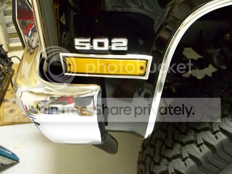

Just go buy the 502 and that way you can say yes I have a BBC 502. How many people can really say that? That would be a nice feeling:D:D
braggin rights have been passed on to the 572's or 632's, who can say that! i know of several 502's around here both in street rides and the mud bugs.
