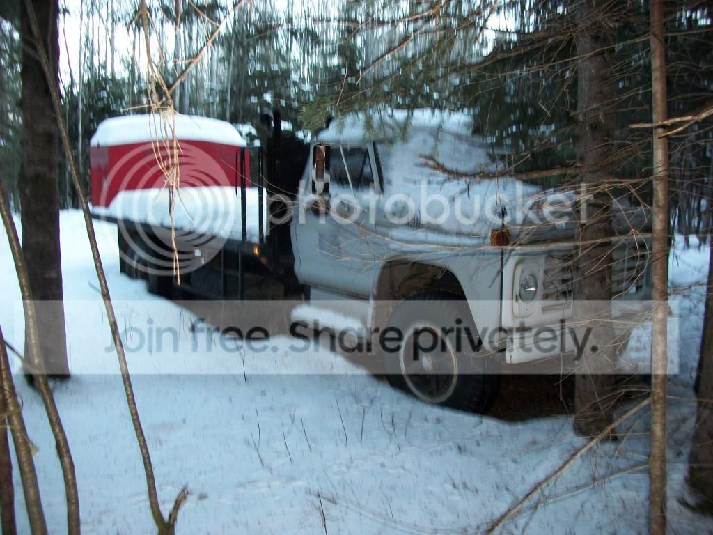

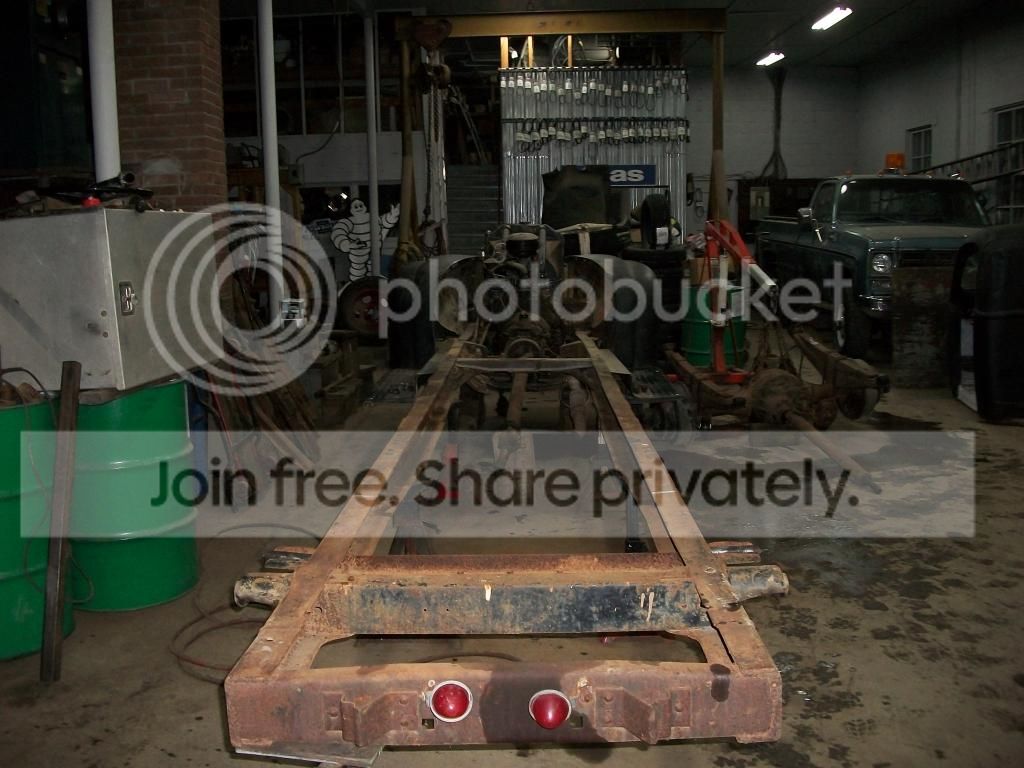

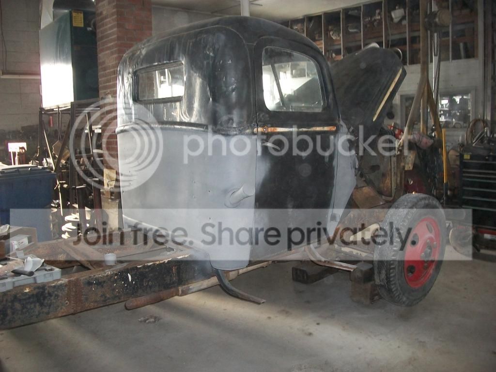

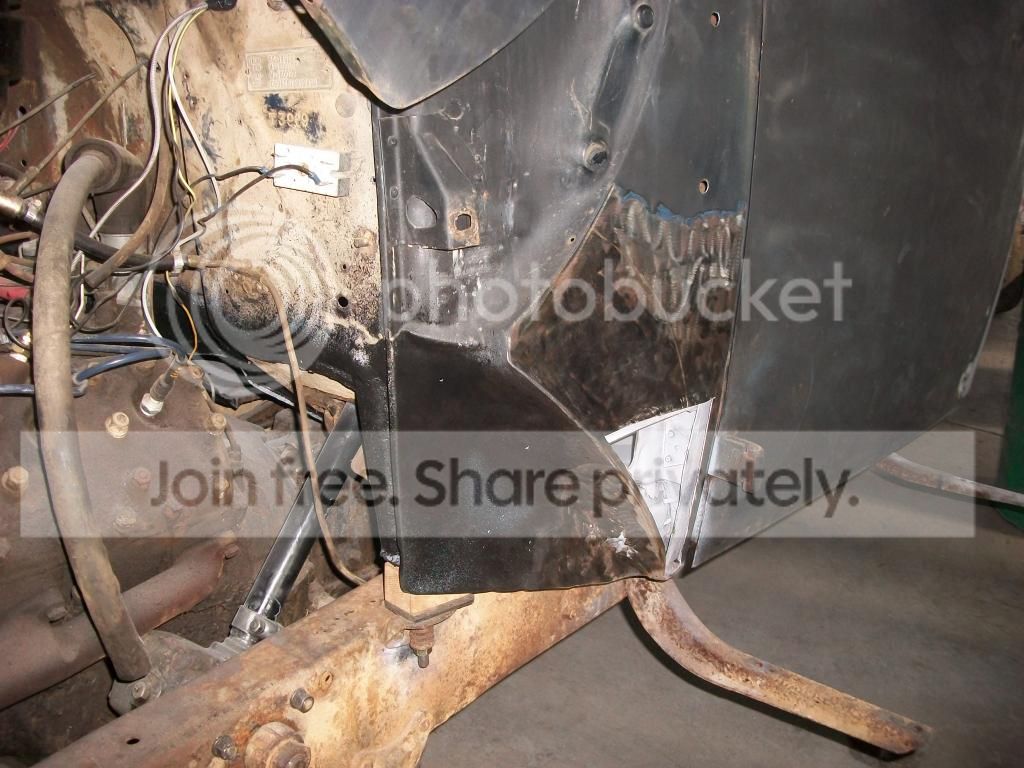

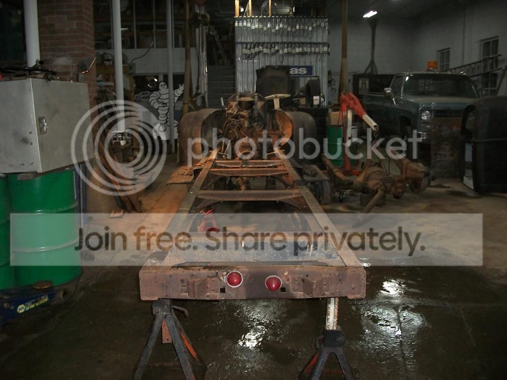

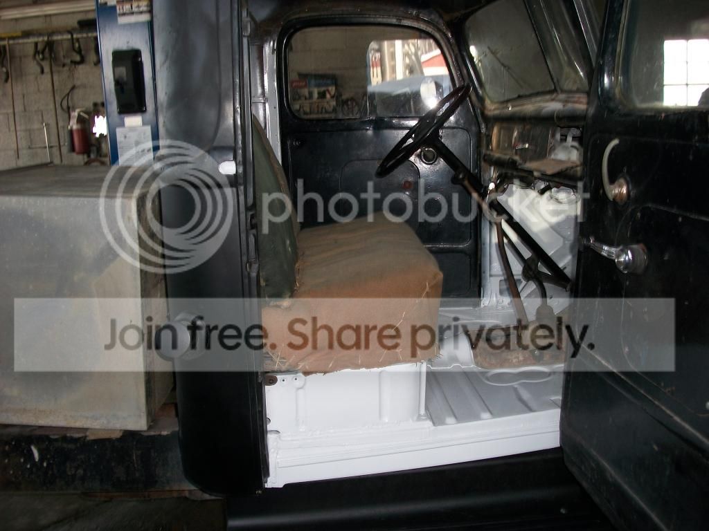

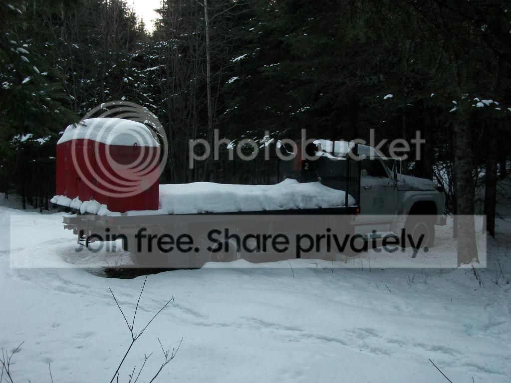

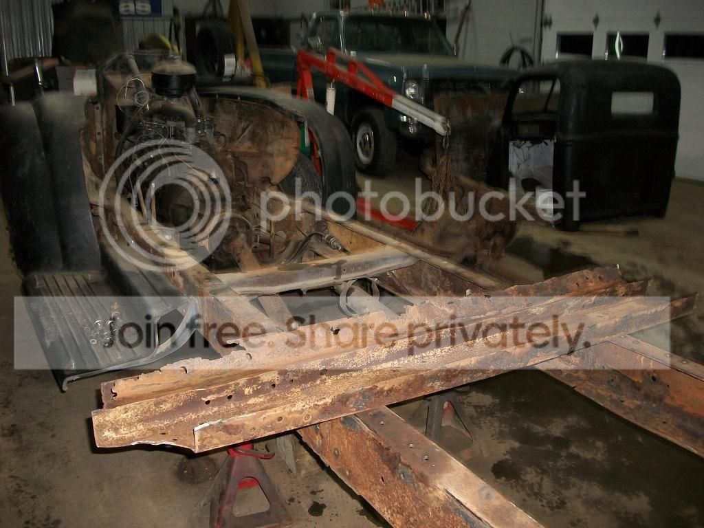

should be starting in a few weeks . major frame repair is first, then i got work to do on the doors . inner and outter door skins ,regulator parts and door locks handle window cranks. i pickup this f700 last summer ,did a little tune up fresh gas sanded points and bleed brakes. it runs pretty good ! i bought it for the flat bed i paid 400$. doesn,t cover the cost of the iron to built one. if ever my flat head was to have cracks , i might use the 330 cid engine and 5 speed transmission.

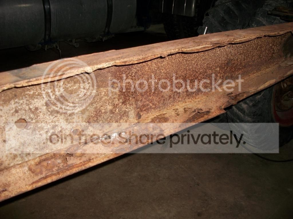

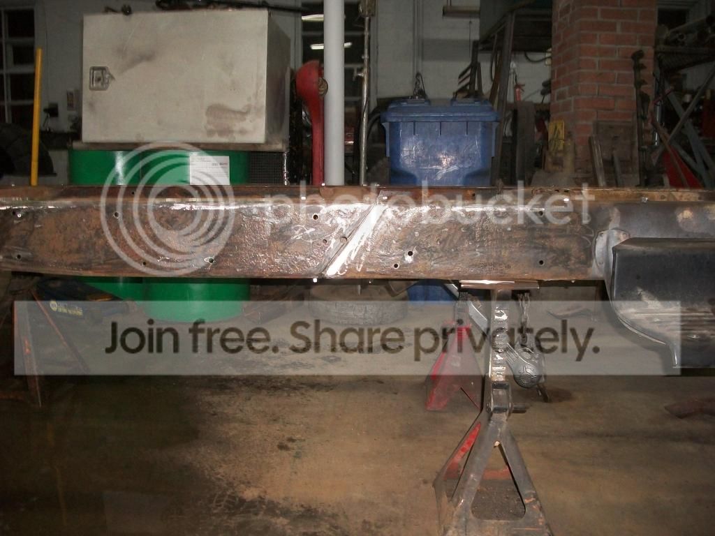

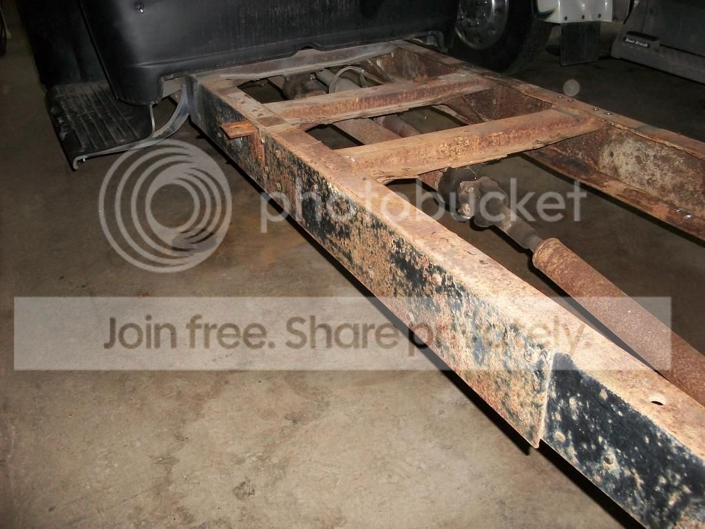

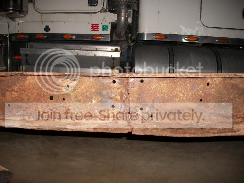

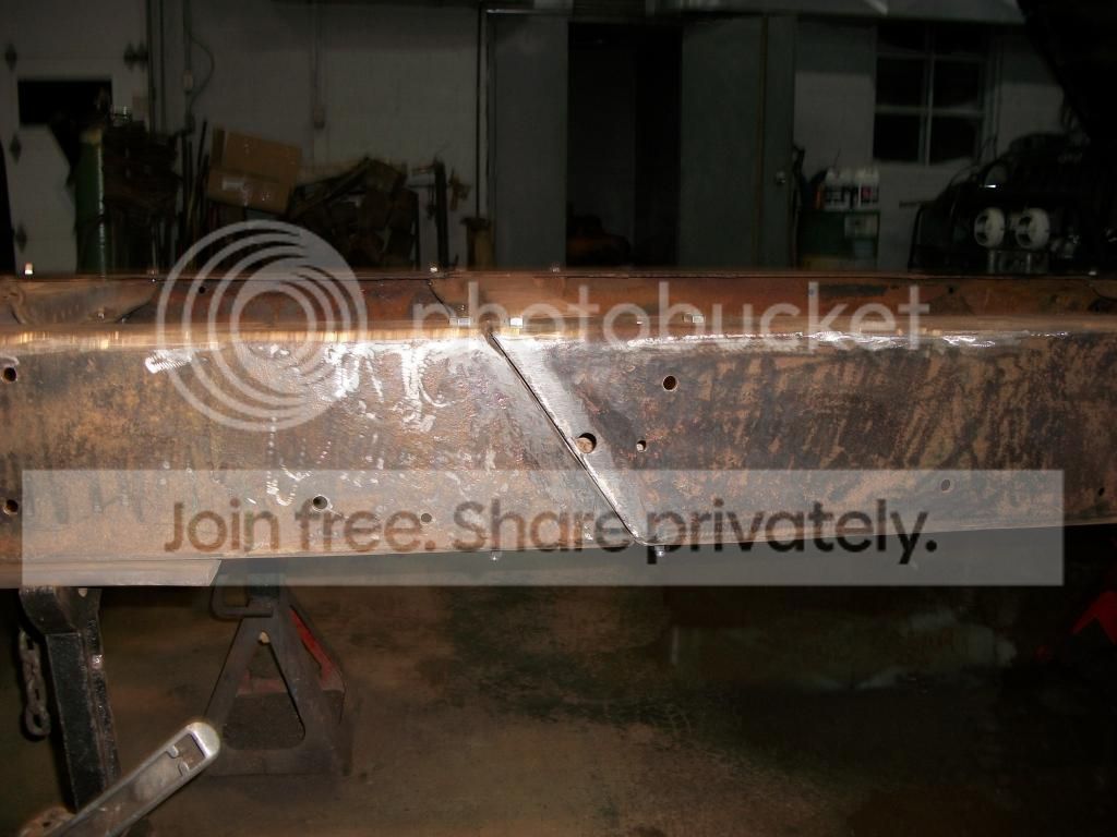

got alot of work done on the frame. removing rivets is time consuming. the truck has a double frame,the inner frame liner was badly rusted. the inner frame liner went from rear front spring leaf bracket to rear front spring bracket. i decided to cut the inner liner at the cab crossmember. i shorten the frame about 19 inches,so now its about 159 inch wheelbase. it had been welded and braced with inner and outter plates. i,m pretty sure the rear end and rear frame doesn,t come from this truck. i will replace the inner liner with a new peace.

thanks! i,m a gm guy,but ford is second. i found the truck locally. i was looking for a project ,and its what i found. at first i didn,t really like the ford look,gm are alot nicer. its like the ugly duckling,its growing on me!!!
