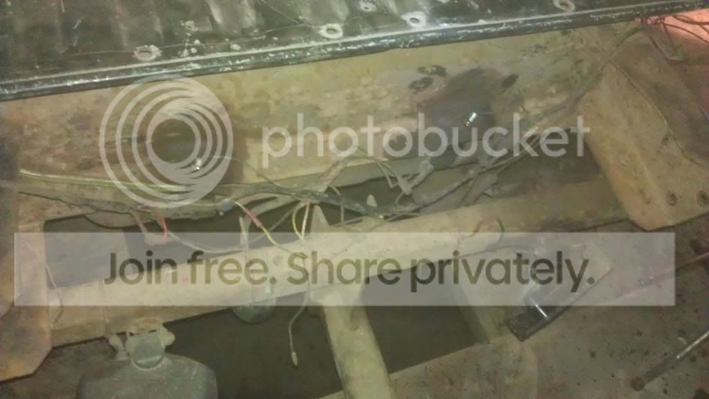

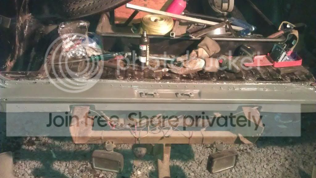

The orginial cables for the lights are somewhat bad (showed at the right side of the picture) so i decided to use some better contacts and put new cables in with a bigger diameter directly from the battery and only use the old system as a input for the relay.
picture.php
The new cables/contacts are 2,5 mm2 and are made for commercial trucks so i think it will make a difference. Everything is soldered togheter and covered with shrinking tube since i live in a roadsalt loving area.

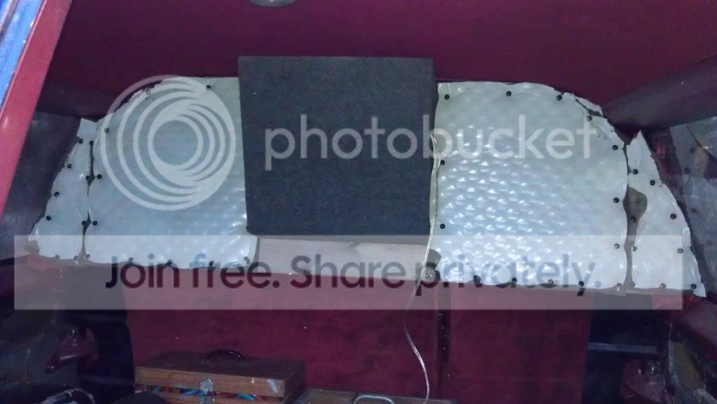

I had my kids this weekend but i managed to squeeze in some work. I put some panel on the cargo fence and installed my subwoofer (infinity Kappa), it was a big boost in bass performance when i put the "wall" in and it is not nearly finnished yet, i shall put some sound dampening material on and some fancy fabric :pimp: .

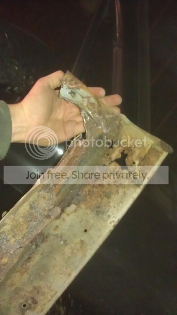

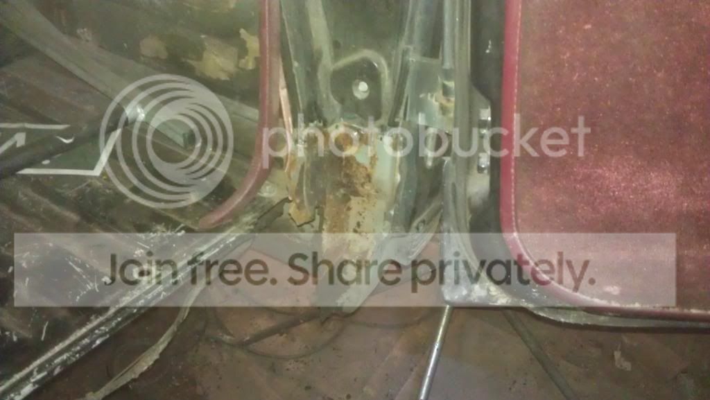

Ok, time for an update. First some pictures of the vertical beam project:

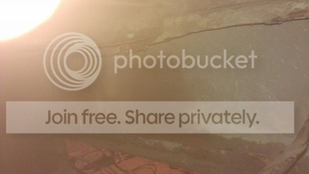

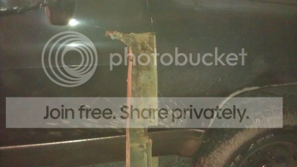

First some cutting... about 1 kg of mud in the fender
Done cutting.
I hate rust

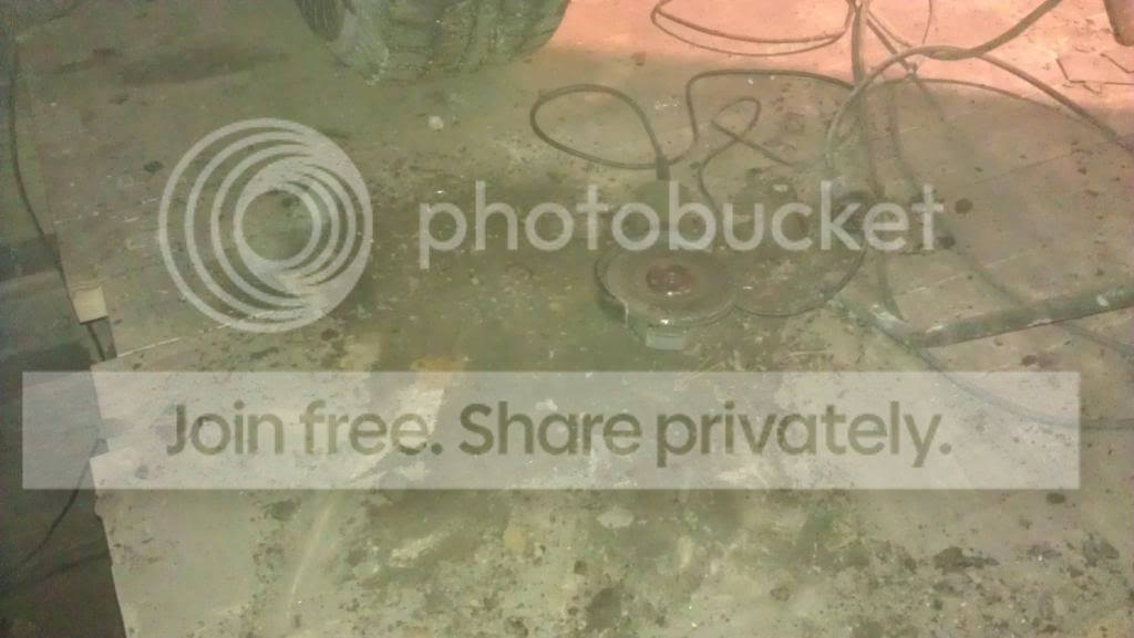

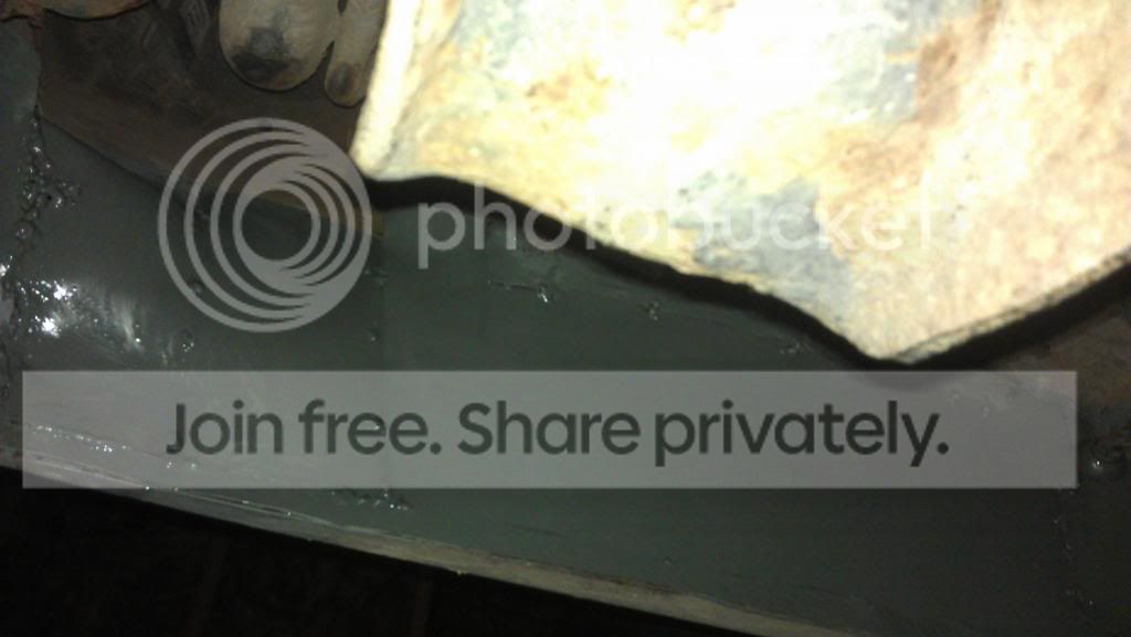

More
Ohh, this is going to be fun.. or not
I took the chance to give the bolts for the fuel tank some needed lubricant to be able to remove it later

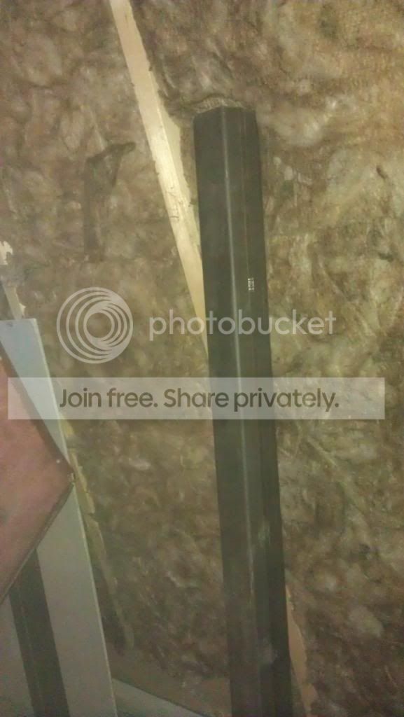

Not anything professional about this patchwork but it sticks togheter
Time for the heavy stuff! welded the ends and threaded holes.

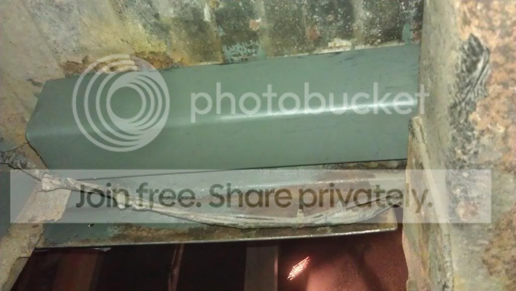

Some paint and hopefully it stands the Swedish climate for a while
Spotwelded it togheter again and put some paint on

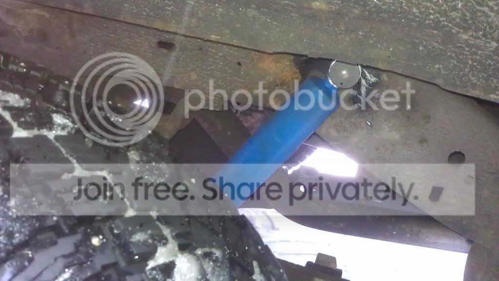

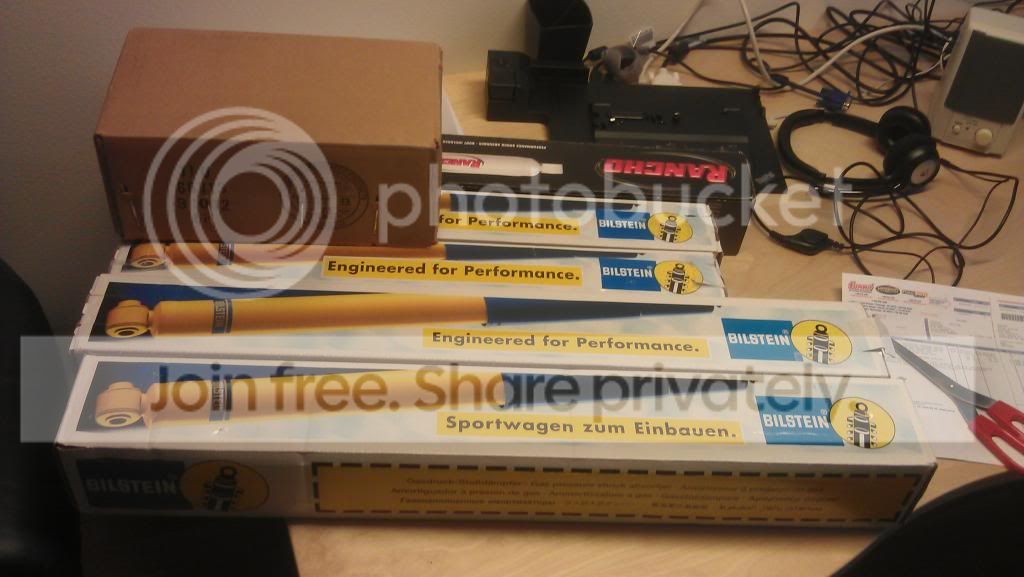

Got some goodies from Summit :D new Bilsteins front and back, new steering damper and new U-bolts for the front axle.
so far i have only fitted the rear ones but i will hopefully fit the rest of the stuff this weekend!

Yes it does, i could'nt really understand the function for the old ones.. i could push them in really easy but it was nearly impossible to get them to retract again?
I need to understand how i should fit the new front shocks, i thought there would be some instructions with the shocks but i could'nt find any. i have dual shocks in front for the moment. Probably i find the info i need on this forum :D

Your old ones were probably dead. I've had old shocks do that. No longer any pressure in them to push the shaft back out.
Did you order regular front shocks? On the dual front shock trucks the "extra" shock is in addition to the normal truck. On the K5 I used to have I just ditched the dual front shocks and ran one shock up front.

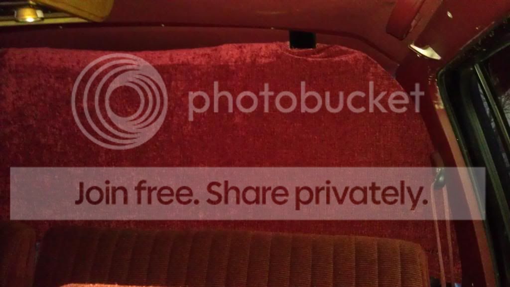

Pictures of the cargo wall
From the back, with sound insulation
From the passenger area, all porn red!
I ordered single Bilsteins for the front but there are duals on the truck now. My concern is in what position i should put the singel Bilsteins the current shocks are fitted in 2 positions with a slight angle compared to eachother.
