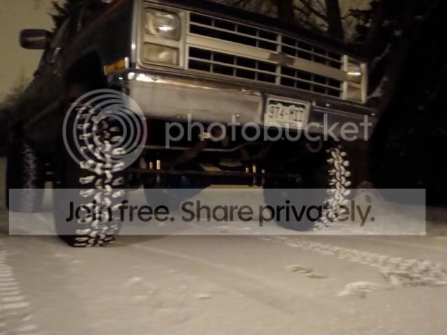

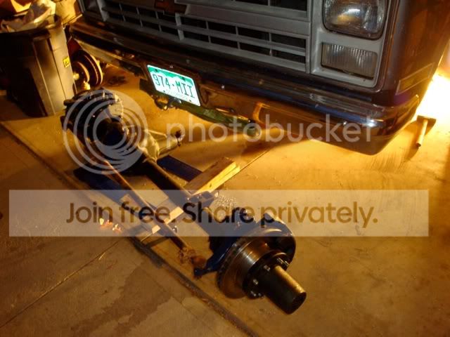

Well, I got the 60 in...

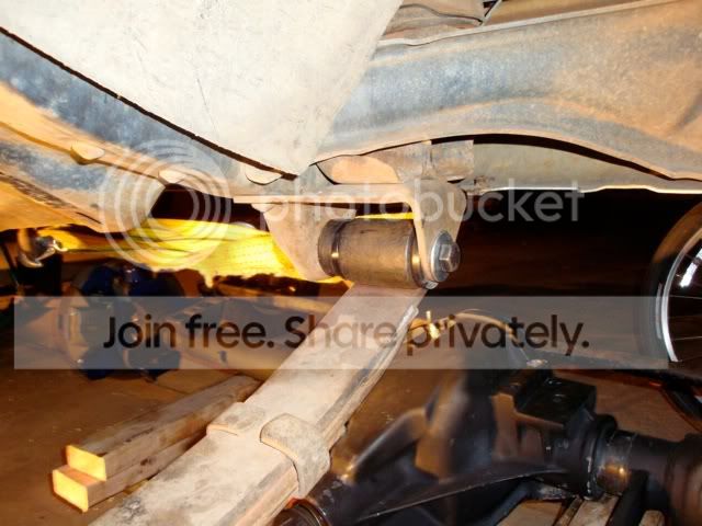

Here's my bushing work getting the spring width right:
Rolling it in:
Voila!
Just a short picture summary I guess... I also got new Rancho RS5000 shocks and reused the Dodge shock mounts. I also had to get a funky u-joint from 1310 external clip to a 1310 internal clip for the Dodge pinion yoke.
Right now there's a bit of a vibration when going in 4wd. As you can see in the completed pic above, it was snowing in my 'hood so I figured it'd be a perfect time to try the 4WD. I think the angle on my shortened front driveshaft may be the problem. It spins easily by hand, but I think it may be binding up under load.

I still got stuff to do... Finish hooking up the air tank, compressor and switches. Also, alignment... which is kinda tough to test in 4 inches of snow.
