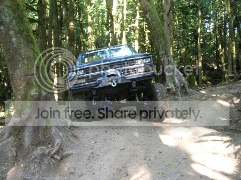

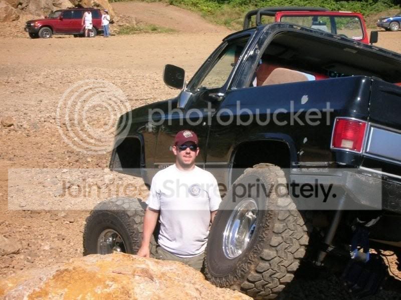

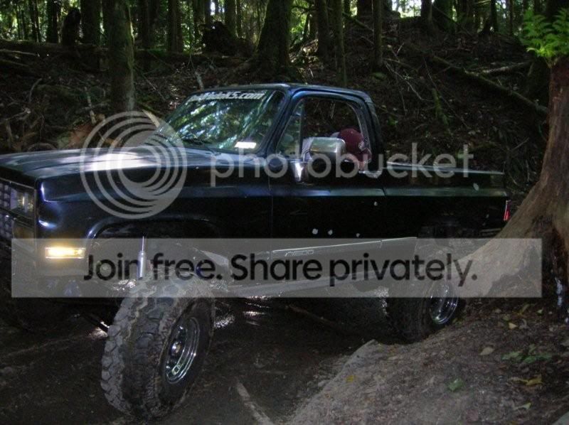

At the trailhead there were a couple big rocks. I figured I would flex on them a little so I could check out any clearance issues before we got started.

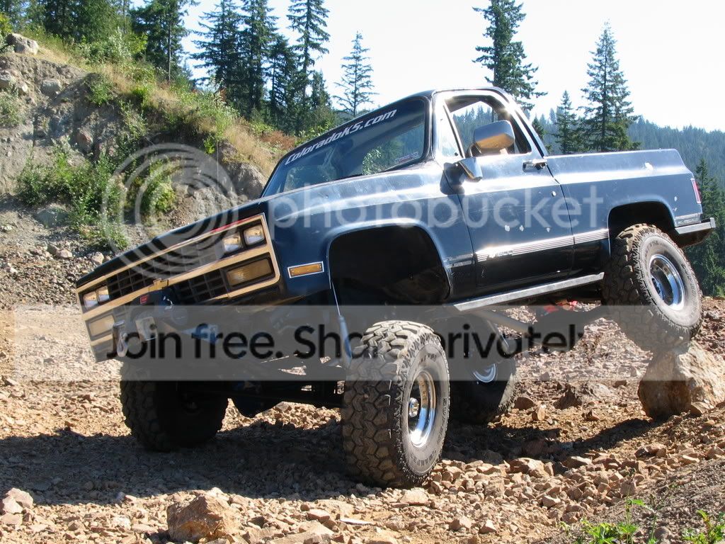

It did pretty good. I need to bumpstop the front to keep the springs off the pitman arm. I guestimated my shock mounts about perfect. Never ran out of shock travel, but the brake lines in the front could be a couple inches longer. Nt sure if it was full drooped but they were almost tight.

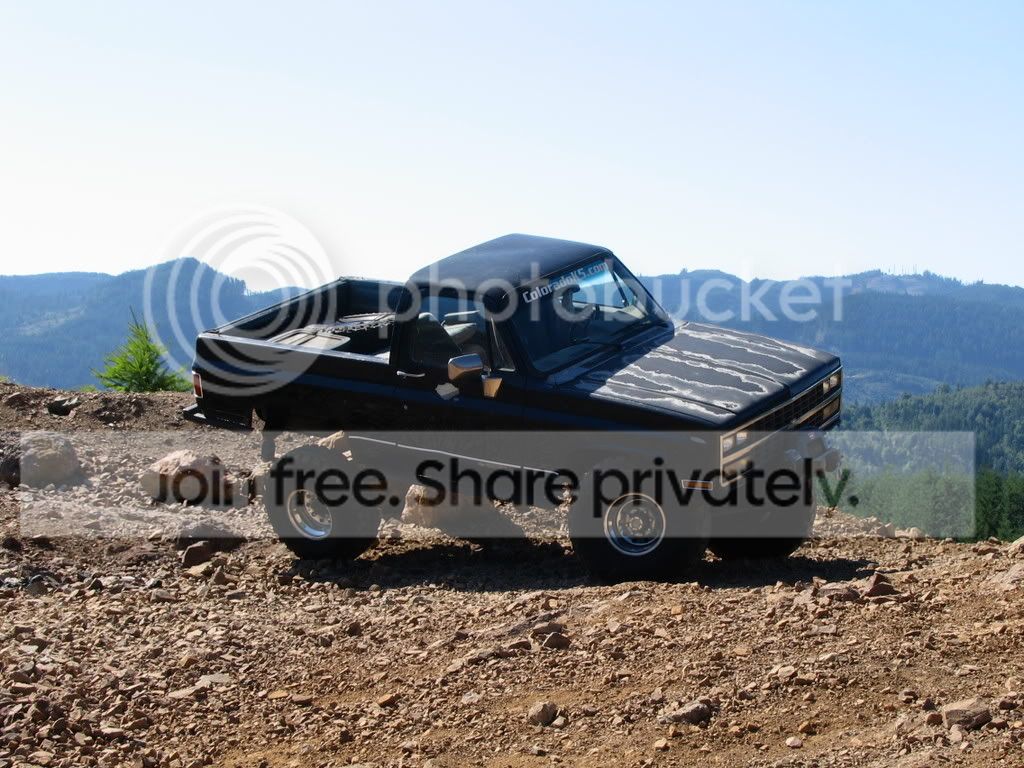

Another little scenic vista to pose for :wink1:

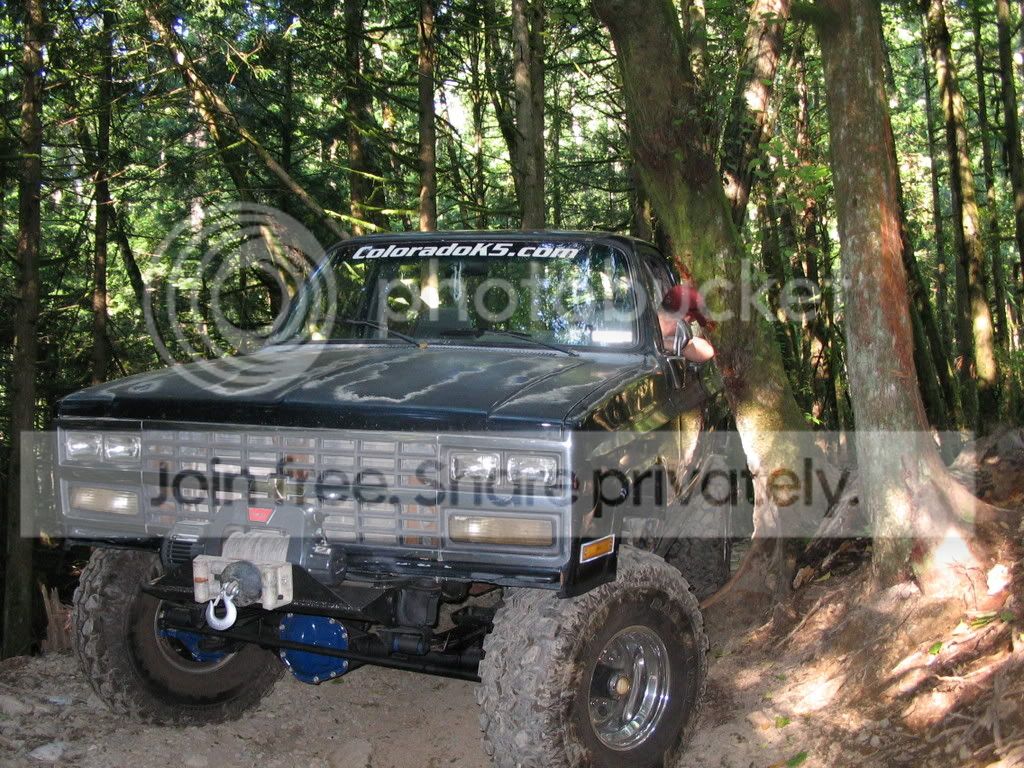

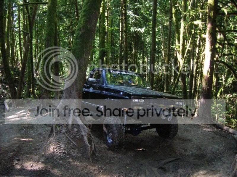

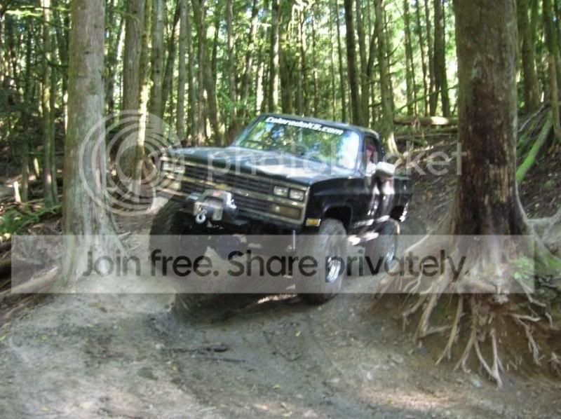

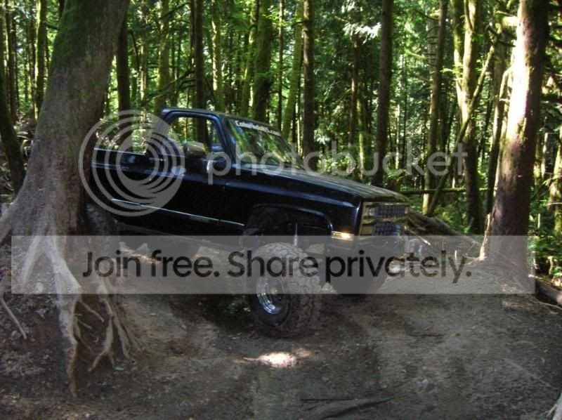

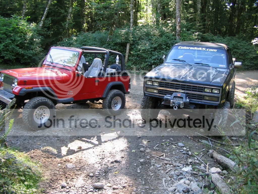

This trail was very tight. My buddy in the red wrangler had to make several two point turns so you can imagine how it was for me.

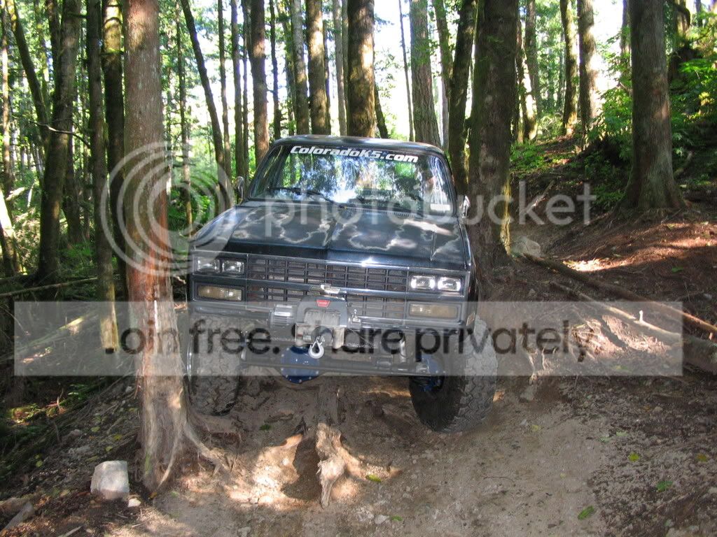

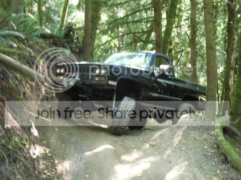

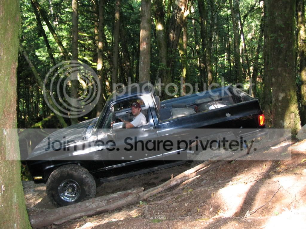

This was a really tight section going up, but I made it without touching. Coming back down I was stuck. Tree on my bedside and tree in my grille. Took like a 23 point turn and stacking a couple rocks and still managed to scrape a tree in a few spots :D
Not too bad though. We'll see what happens when I try and put the top back on.

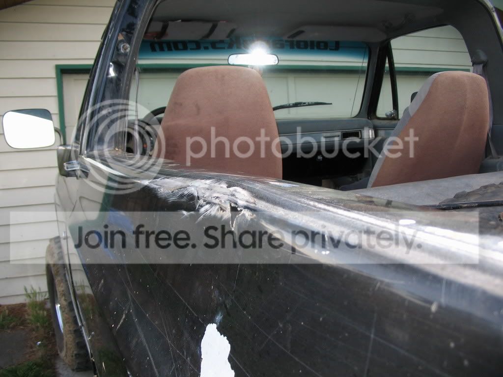

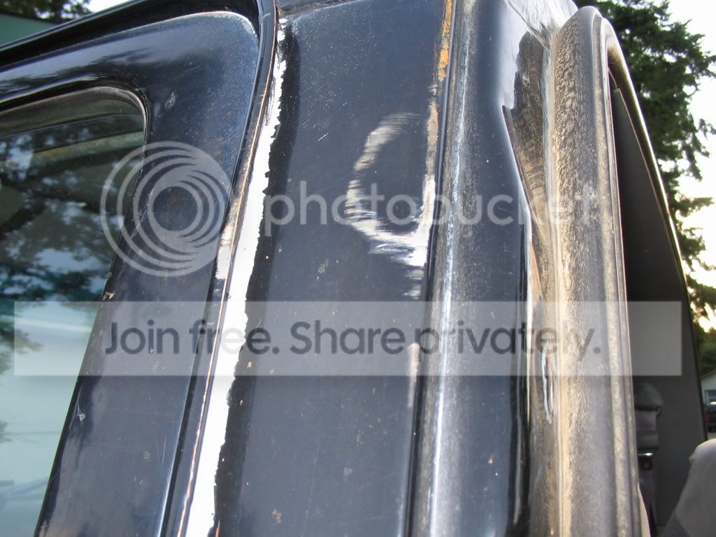

Dinged the cab here.

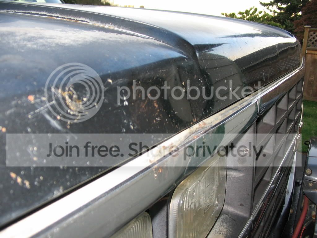

Got the hood when i though I was in R but was in D instead..oops:crazy:
Bedside

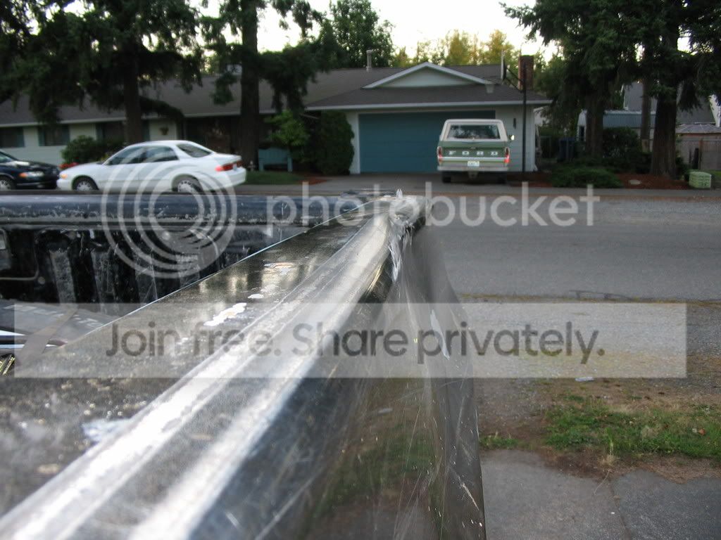

nice lookin truck.
take a 2x4 and put it on top of the raised areas and nit it with a big hammer.work slow and you can get them almost perfect so the top will fit with out stress areas.

You need longer front brake lines..... :D
Yeah they weren't tight, but can't be to careful with that kinda stuff.
Good idea. I'll try that

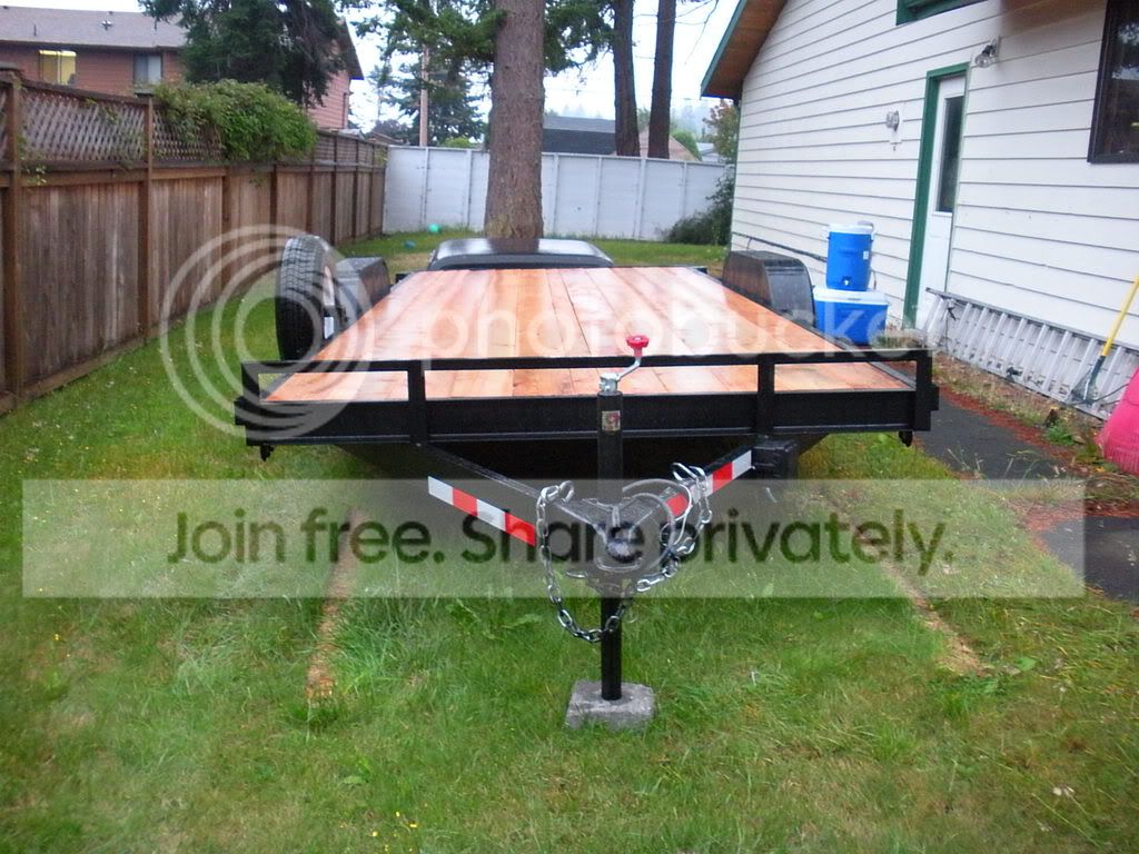

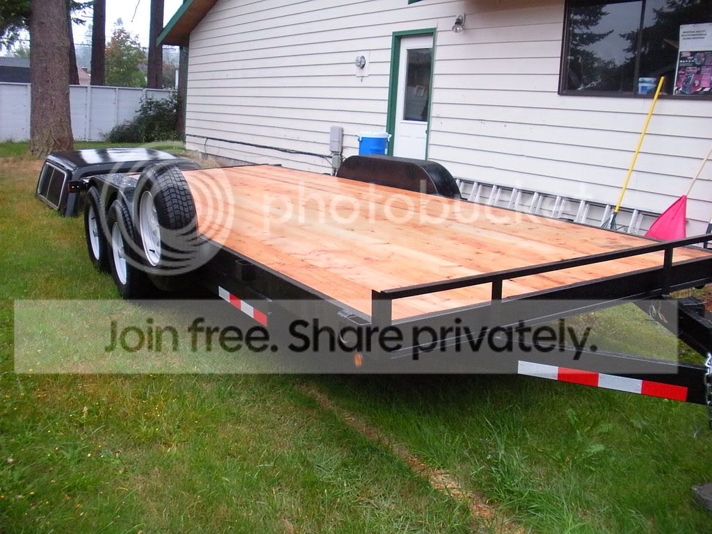

Latest edition is a trailer! 18x7 10k Should be great! Just gotta add a little to the deck where the tires will set and mod the fenders to drive over or make them removable :wink1:
Sure is. Got it for $2850 direct from the manufacturer here. Its pretty much identical to a Great Northern brand.
$2850 is a great deal for that kid of setup. It appears to have some electric brakes as well. Nice.:wink1: Now if you could hook a brotha up on some cheap shipping and another deal like that...:bow:
Yeah it's got electric brakes on both axles, and it also came with the spare tire. Its a pretty nice trailer and should work good for me.
Yeah I think shipping would kill the deal:haha:
