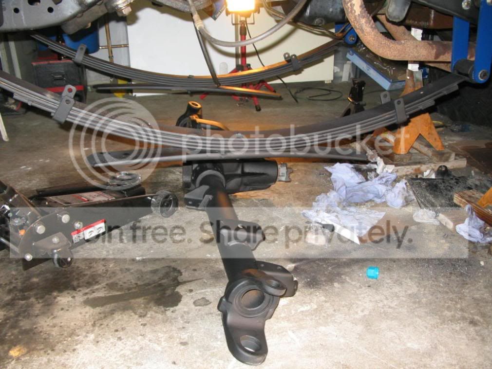

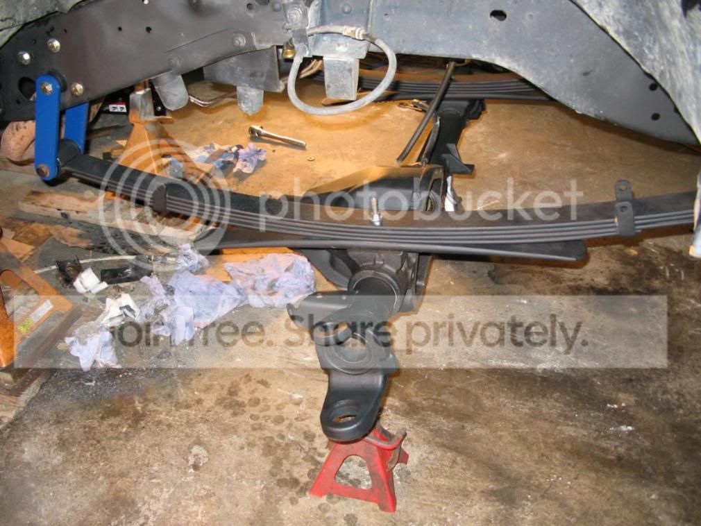

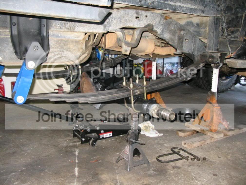

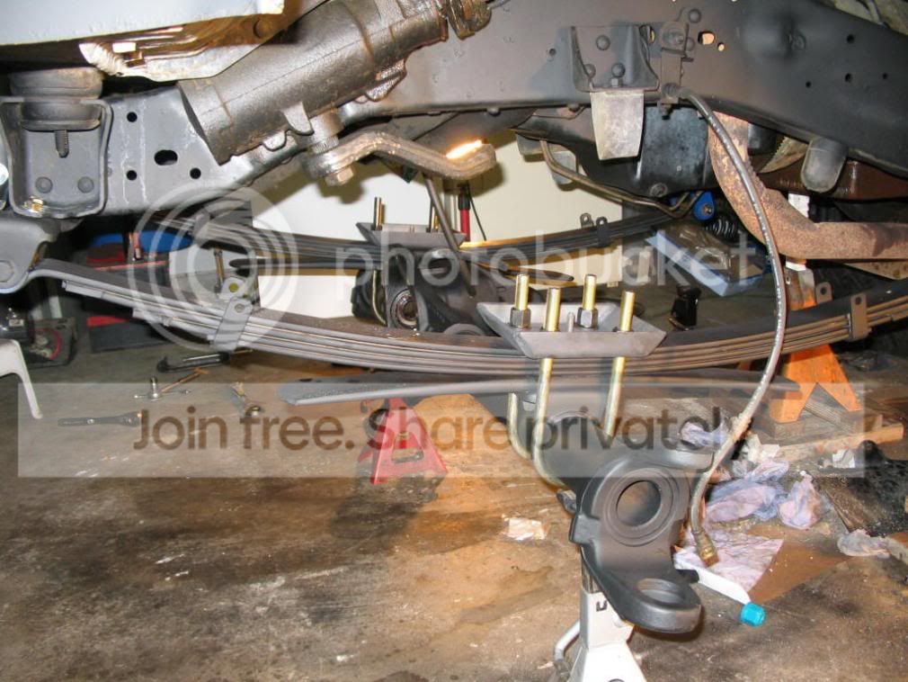

Sliding the 60 under the springs.

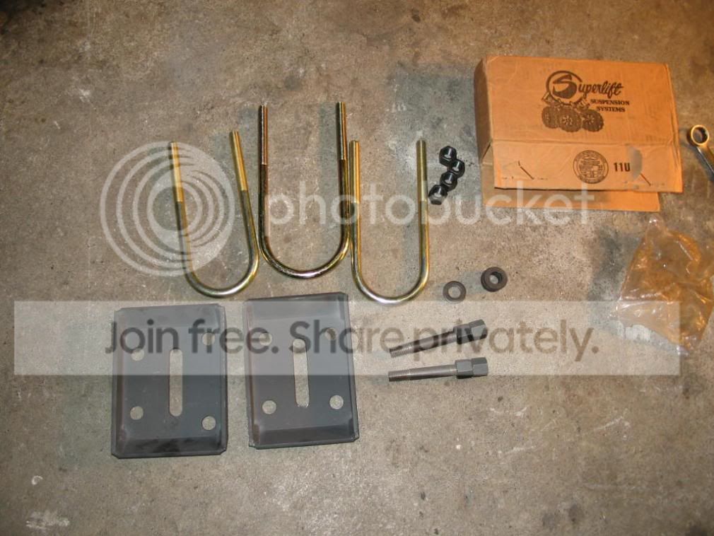

Superlift U-bolt kit and Kerts spring plates.
Ahh looks good now we are getting somewhere.

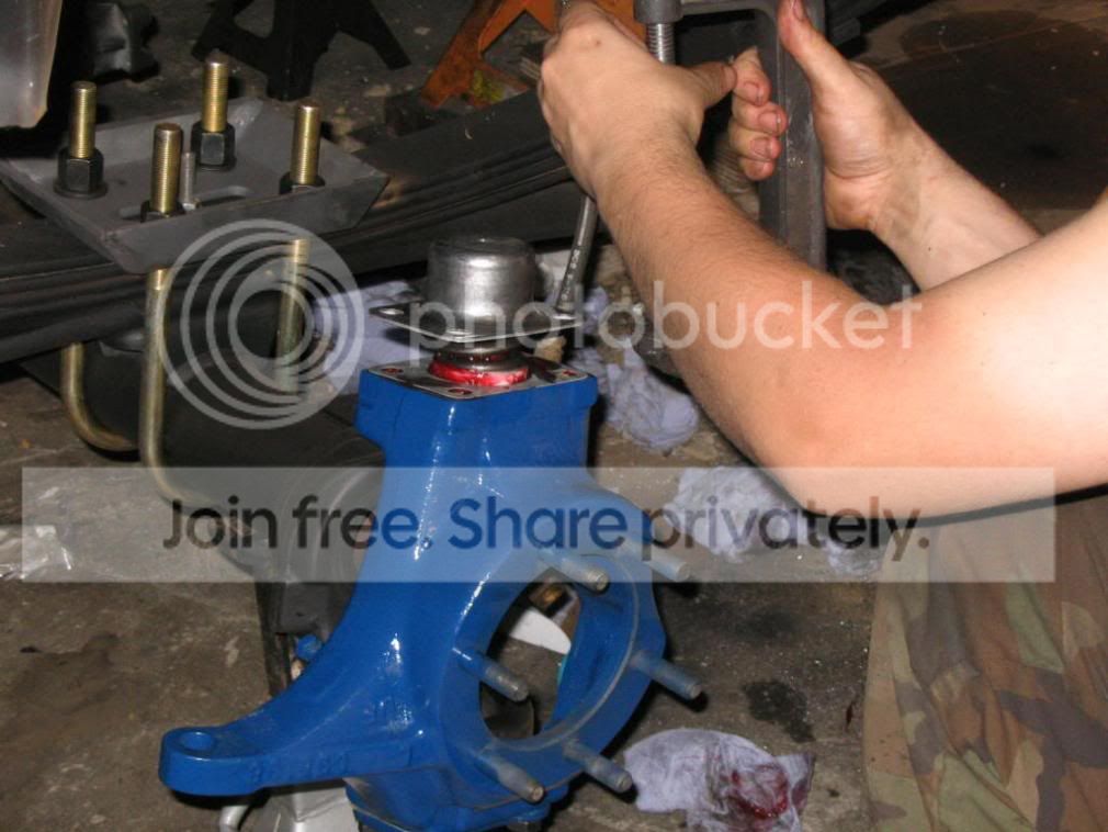

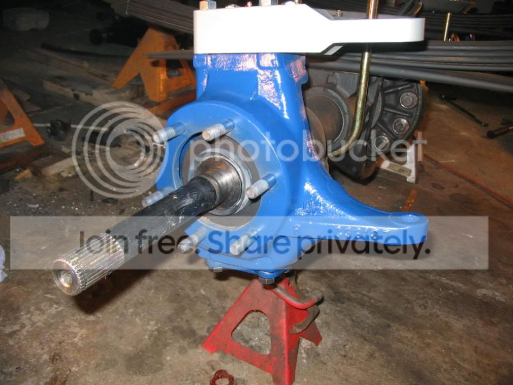

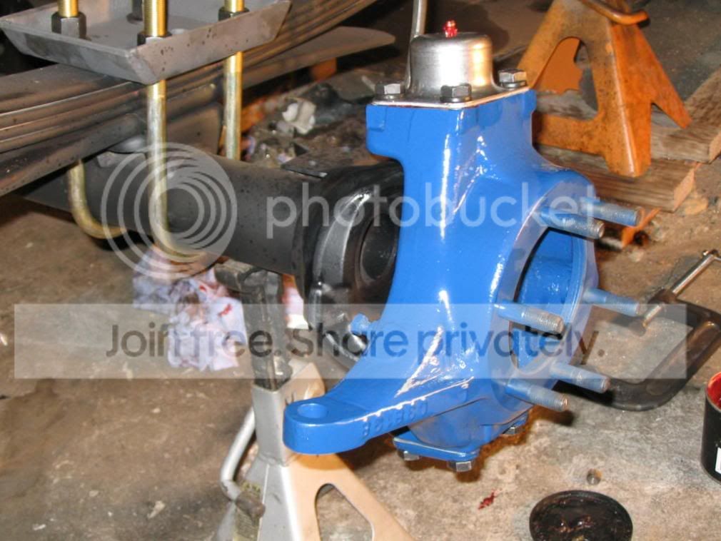

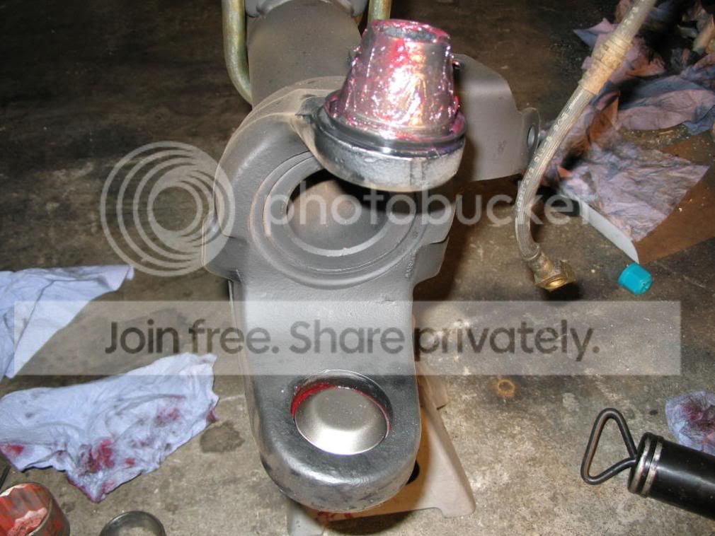

New Kingpins and lower bearing/race installed.
Nice clean knuckles.
Both sides on and Beefy Sky steering arm installed on the pass side.

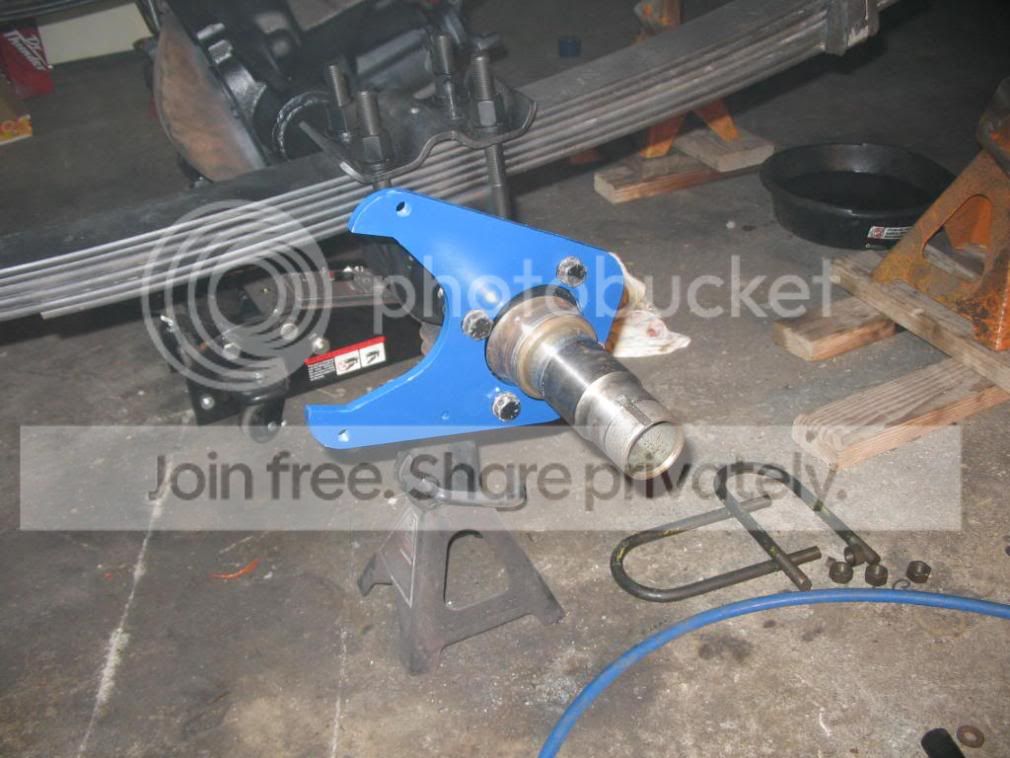

Spindle installed with caliper bracket.

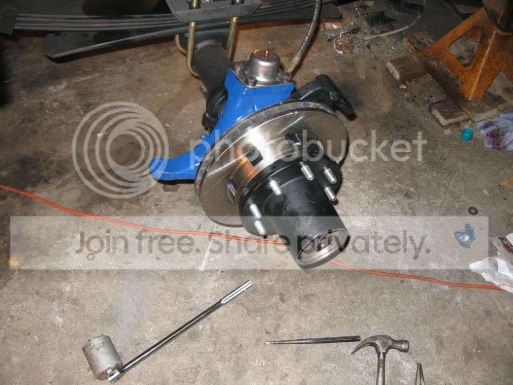

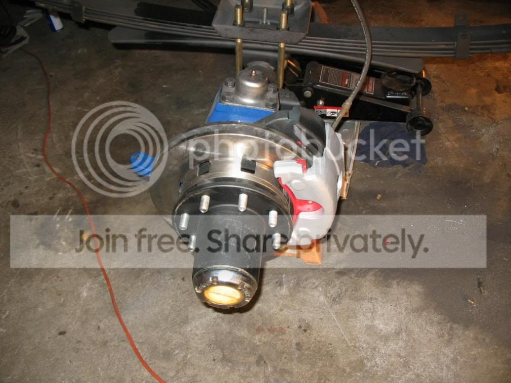

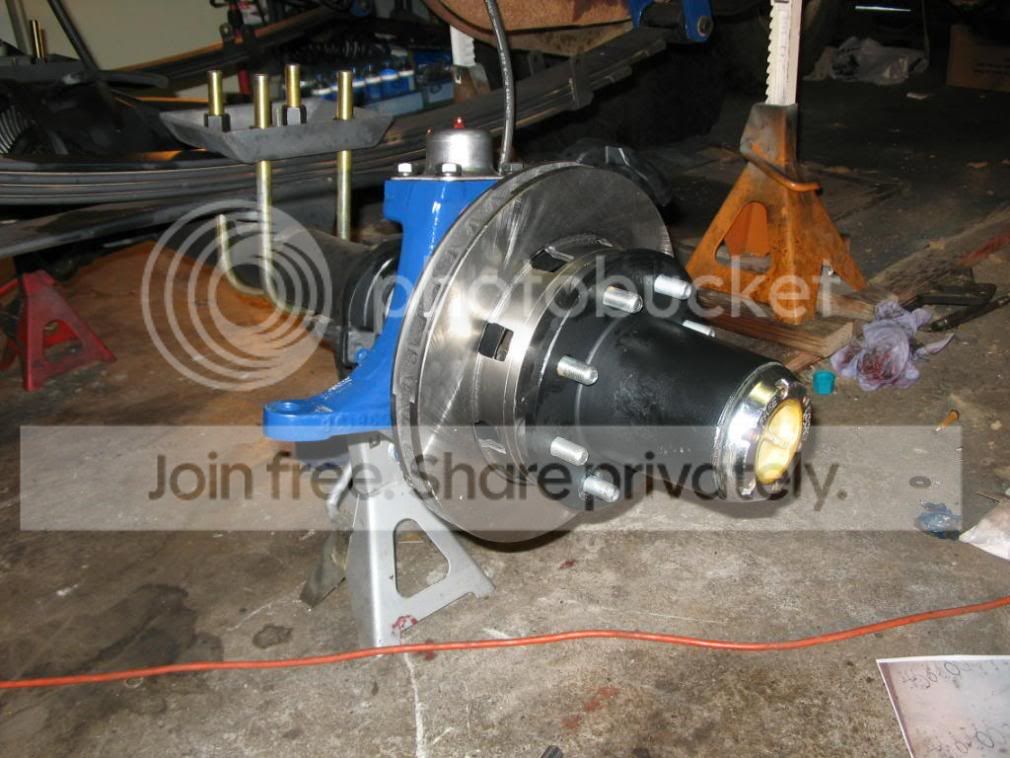

Hubs and rotors on and bearing preload set. New inner and outer bearings and new rotors and wheel studs.
Finishing up with the Spicer hubs. These could use new dials, but work fine the way they are.

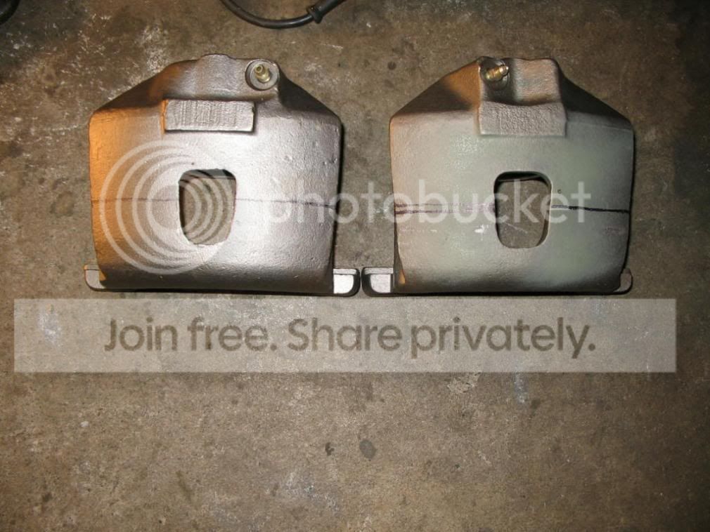

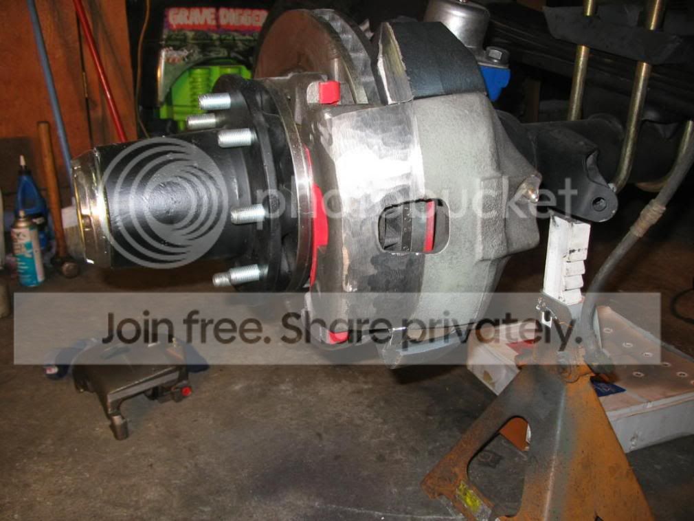

On to the brakes. I am not gonna get into detail since there is a tech article on the home page of CK5. I had to grind of course for my 15" wheels. I will tell you it wasn't fun, and will rpobably buy bigger wheels when I get new tires as I really don't want to do it all again when the calipers need to be replaced:wink1:
I just estimated by looking at the calipers on my V3500 and made a line grind from.
Some time a few beers and a couple grinding wheels later....
It took a few rounds of test fitting the tire and taking down high spots, but you get the point.

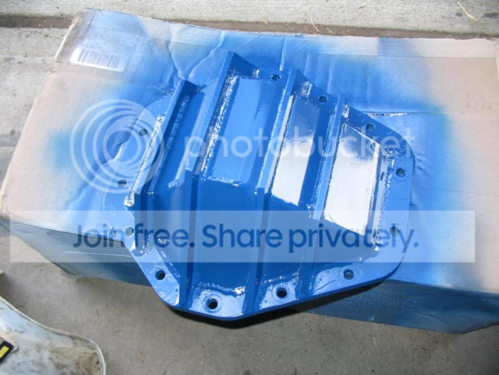

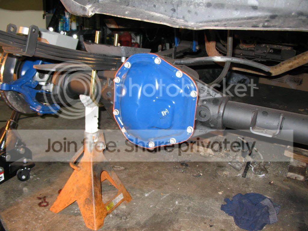

Got the carrier installed and caps torqued. Threw on some ultra copper RTV and shiny blue cover. (soon to be replaced with a Razrback) and called it done! :D

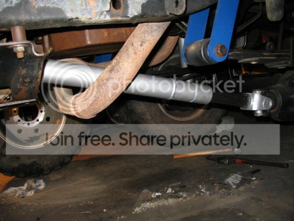

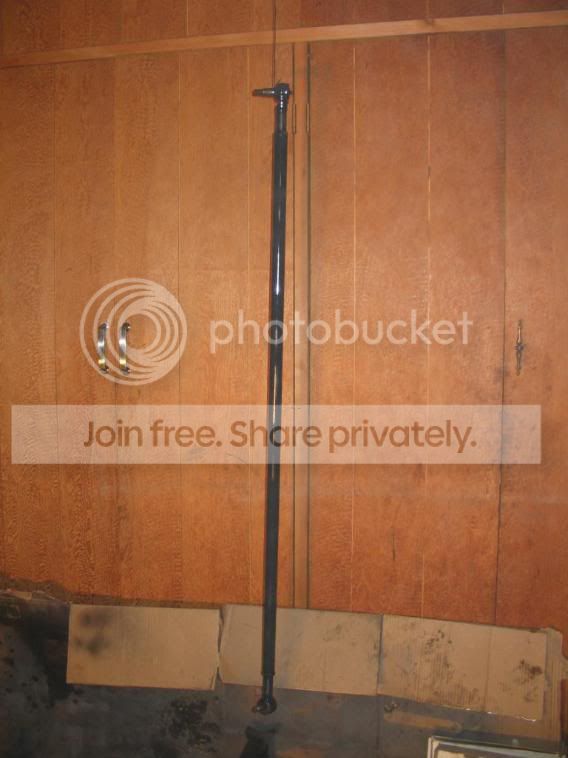

I did some measuring and I was able to use my Sky draglink and tie rod from my 10b. I did have to trim them a little and trim the TRE about an inch, but they are almost all the way threaded in so strength should be fine. Set the toe in to about 1/8 and called it good.
Painted up D/L and Rock Rod

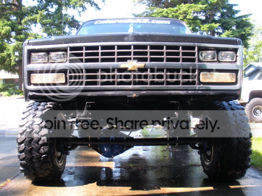

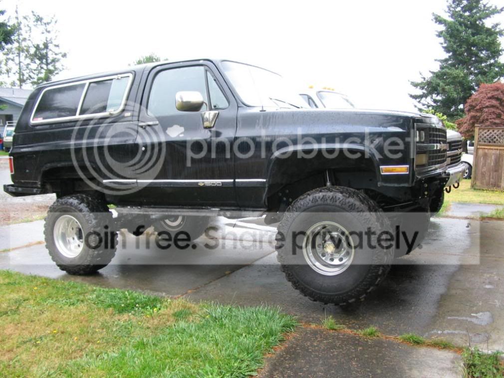

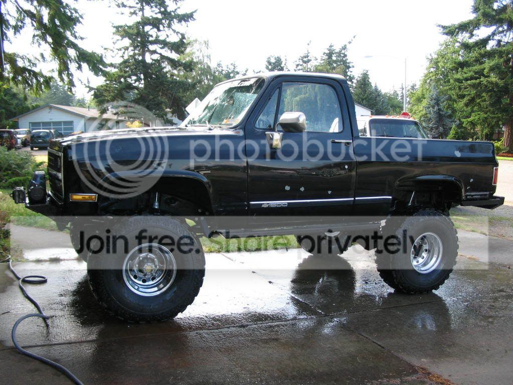

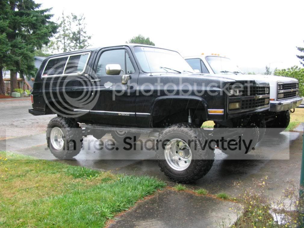

Pulled it out of the garage and hosed all the dust and crap off of it from being in the garage for so long.

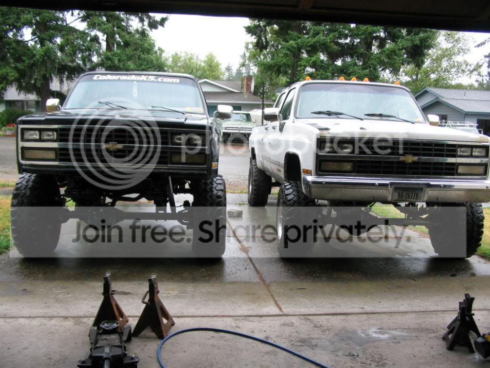

Next to my crew cab:wink1:
Ended up sitting a little low in the front so I did throw some zero rates in to level it out. Didn't take any pics though. Prettt yaight forward. Did have to replace the studs on the pass side diff with some lger grade bolts though after the zero rates.

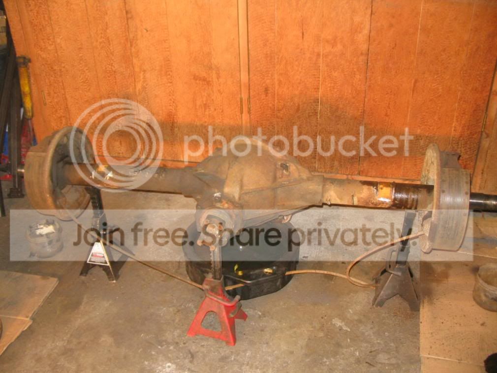

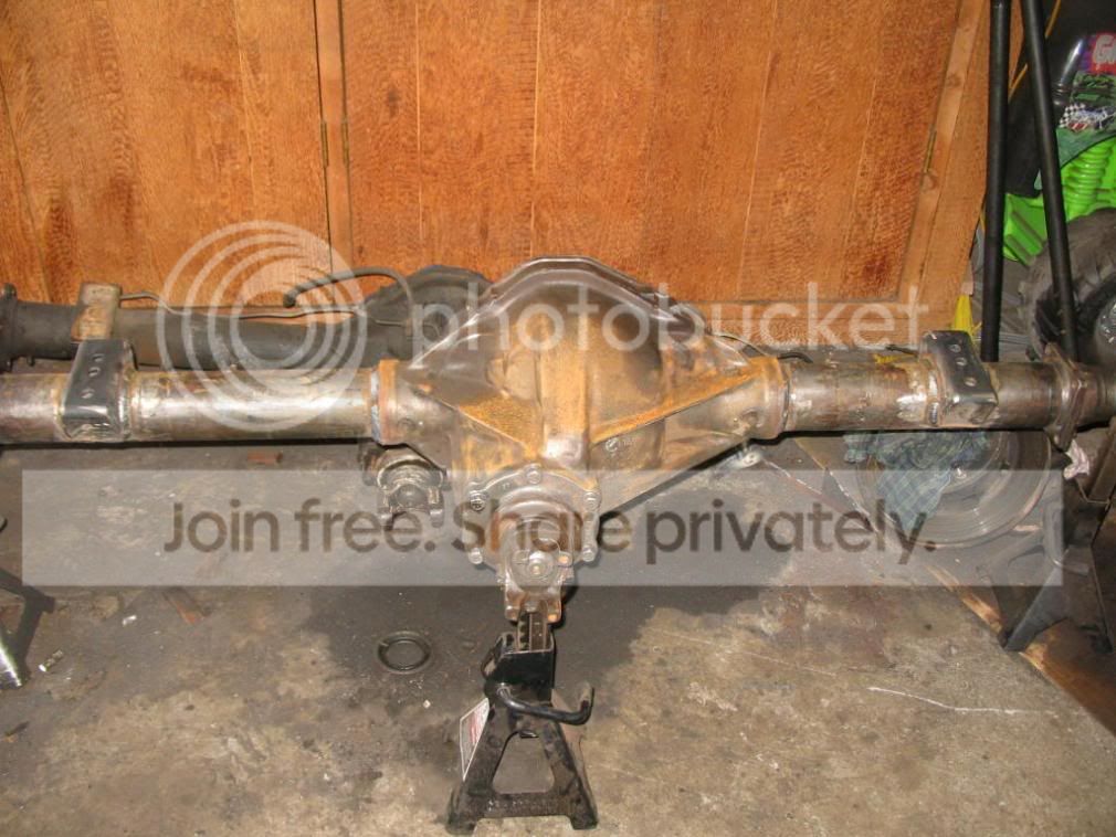

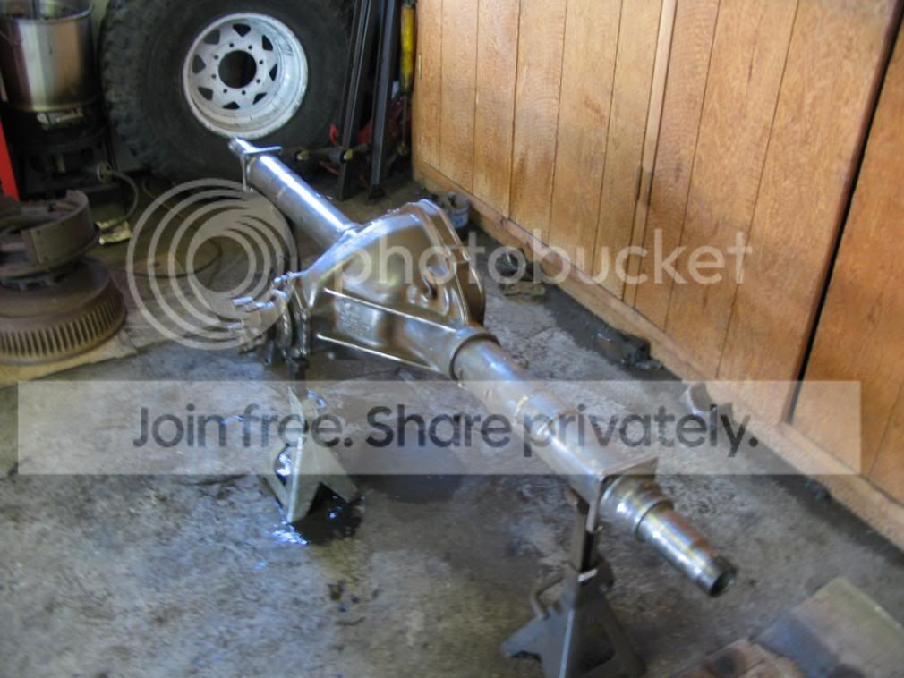

I got this 14B from kennyW to match my 4.56 front. Its from an 84ish CUCV so a Detroit is inside :D

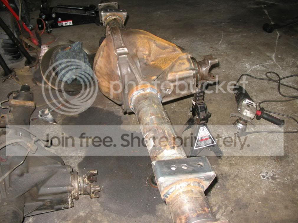

Drums off. Axle is in good shape internally. Just been sitting in the elements for awhile. Nothing a little wire wheel and some elbow grease won't fix.
Cleaned up a bit and perches and shock mounts removed.

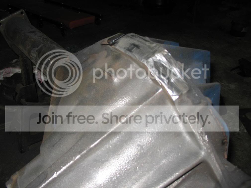

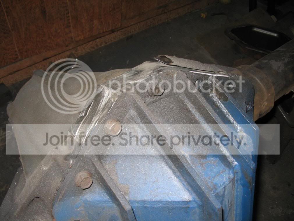

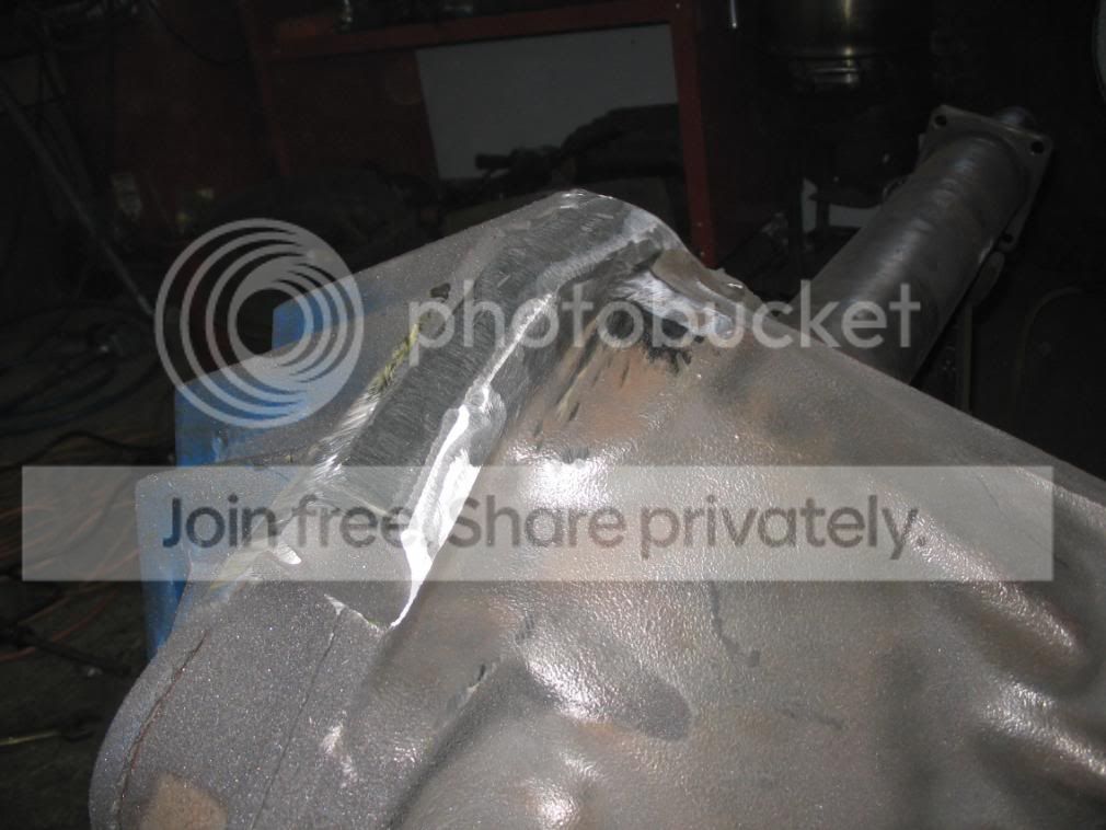

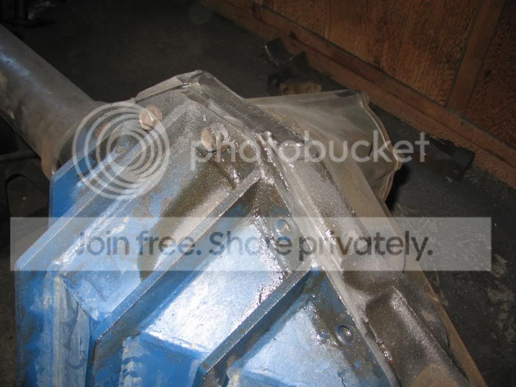

Shaved to match the DIY cover.
I know i could have taken it down a little farther, but I just rounded the edge so it doesn't catch and called it good.

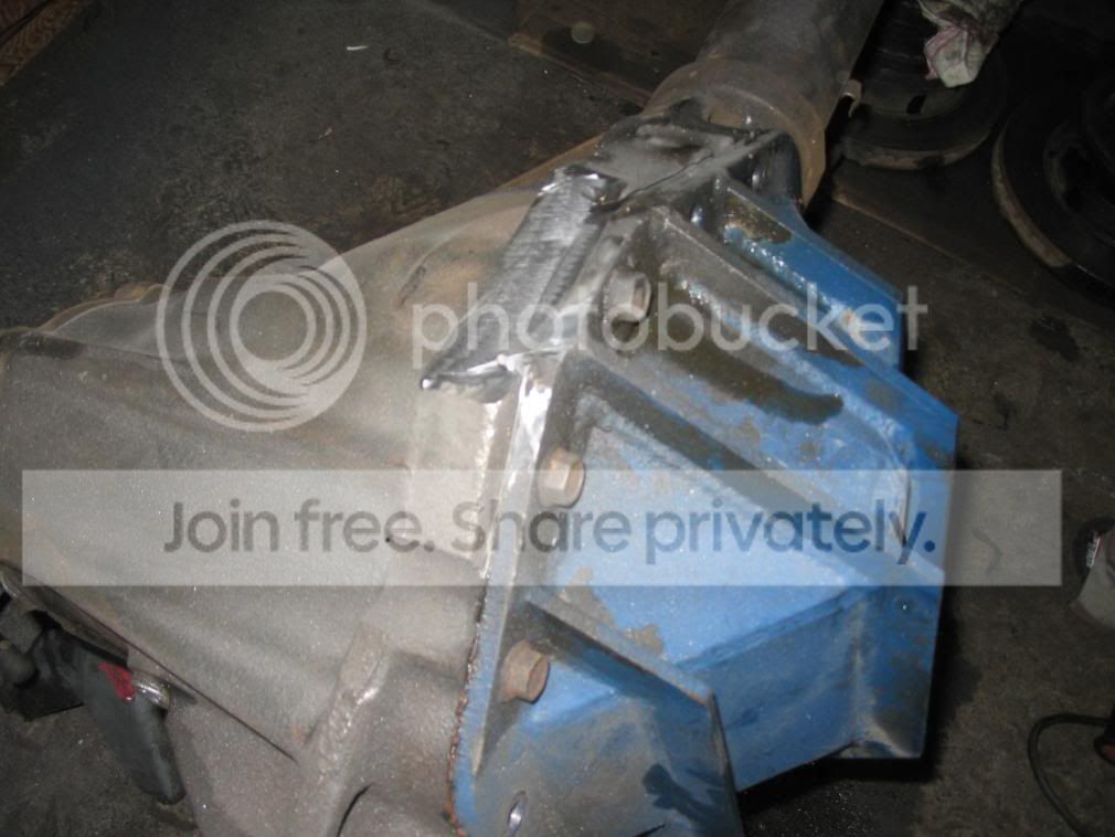

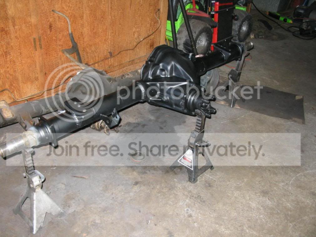

Got the pinion angle set and tacked on new perches. Then pulled the axle again and welded them up all the way along with fully welding the tubes to the diff.

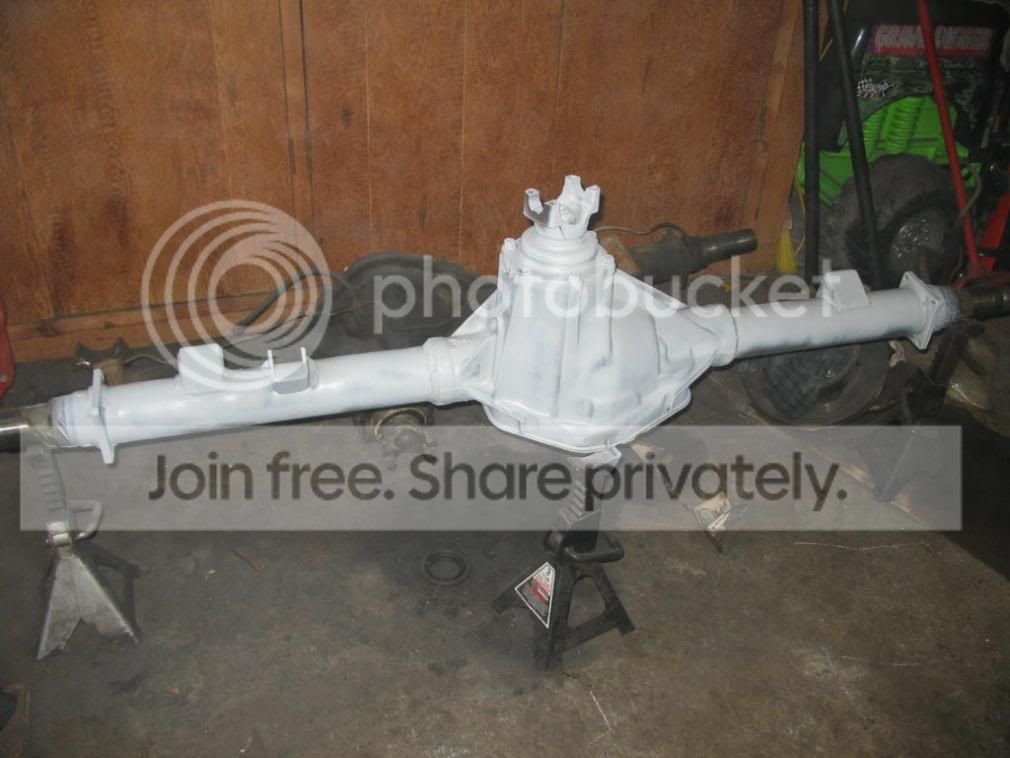

Got it all rust free again then shot some primer and some new flat black paint.
Razrback cover all cleaned and painted :D

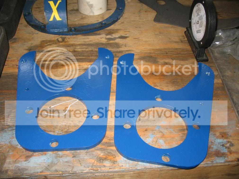

Az-Kickin Off road disc brackets all cleaned up and painted.

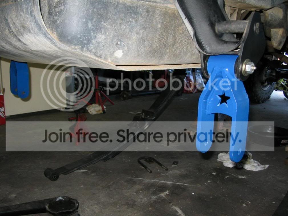

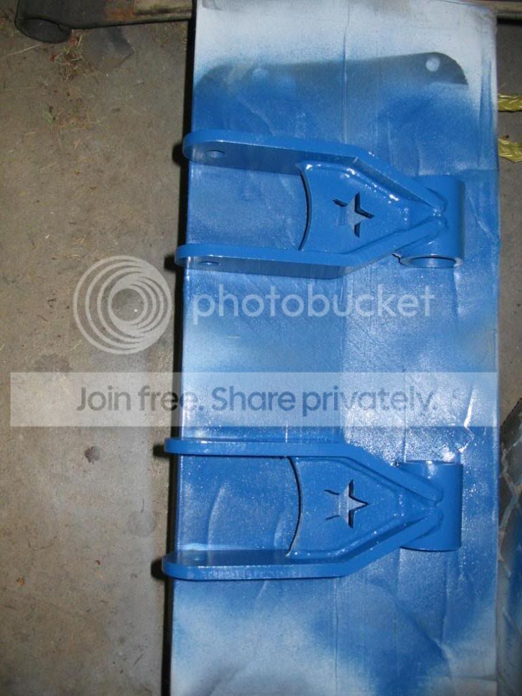

Shackles painted

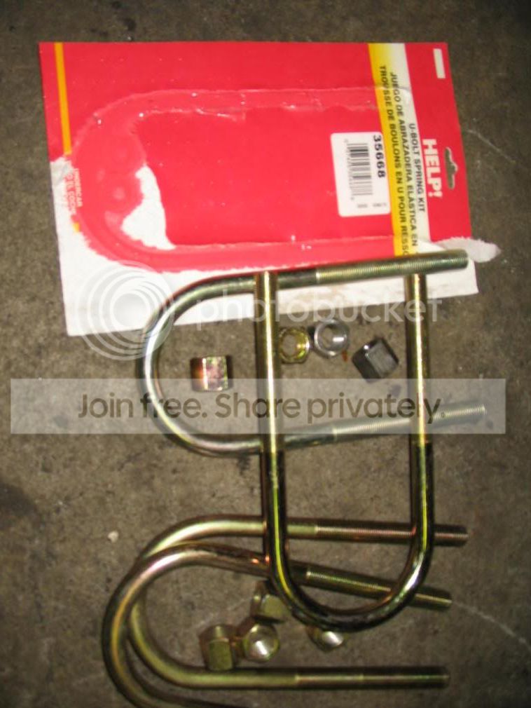

Got some U-bolts at Parts Plus in town here. $9.99 each so not too bad. Many different lengths available.

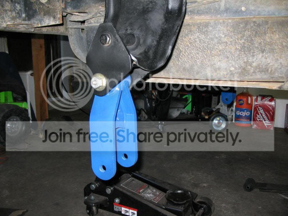

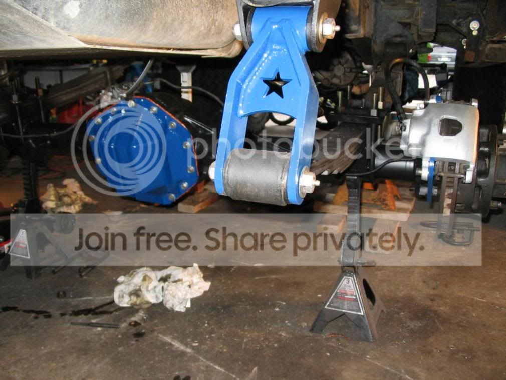

Shackles hung with greasable bolts and poly bushings.

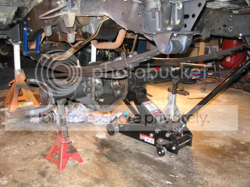

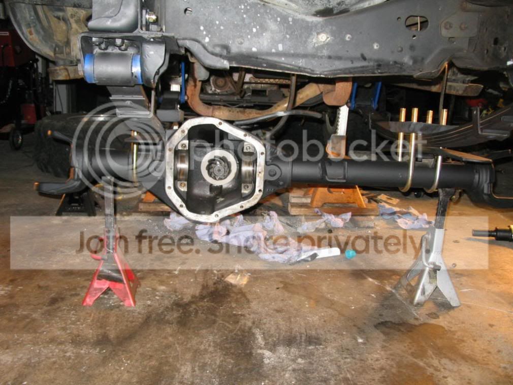

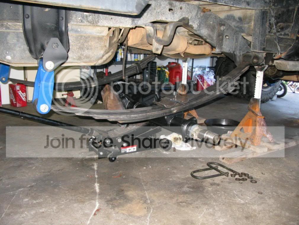

Rollin the 14 bolt under the springs.
Most of the vehicle weight sitting on the springs. Shackle angle isn't too bad.

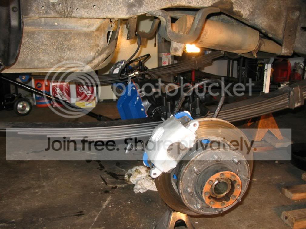

Brake brackets bolted on.

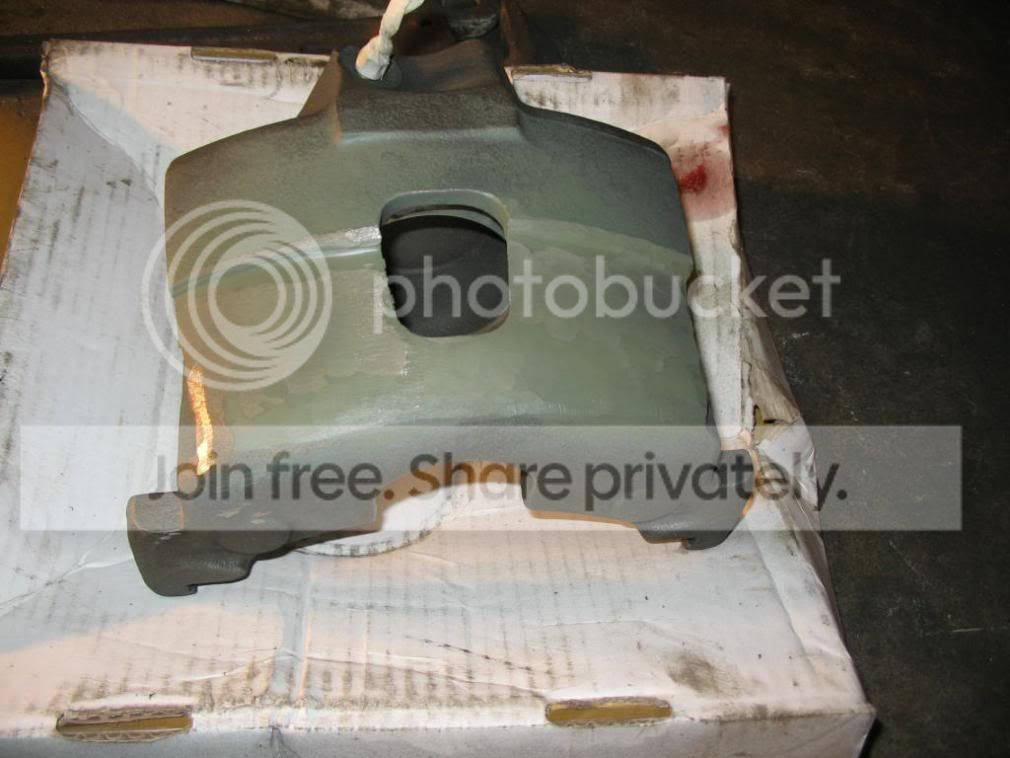

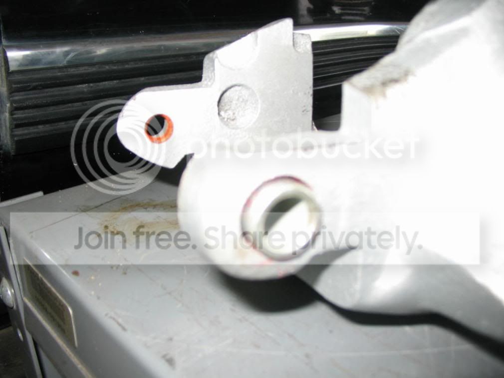

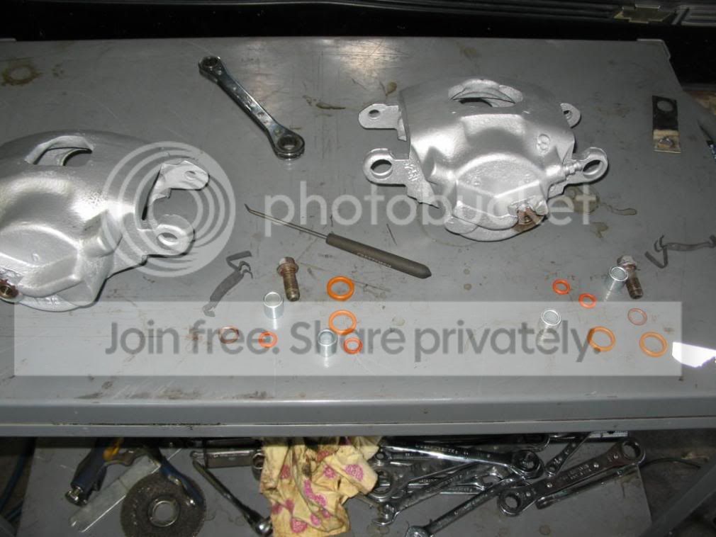

My rear calipers have been on for awhile and I noticed the busings and small rubber seals were pretty sorry looking. I dug in the catalog at napa and found the rebuilt kits.

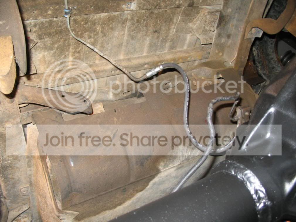

Got the brake lines on and calipers hooked up.
I installed the longer Napa line from the parts numbers thread, but it still seemed short. I pulled the hard line off the frame and bent it out over the axle. Secured it with an clamp and bent it down some. Now I should have plenty of length.
Cover on and sealed up.

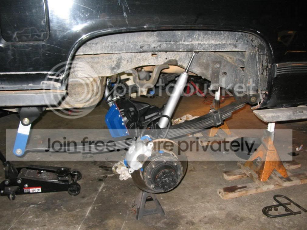

Now I know my shocks are too long in the rear, but ti will work for now. I have about 5" of uptravel before i run out of shock. I'll have to flex it too see what my springs look like in that area. Later on I plan on running the shocks up through the floor to a tower. I don't want to inboard them as this thing rolls enough as it is and that won't help any.
Got my shocks on

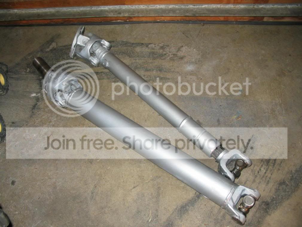

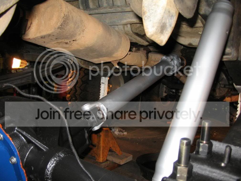

Got the driveshafts cleaned up with new joints and paint.
Installed
Moved my T-case back up to the frame and my angles are perfect. Pinion is about 1.5* down from the shaft. Hopefully no more vibes :D

Very cool build, great job so far! If you haven't done so already, I suggest drilling some drain holes in those DIY spring plates. How's your front shackle angle? Just wondering cause I moved my shackle hanger the exact same way as you and wanted to compare. Keep up the good work
It turned out pretty good. About 40 degrees or so. I'll see if I have a pic tomorrow.
Man took me awhile to get back. Sorry guys. :wink1:
Here is my front shackle angle.

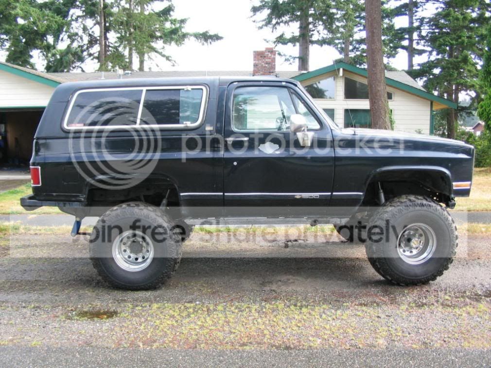

And after that it moves :D:D:D
Times to get those tires swapped over.

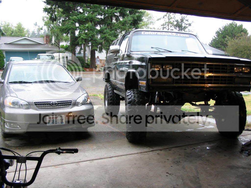

Looks good in the driveway parked next to the Corolla :D

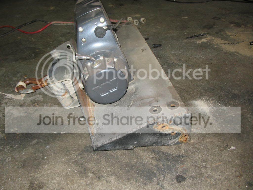

Now to get my winch back on. I knew the mount wouldn't fit after the 52's so I had to trim the sides of the winch box.
Old dirty rusty thing..
Winch Removed
Cleaned painted and sides trimmed. i lost a mount hole on each side, but that still leaves one bolt on each side and two on top for each side. so still plenty secure.
Got it mounted up
Got the winch back on and bolted down. :D

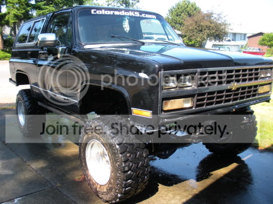

The other day was nice out and I had my little helper keeping an eye on me.:wink1:

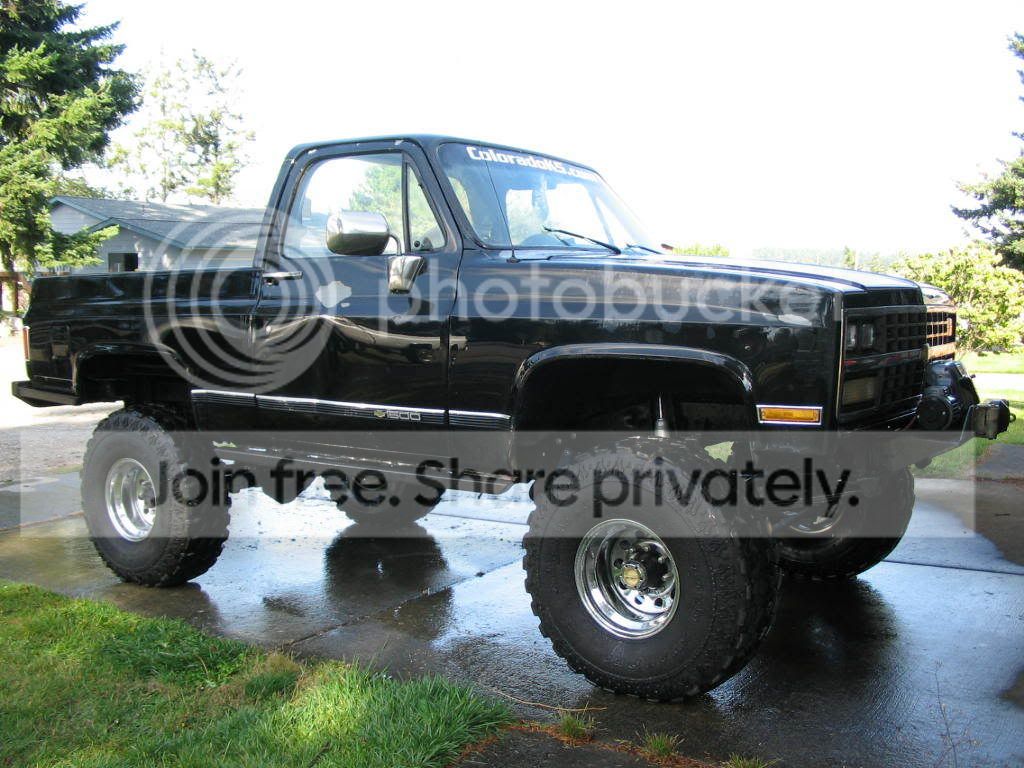

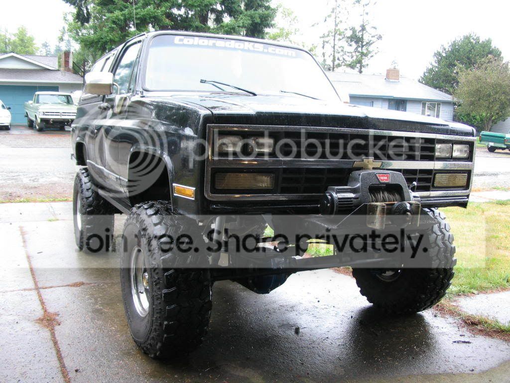

Weather is gonna get crappy here soon so I figure I better go topless while I can.
That brings us to now. I have driven it back and forth to work a couple times. I havent had a chance to move the suspension much, but it feels soft. Could probably use some better shocks, but these will work for now. Traction bar is definetly coming soon. It hops really bad at least when i did a burn out on wet pavement:D
Gonna go out tomorrow and try some light stuff with a buddy that just lifted his Heep. Will post pics from the trip:D
