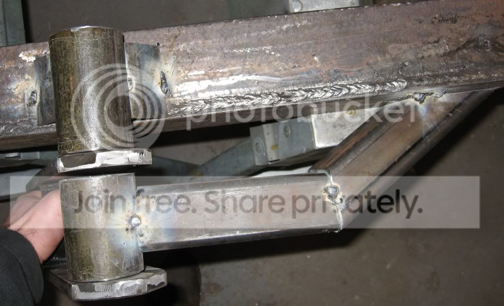

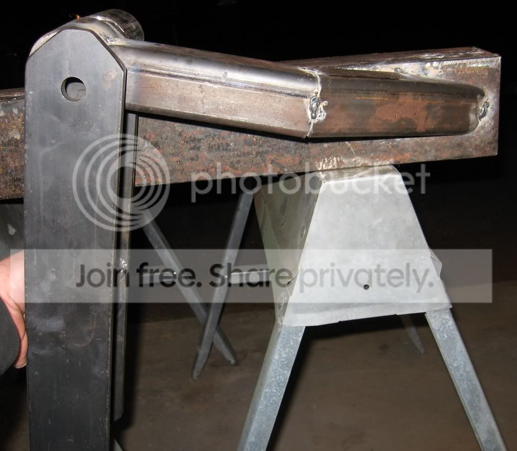

Expirimenting with 3/4Blazer's drawing a few posts back I came up with this today. The rear springs seemed like they had a lot more flex in them so why not?
I will weld a 3/4" X 10" Bolt to the top shackle which will pivot inside bushings in the tubes. The x-member will go between the framerails. The piece of tube closest to the shackle will be welded to the top of the frame rail. To get the angle correct I am going to move the forward rear hanger rearward and up the framerail about 6". All together this should widen my wheelbase and drop the bastard a few inches.

See what you can do to support that outside shacklebolt while you're experimenting on that rear shackle setup.
What you have pictured is only a single-shear connection and may not survive long with the forces it's likely to see. If you can get the crossmember/mount to hold the shackle from both sides, it will be a double-shear connection and will have substantially better strength and durability.
