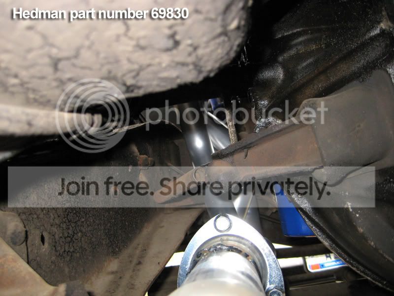

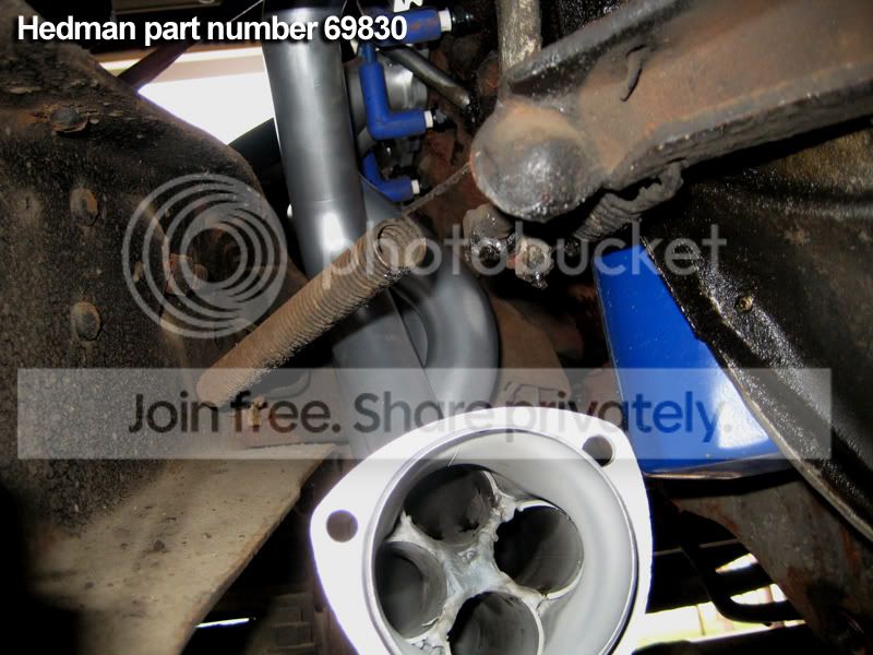

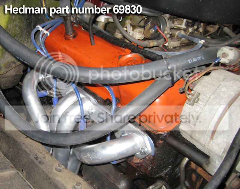

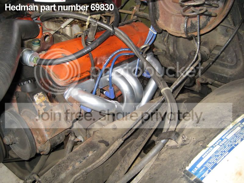

Installed my 69830s just now.
They went on great. Passenger side went on without any trouble. Driver's side I had to loosen the starter to get it in. No big deal. It took me about 2 hours to do the whole job.

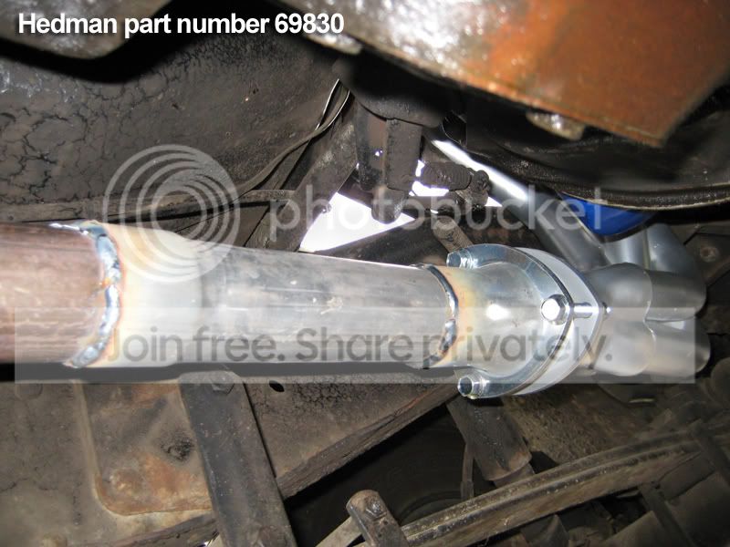

There's quite a gap when it comes to mating up with the rest if the exhaust. The old headers reached back further. I expected this.

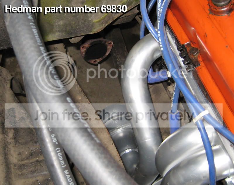

This one's for you Glenn, clutch clearance. Plenty of it. Nothing to worry about. Got like 5-6 inches of breathing room.

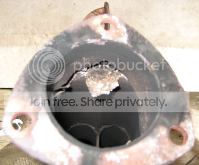

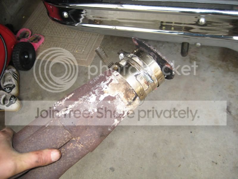

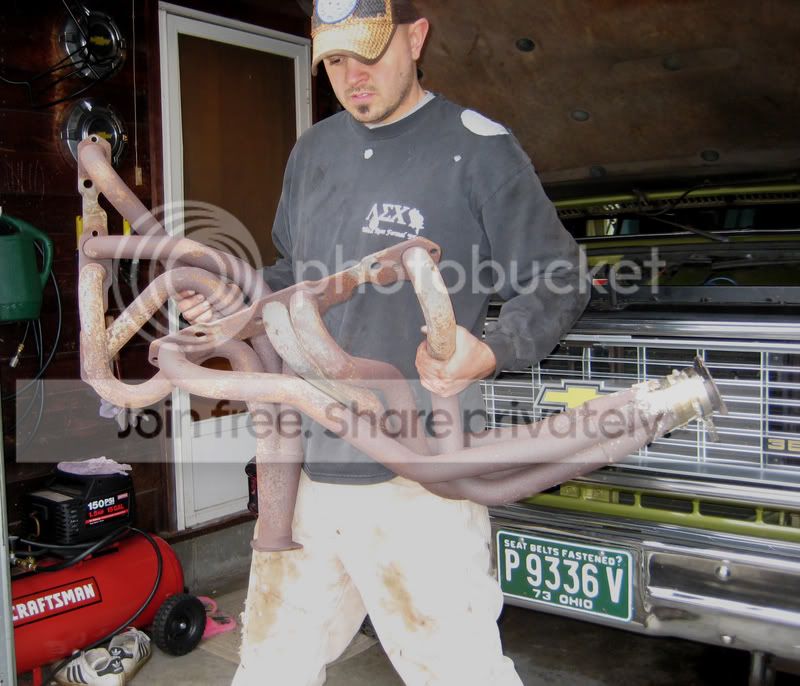

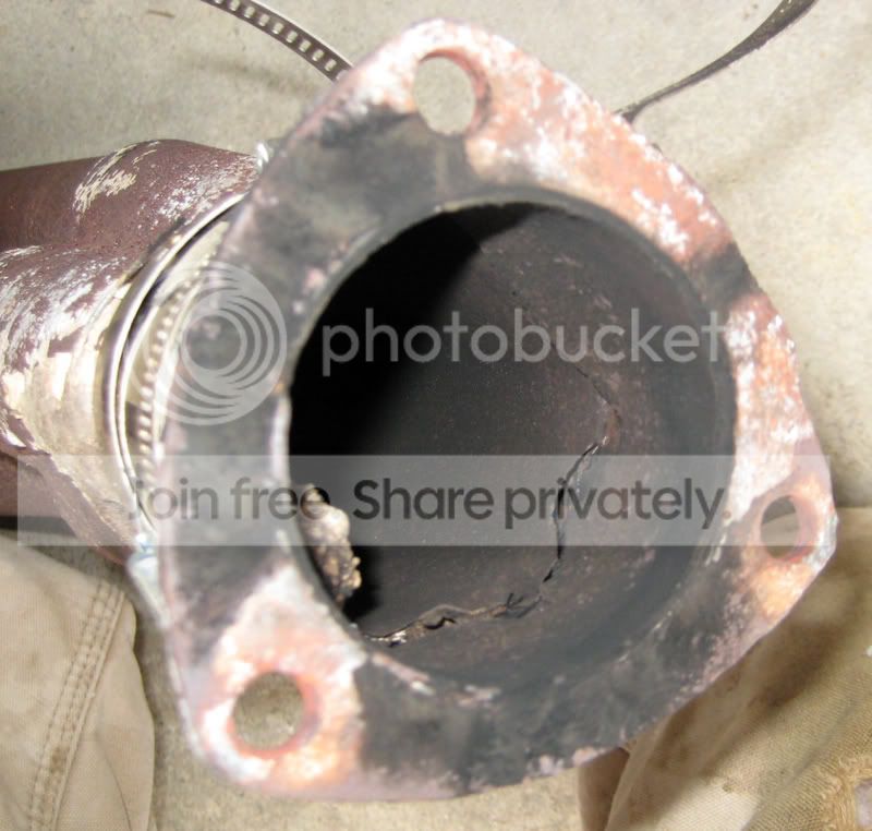

Old headers. They were installed on my Blazer in '77.
Here's why I replaced them. You can see my beautiful patch job from last summer.
That white stuff that looks like a beehive is the foam I used that seeped through the crack during the repair.
Craig, in your last picture, how far is it from the centerline of the collector joint to the upper shackle bolt?
