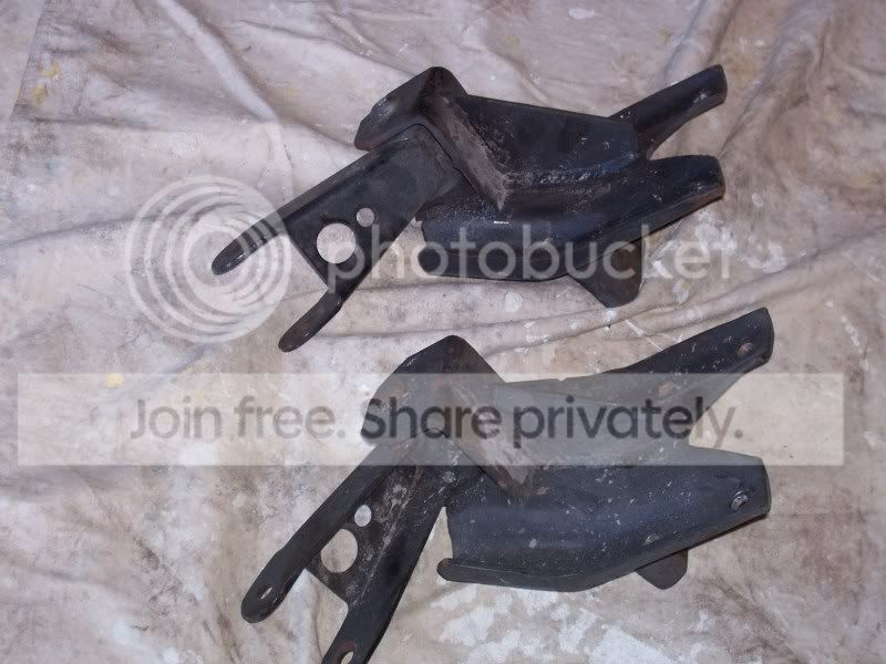

Homemade Shackle Flip Installed. PICs inside.
Umm no, no measurements I didn't think of it. But I got a 4 inch rough country front and the rear end was sagging about an inch with a block. So now it's about 1/2 inch high in the rear its hardly noticable it looks level. I'd say 5 1/2 inches of lift from it
Ya, im gunna copy another one built on here. Im trying to figure out how far under the frame I should go.
Hard to tell from the pics, but is there enough room under the gas tank to run a stringer from flip to flip to make it even more rigid? Just a thought.
I just got excited I was looking at the pictures and I was thinking I could but when I go out there it would be a very tiny support, there isn't much room at all.
Heres some I did
Can we get pics of the shackle from the side? It looks straight up and down from that angle... :dunno::popcorn:
