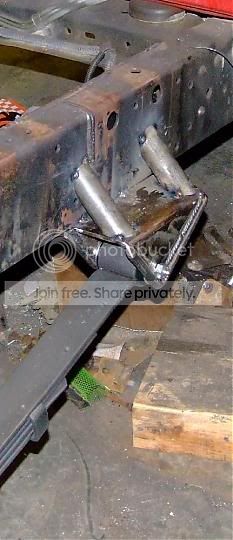

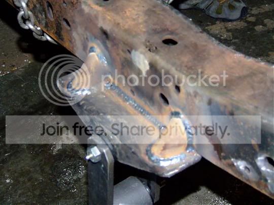

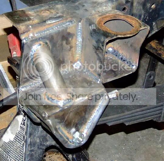

We took 10" out of the frame (sorry no pics of that) and started boxing the rear of the frame Building spring hangers and such
Here are some pics of the front and rear hangers
Front
Rear

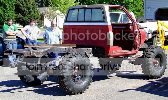

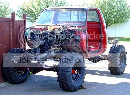

Now back to Horton, so after much time spend welding and grinding and stuff we pushed it out of the garage. It looked like this

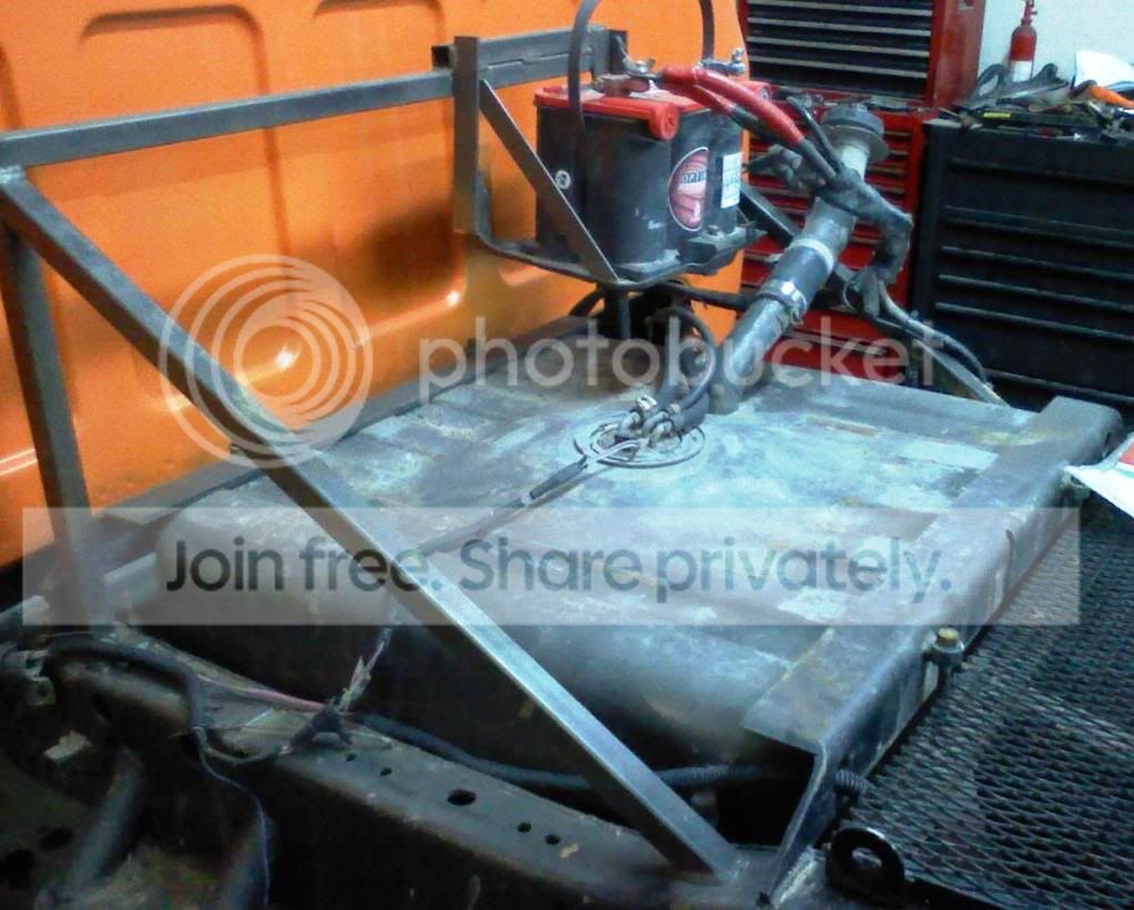

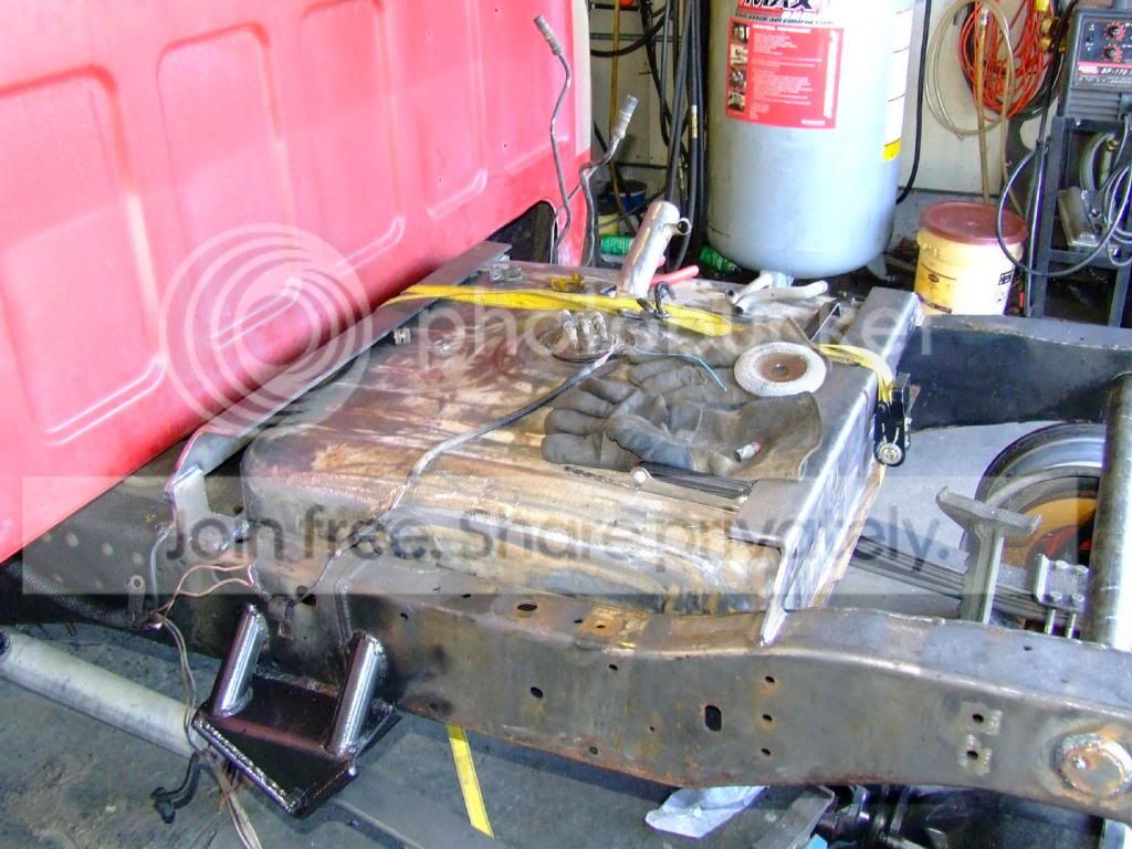

The gas tank was a stock blazer tank. Factory TBI so we found a tbi blazer tank to retain reliability. It as also easier than building a gas tank and cheaper than a fuel cell. The gas tank we mounted right behind the cab
This was done to improve the overall weight distribution and keep the center of gravity very low.
Now bear in mind when we were building this truck it was intended to be driven to the trails.
So Horton (before he was Horton) in the first stage. With no bedsides a full cab and the front end not narrowed yet.
