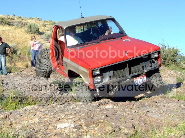

You also narrowed the body right?
Here is a teaser for now:

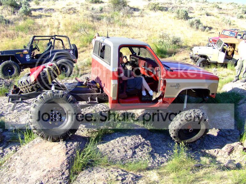

The bedsides were kind of interesting and alot of ideas were kicked around to see what we wanted to do with them.

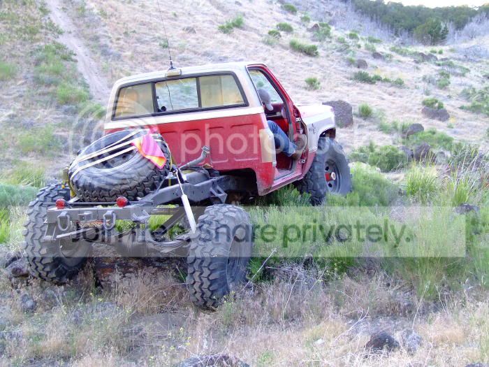

This truck was built to be able to wheel any trail anywhere but still be able to be driven to and from. So some problems existed. Like how do you make the rear of the truck street legal, and still not destroy the bedsides while on the trail. The solution is this
Full width street mode
narrowed trail mode
narrowed trail mode

I will see if I can find some detail shots of the bedsides swinging mechanism, it was actually pretty simple.
The bedsides are skinned. So down to a single wall. When we shortened the bedsides we used some 1/8 to back up all the seams as we figured the bed would probably get beat up some.
We basically built a frame off of the frame, welded some cheapo home depot steel hinges to them, then built a frame off the bedside to meet the hinge.
Presto swinging bedsides. Very simple. There are a few problems with this system though. The main one being the corner of the bedside was stronger than the frame. I caught the bedside on a rock and it actually bent the frame we built to swing it on rather than dent the bedside.
The other real problem was to get it too look right, the bedside when swung in actually stuck out just a little. Which is why the afore mentioned problem happened. We figured out a way around this by using a hinge attached to a cam type system but it never found its way on the truck
If I were to do it again I would use much higher quality hinges and do the cam system so that the front of the bed would actually be inside the outside edged of the cab.

this thing is awsome looking man, i was curious on how many inches did you cut out of your core support to narrow the front.
