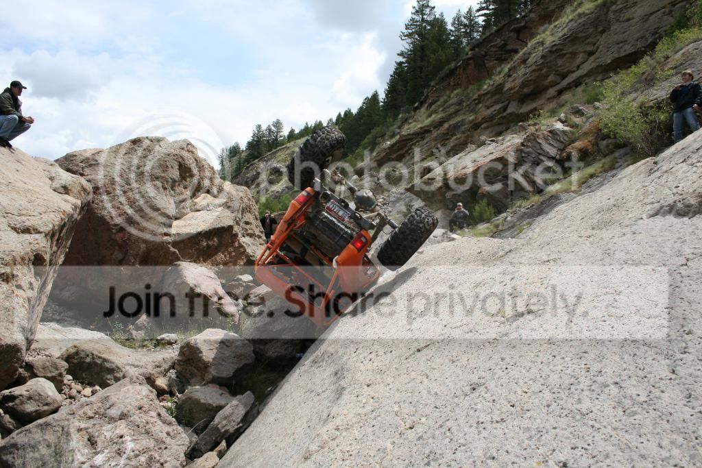

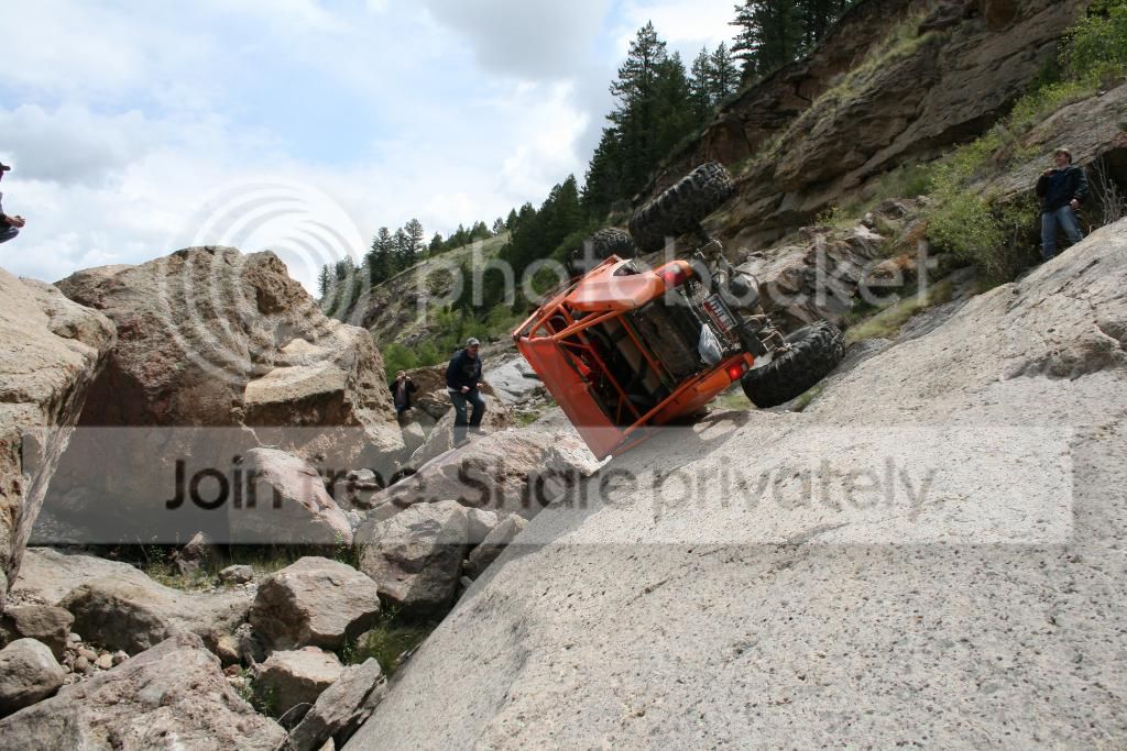

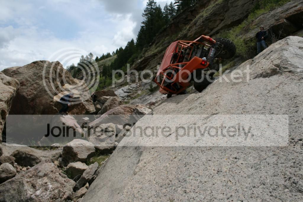

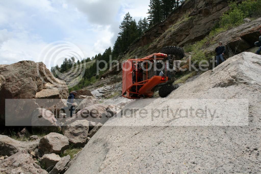

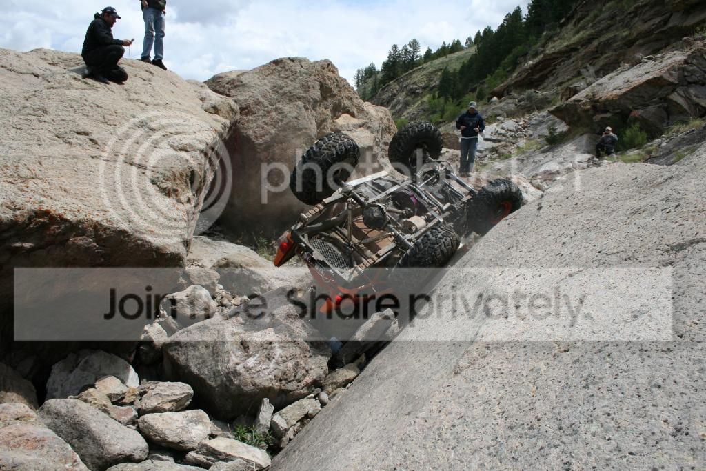

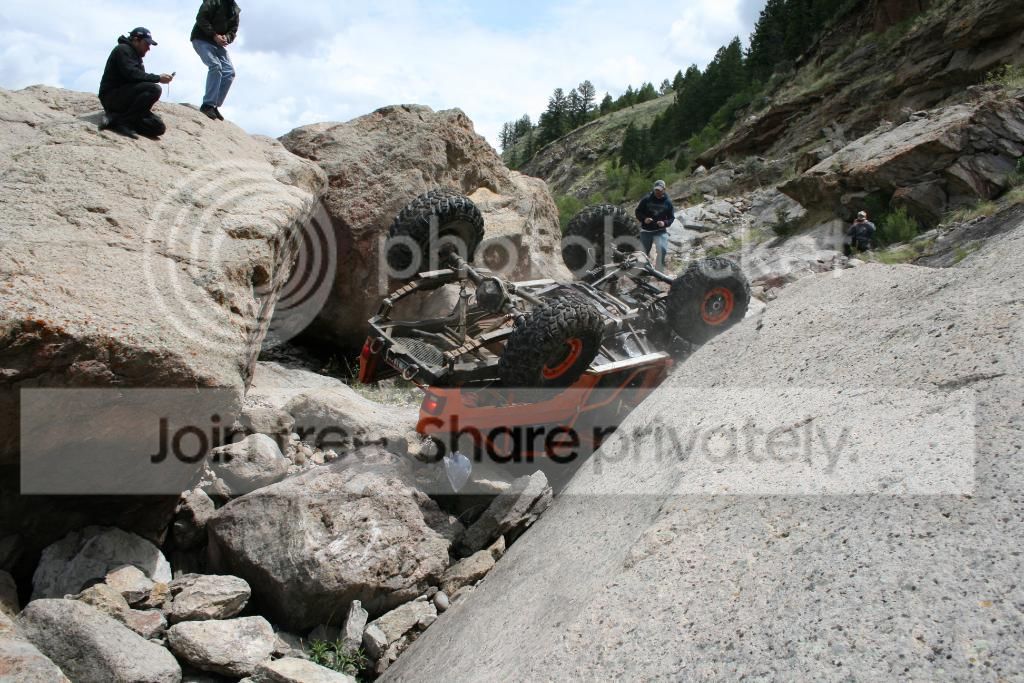

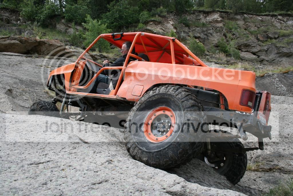

more pics cause I am a pik whore.

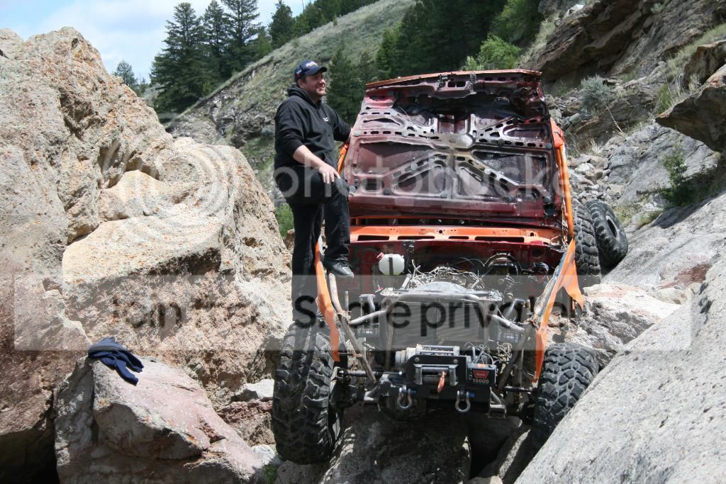

Somebodys got a little captain in him ( my buddy checkin over the engine

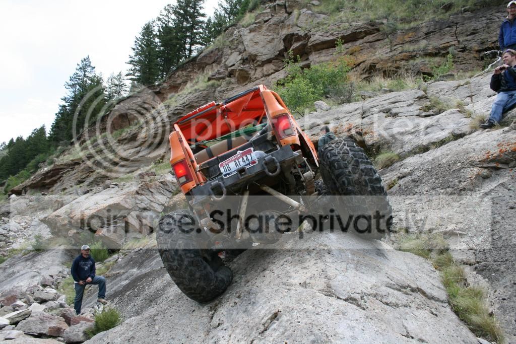

Right before it all went wrong
I have a few that I am going to send in for calender pics.
See if I can make it 3 years in a row!
Yah engine cage saved the radiator the neck is a little crushed but its not leaking. Still its going to need fixed.
I am going to add some to the engine cage too, air cleaner is a little bent up:D
We had to winch it a bit to get the nose to fit in a hole so it would flop over like it did. If that hadn't of worked we had thought about cutting the cage off and trying to get it out between 2 rocks. Not alot of ways out of where I was
Stay tuned for a new cage build, the way my b pillar is bent I can't just replace the bent tubes. Since EVERYTHING hooks into that dang b pillar its going to be new cage time

Eric, I got to say it as I keep thinking it every time I look at these pics of the roll.
I look at that and I saw that roll coming a mile off. Way, way off camber. Infact in the video, I kept watching the truck teetering (I think the suspension was right on the brink of unloading, between up and down) as all your buddies were saying slow, slow.
Then it went over.
IMHO, it was an inevitability of a roll over on that particular line. Just my $00.02

you gotta keep in mind though that obstacle has been made only once, by a blazer on 40's. its a tippy situation but I wouldn't say its a for sure rollover. Eric wasn't quite on the line right and there was NO air in 2 of the tires, just a couple minor adjustments and he could have made it.
That reinforces my theory about tire pressure, and I bet you my K5 that I had would have made it there esasily, because I had a stiff suspension and my suspension never unloaded like this.
I always did hill climbs and side hills never had a problem, I always had at least 20lbs in my tires and stiff springs.
Each type of wheeling needs different specs and this is where this truck just wasn't the right spec.:pimp:
