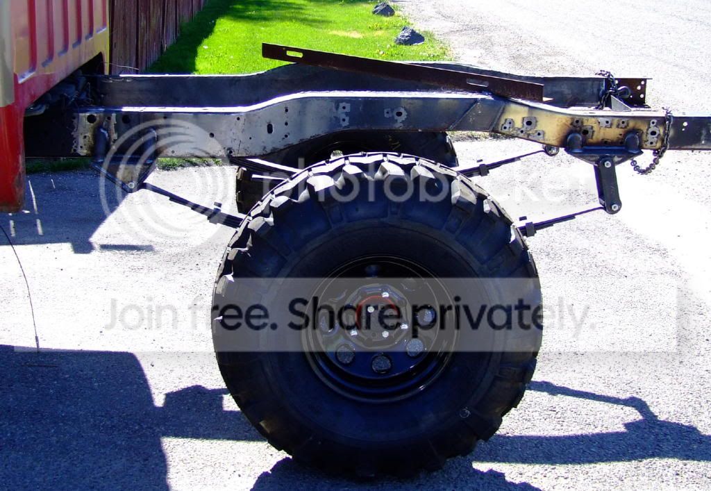

1st the frame. Took 10" out of the middle mounted the 63s and then cut off the excess
This picture shows it best. Wanted a 120" wheelbase out of it. The frame cut is right on the second gusset on the spring hanger. This pic shows all the excess that was left on the back, it all got cut off

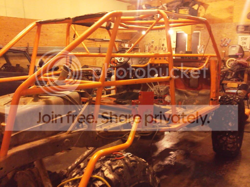

As far as the tank goes, it has never been lower than the bottom of the frame, it actually sat a couple inches above the bottom of the frame, so I never really had issues with it
good pic of where the gas tank was when Horton was first built,
Now the tank sits above the frame but it sits right above the rear axle and I have inboarded shocks. I am going to outboard my shocks and run them straight up and down and lower the tank. This will require cutting the frame a bit but no big deal. And yes all the mounts were fabbed up.
I actually made gas tank straps out of some all thread a nut coupler and some 1/8 1" wide flat bar to mount to this time.
This next time I am not sure what I will do but its definately going to be sunk down into the frame more.
I drove a zuk for years and you learned to use every once of usable space so it drives me nuts there is so much room in this truck that I am not using.
