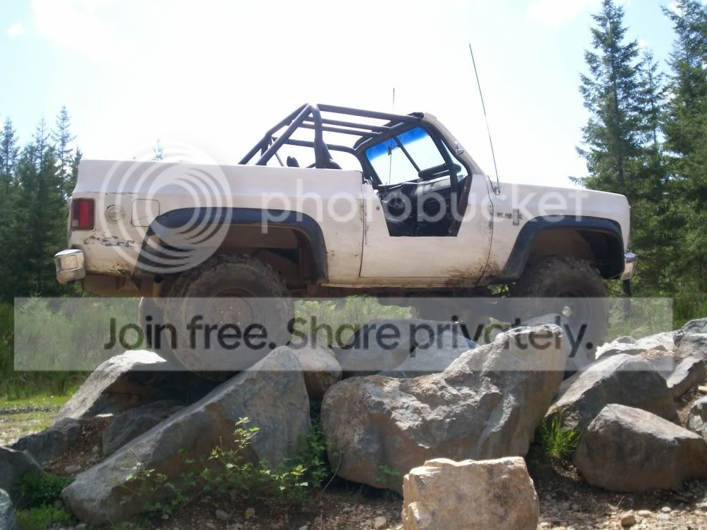

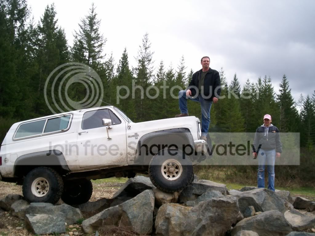

91 k5
91 K5
Front: 4" leaf, zero rate= 5" of lift
Rear, 2.5" shackle flip, 3" lift springs, 5% zero rates= 5" +- of lift.
Wheels are 15x10 Micky Thompsons, or black steelies.
35" BFG Mud terrain's
I had to trim the front edge of front wheel wells to keep from rubbing caused by moving axle forward 1.5".
Top Photo, no trimming, bottom two, trimmed fenders.
Thanks guys, i appreciate the comments. Still not quite level, but am hoping when i install the 14blt that will raise it just enough. Also, the truck does have cross over steering. Best mod i ever did!!
Already did add zero rate. Hoping the larger tube dia on 14bol will bring it up some, or might have to put thick leaf back in the spring pack, or cut the thick leaf for another 1/2" homemade zero rate.
oh hahaha, I didn't even read you mod list :haha:. Yeah the 14bff might bring it up a tad. Maybe longer shackles in the rear?
