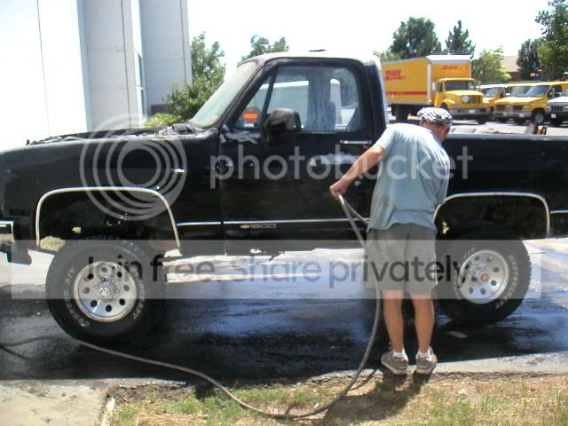

Ok not a Blazer but same deal. 4in Tuff Country lift, 3in body lift on 35in BFG All Terrains. I could go bigger on the tires, but I don't want to have to get bigger axels.
