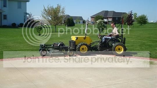

Or Go electric over hydraulic. Hydraulic motors to each wheel turning 37's..... just a sooped up version of this, and this thing will articulate like nothing else.:haha:.
