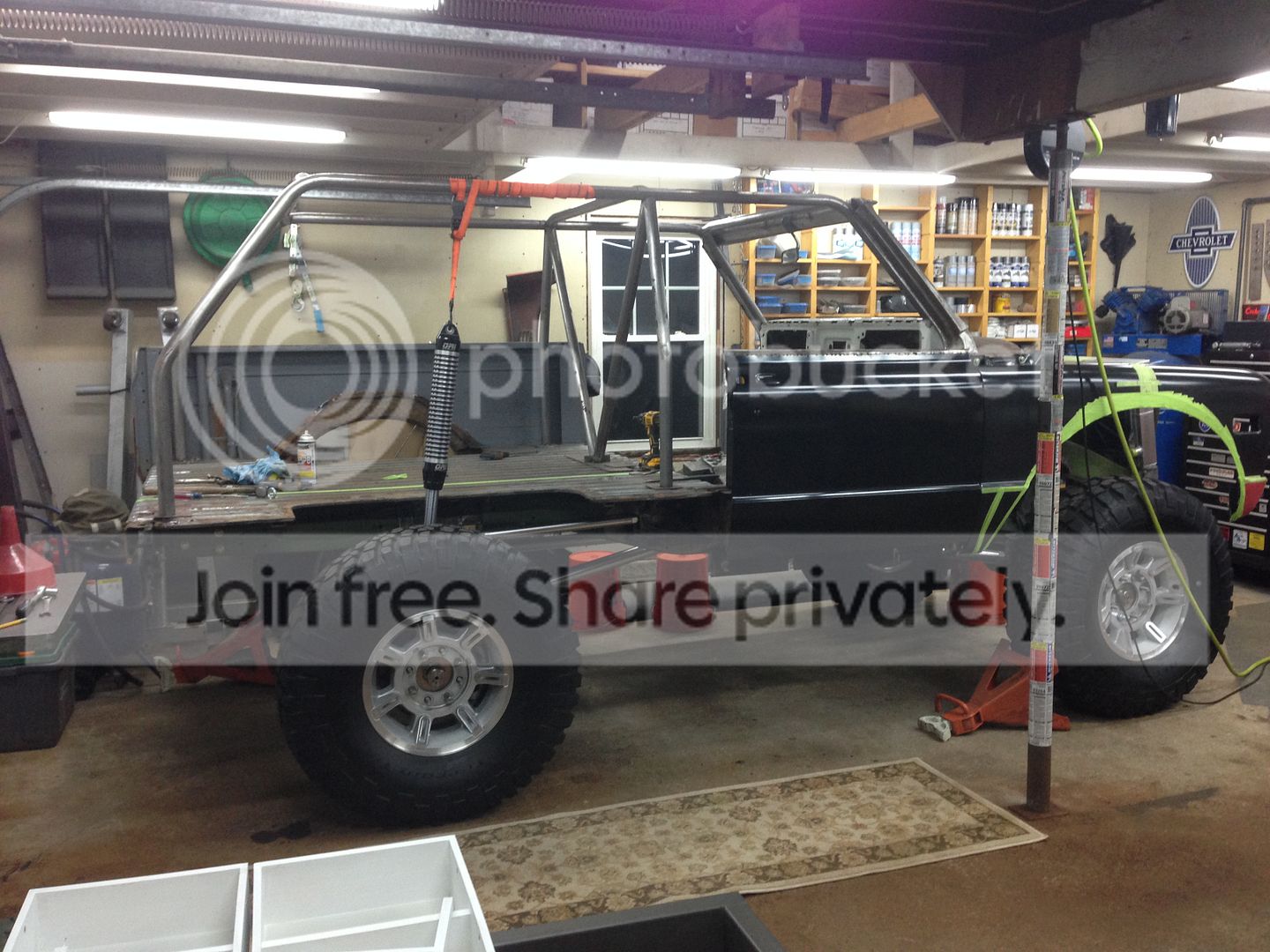

If it were me.....I'd just find the most valuable and rare K5 body style you can and then chop all the parts off it.
Like so:
I'M GOING BUGGY!!!!!!
