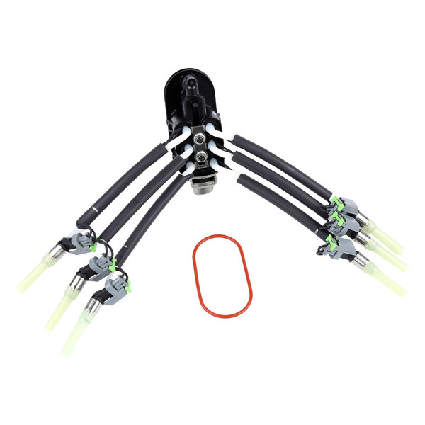

It was around 2003 gm ditched the poppet valve with the central mounted injectors with actual port mounted injectors. To wring out every last drop of power you want to make sure you have the upgraded setup in yours. The poppet valves are prone leaking which will cause performance and misfires in addition to hard starting.
Gm still sells them but you can get a less expensive setup through Dorman.
While you are there, replace the intake gaskets as they are prone to leak coolant out from the passages on the ends of the heads. Fel Pro are my go to for them.
Appreciate the advice, I planned on resealing and inspecting most of the engine and Trans, now my question is can you is the new style injectors and fuel rail on the 2000 or would I need to source a newer intake?
Total bolt in. No change to the intake at all.
There is a true separate injector/fuel rail type setup for the 4.3 that came on the Marine version, but it would be multiple changes at once to deal with. This setup plugs right in and the fuel lines go right back where they are supposed to.
