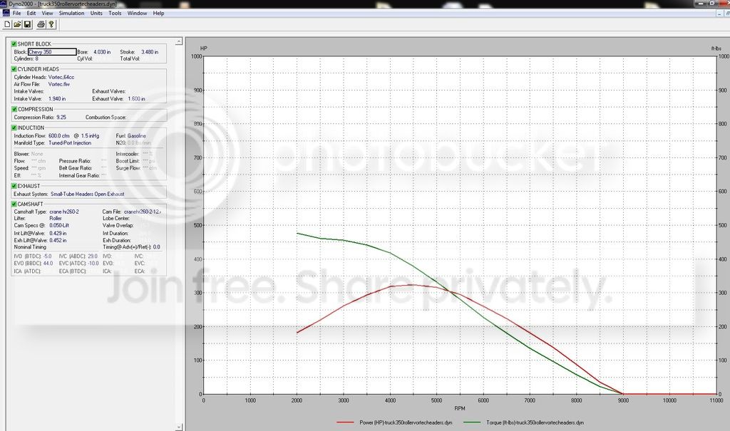

Before anyone feels the need to disparage the desktop dyno simulators, I fully realize their accuracy is questionable when the input data is not good. As a general comparison tool however, they have value. This is how my present setup comes out:
With my sub-optimal gearing (3.42's) and 33" tires, I need as much low end grunt as I can get. Whether or not the above numbers are accurate, from actually driving it, I can attest to the curves being accurate in how it pulls and when it starts to run out of steam. I doubt I can do a whole lot better on the low end without increasing displacement. Another reason I don't think a crate engine will work, this one performs as I need it to. Since I *should* be able to re-use the cam, replicating the current motor should be easy. Just improve a bit with better lifters, new heads, one piece rear main, probably try a BBC oil pump to see if it helps at real low engine RPM's under load.
