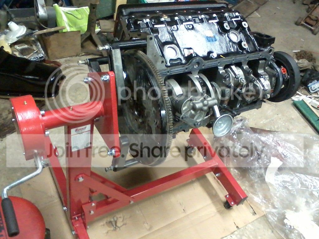

Made an oil pump pickup install tool out of 1" id tube of some sort I had lying around, got pickup started via eyeball, tested fit, perfect. How often does that happen? :) Tried heating pump body up to about 150-200*, and freezing the pickup, didn't seem to affect the interference fit between the two, still required quite a bit of effort and certainly couldn't be installed by hand. Makes checking pan to pickup fit really easy if you cut a large hole in the side of the pan. I figured now is the time to weld in the oil temperature sender/sensor bung. Have to bolt the pan to the spare block (don't want to ruin the pan gasket with heat) and will weld it up. May force me to buy a ~$200 engine stand from summit, which is hand cranked.
Since I have a few engines laying around, I *had* to get one of these:
Other than metric fasteners (18/19MM wrenches or sockets needed, along with metric allen wrenches!!) and having to use a carbide burr on one of the bolt holes to get it to fit...oh, and the fact that Jeg's was $50 cheaper immediately after I bought it from Summit. :(, I'm quite satisfied. I'm sure it could be improved, but metal wheels with brakes, and the crank make easy work of things. Didn't try, but it probably turns the engine over with one finger on the crank, and it holds wherever you stop the crank. Rolls on the floor really nice, which is welcome. Better have some 3/8" threaded rod handy...even the longest starter bolts I had aren't long enough to reach the block.
Not bad for $220. They sell the same thing with a different brand name, for ~$300. Looking at the Harbor Freight and cheaper non-crank stands, with the prevalence of plastic wheels and less-stable designs with a lower weight rating, was worth it to go with this, for me. I'd highly recommend this if you have the money and need an engine stand of some sort anyway, unless you can afford one of the uber-premium ones.

I got the 2-ton engine stand from Harbor Freight, and it is OK, but the thing I do not like about it is the legs are "V" shaped just like an engine hoist legs are. The legs of an engine hoist interfere with the legs of the engine stand when I am trying to switch an engine from the stand to the hoist or visa versa. Nice stand though...I like yours better than mine.
