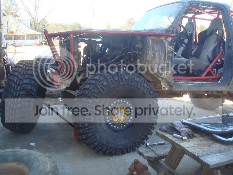

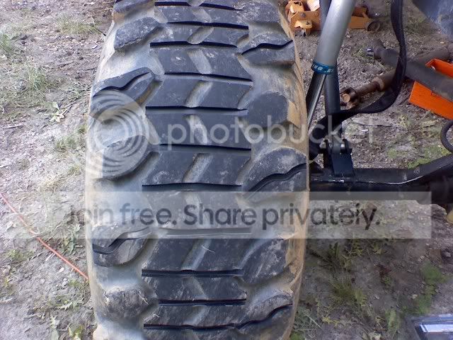

what front springs are you using?
thanks for the comments man.the front is just some lift springs right now with some 6 inch shackles.it does ok for now but ill prolly swap in some 52s or 56s this summer.the air shacks have been great so far.i only score like a 700 on a 30 degree ramp but off road it does great.bump.

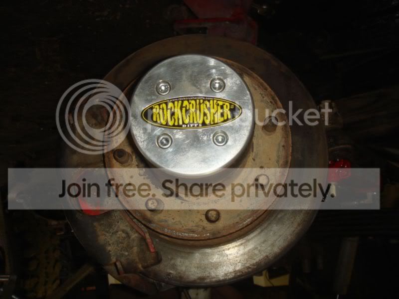

Just found this thread doing a search on crossmembers (in the middle of flatbelly install among other projects). Looking thru this thread I saw the bead lock ring on a 6 lug wheel and thought "ahh hells nahh"..............couldn't believe it was true and found that you installed a D60.
Care to comment on the air shocks now that you've run em? Looks like the front end could work some more (not knocking at all, just an observation).

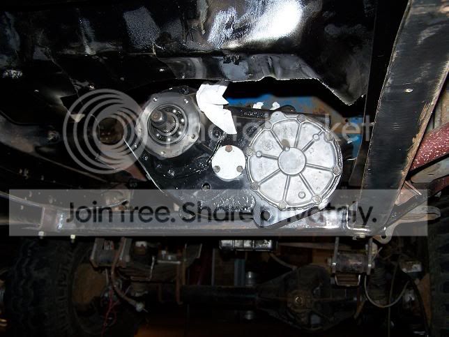

Aren't the round pattern 205's the same 6 bolt pattern as 300's. I am pretty sure you can use a 300 clocking ring, not that it matters now since you already drilled the casenot to many updates.this will go in sometime in the near future.32 spline round partern 205 with the 32 spline out puts.shift rails are ground and ill be in the process of doing a diy twin stick using stock 205 shifters.the face is redrilled and tapped because there is no clocking ring for a round 205.had to redrill to stay flat belly

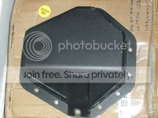

also picked this up for it.all this stuff is super hard to find and can def. get pricey
Who put a Ford tailhousing on a Chevy case?????Aren't the round pattern 205's the same 6 bolt pattern as 300's. I am pretty sure you can use a 300 clocking ring, not that it matters now since you already drilled the case
Must have been real expensive if all you could afford was that cheesie ass chrome paint.Who put a Ford tailhousing on a Chevy case?????
