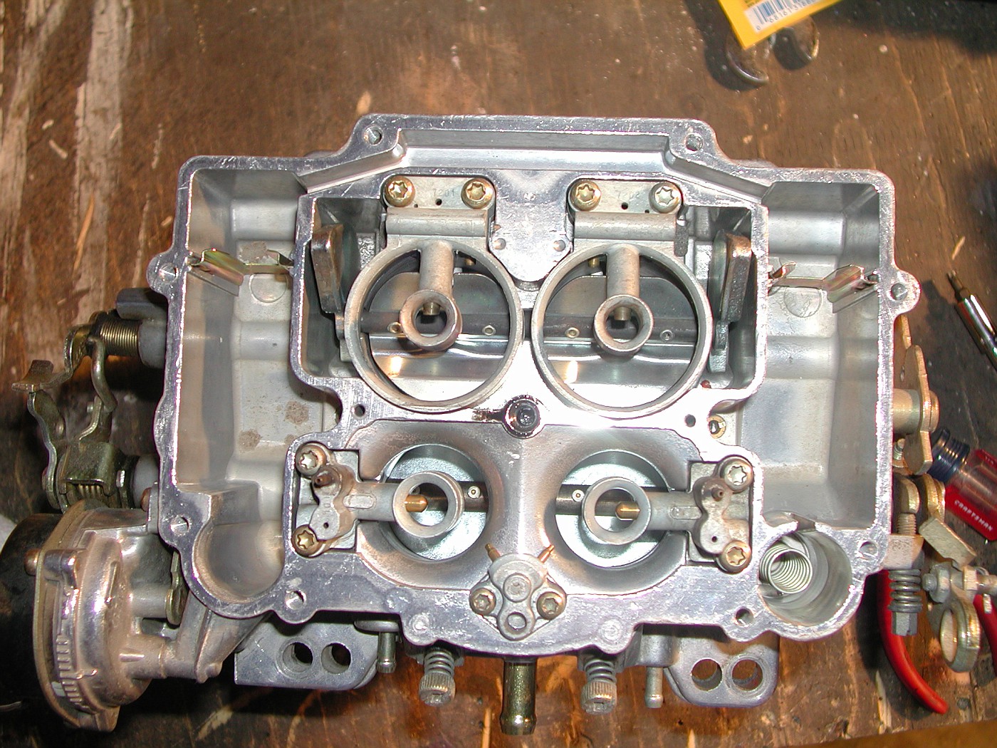

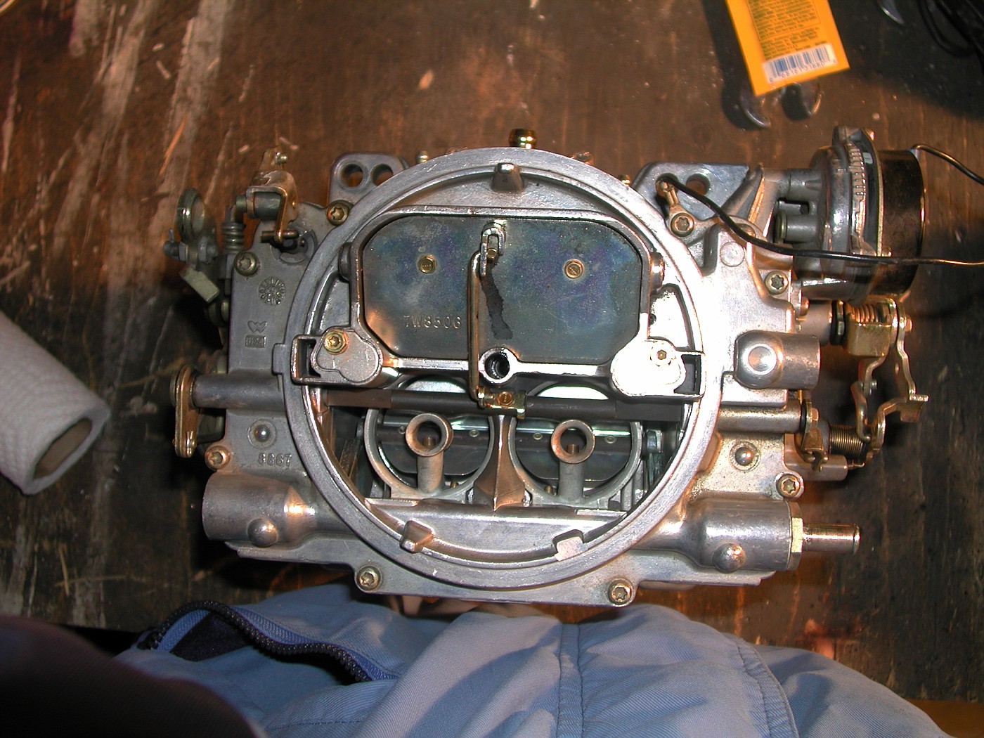

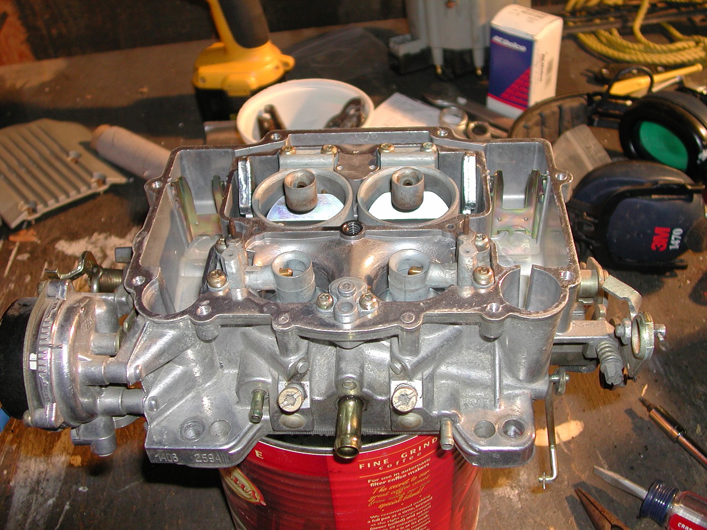

I tore the carb apart to get the jet #'s(hard to see BTW) and the step-up spring is the natural steel color no hint of the stock set-up yellow.

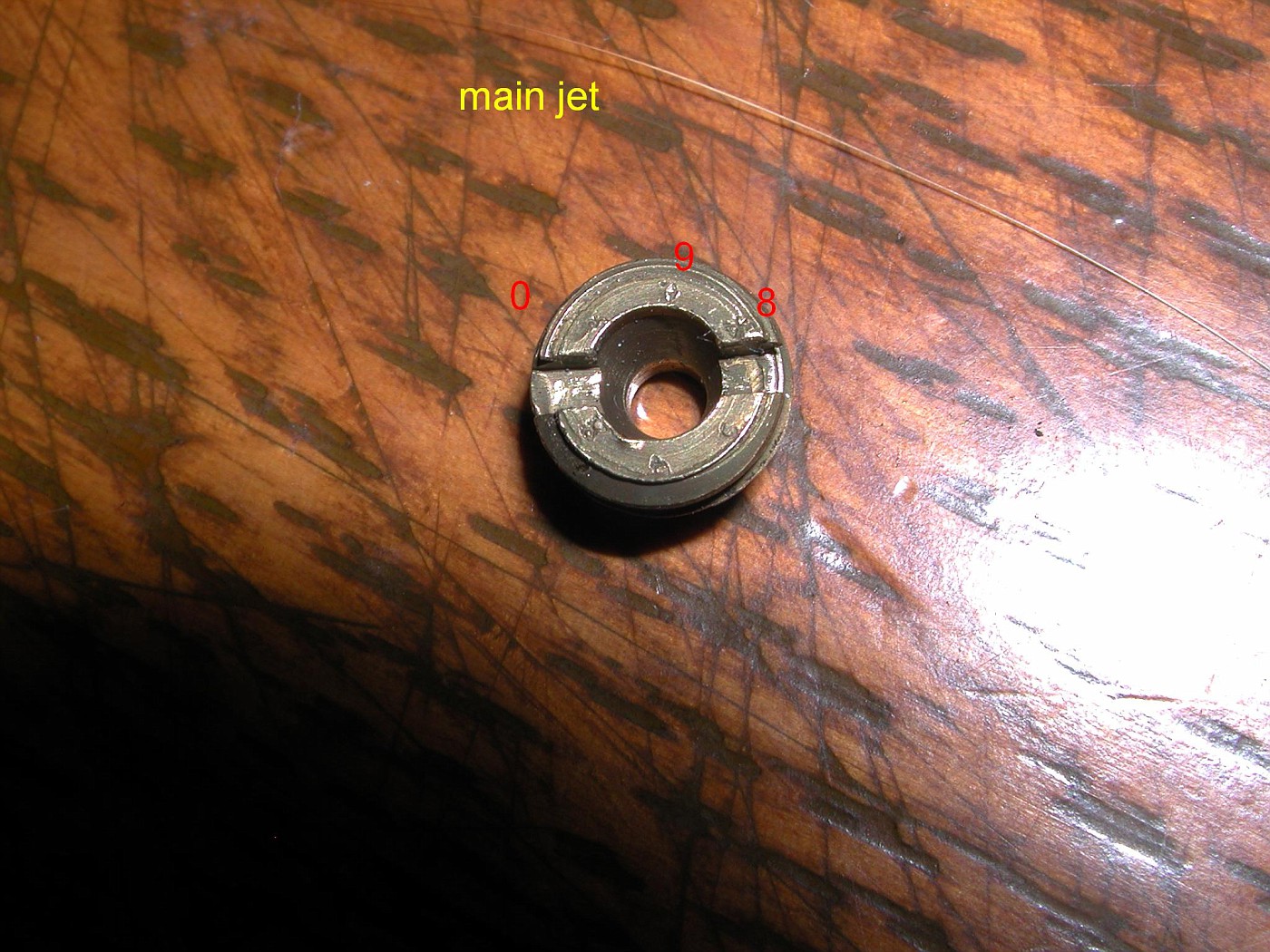

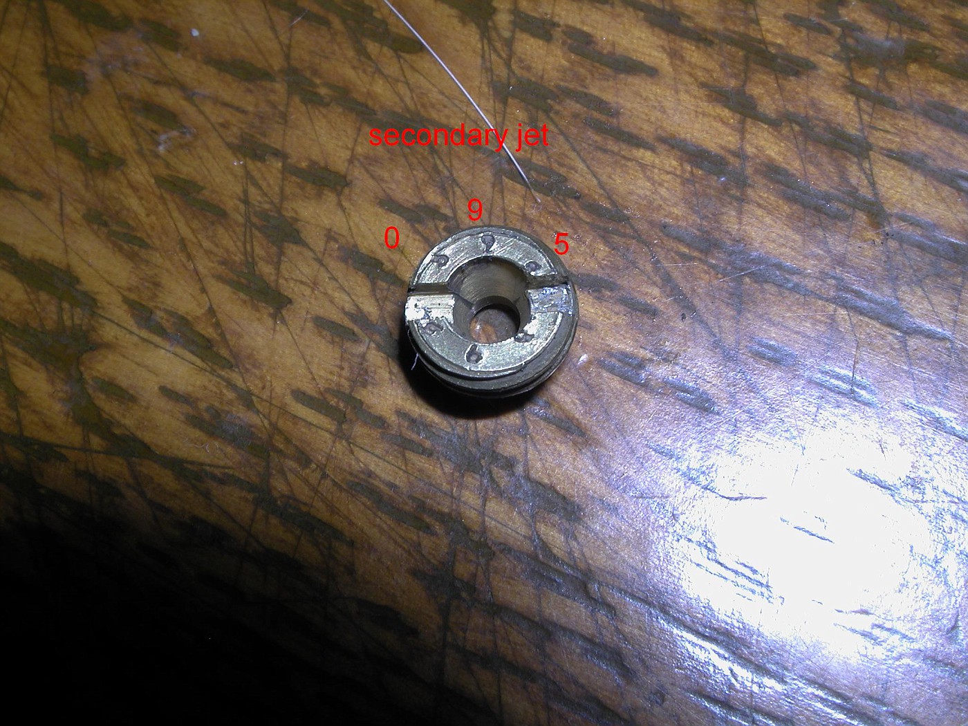

The main and secondaries jets were the stock .098(main) and .095(secondary)

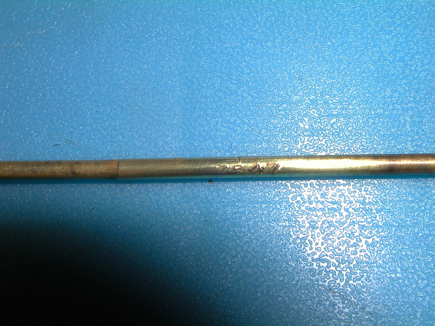

Metering rod was also stock with a # 7547 stamped on it.
Here are a couple pic's.
Pretty clean unit.
Here's the metering rod.
Main jet,really hard to read the numbers.I used a magnafying glass to decode the numbers.
Secondary jet.
