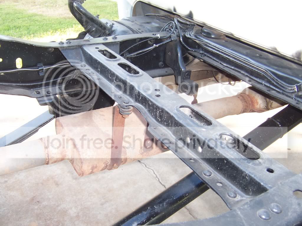

yeah that looks a little dangerous. We need a vendor to supply a brace to stop that from happening.:haha:
It's not just the rear crossmember you have to worry about, cracks near the steering box are also quite common. Here's a bad one:

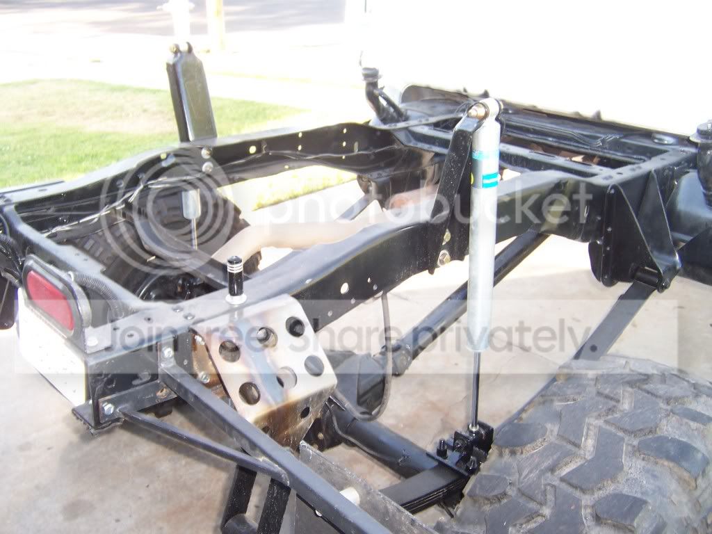

Avery I am very curious to know how you feel about your rear shock placment.
You may or may or may not have seen my crew cab build in my blog on here. But with only 4 foot of bed and a fuel tank in the frame rails I dont think I have any other choice but to put the shocks where you have yours. It will be a while before mine is even drivable so give it some time and let me know how you are liking them there.
I may do ford towers same as you or I might just build shock hoops I havent gotten that far yet. I still am unsure of exactly how I will end up doing my bed, but fairly sure it wont be tube.
I'll let you know what I think after we get everything finished and I get some time behind the wheel. This saturday we have a little day run up to the mountains so I'll see how it does.

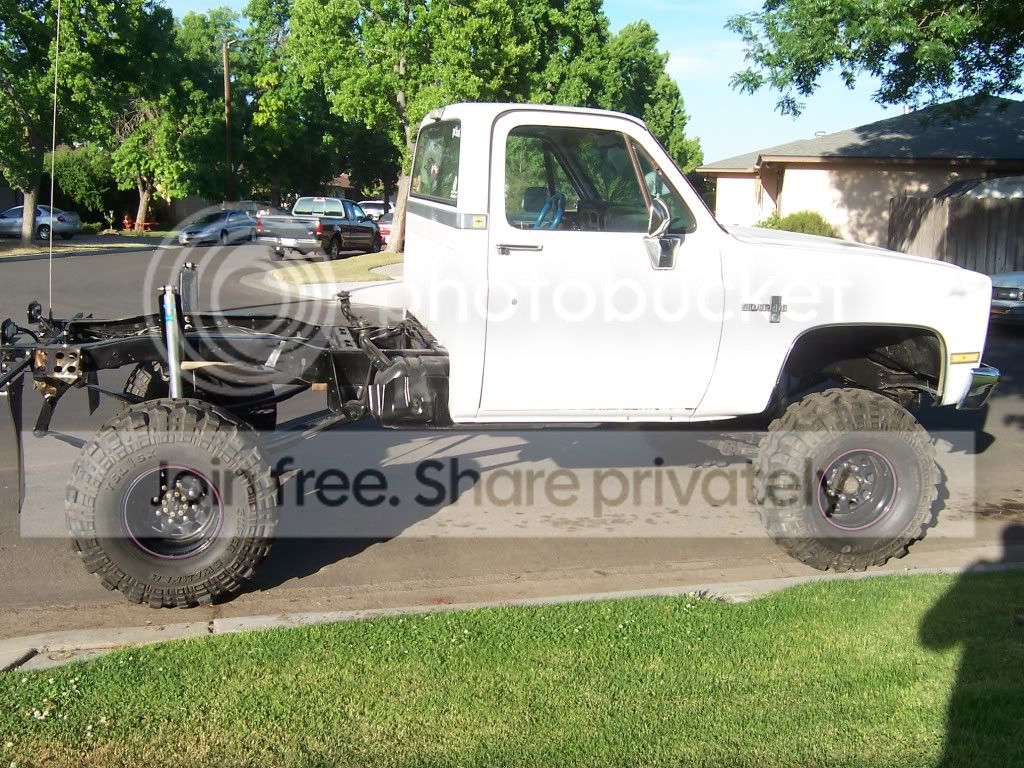

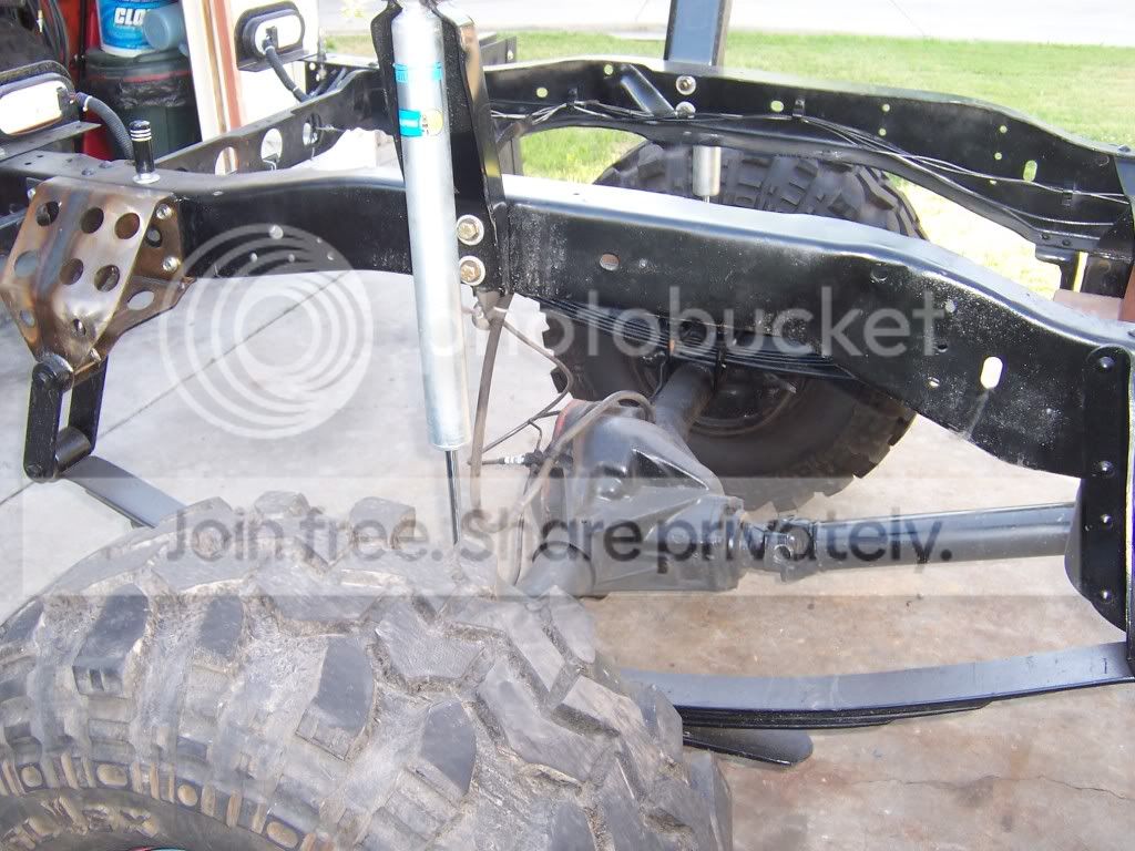

For the sake of an update here's some pics and a crappy video from tonight after work...

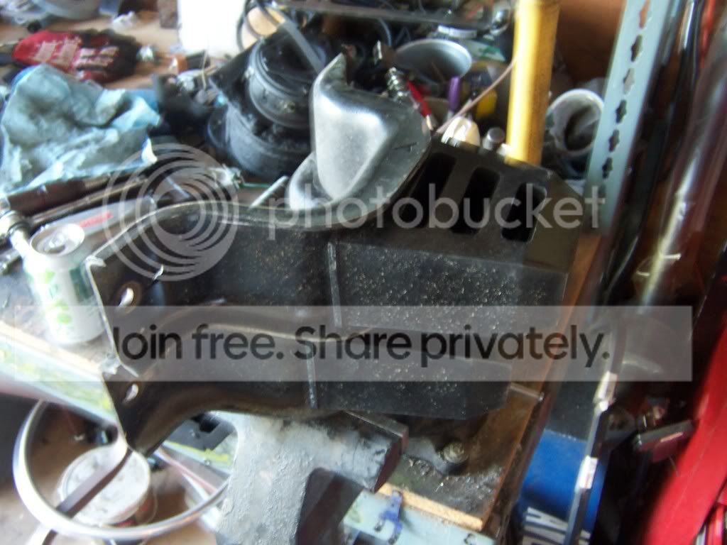

I ground the rivets out on the bump stop brackets since I need to relocate them back on the frame to line up with the rear end...
